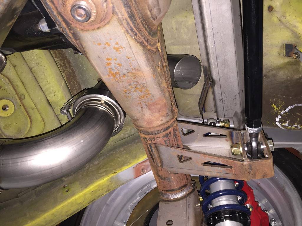

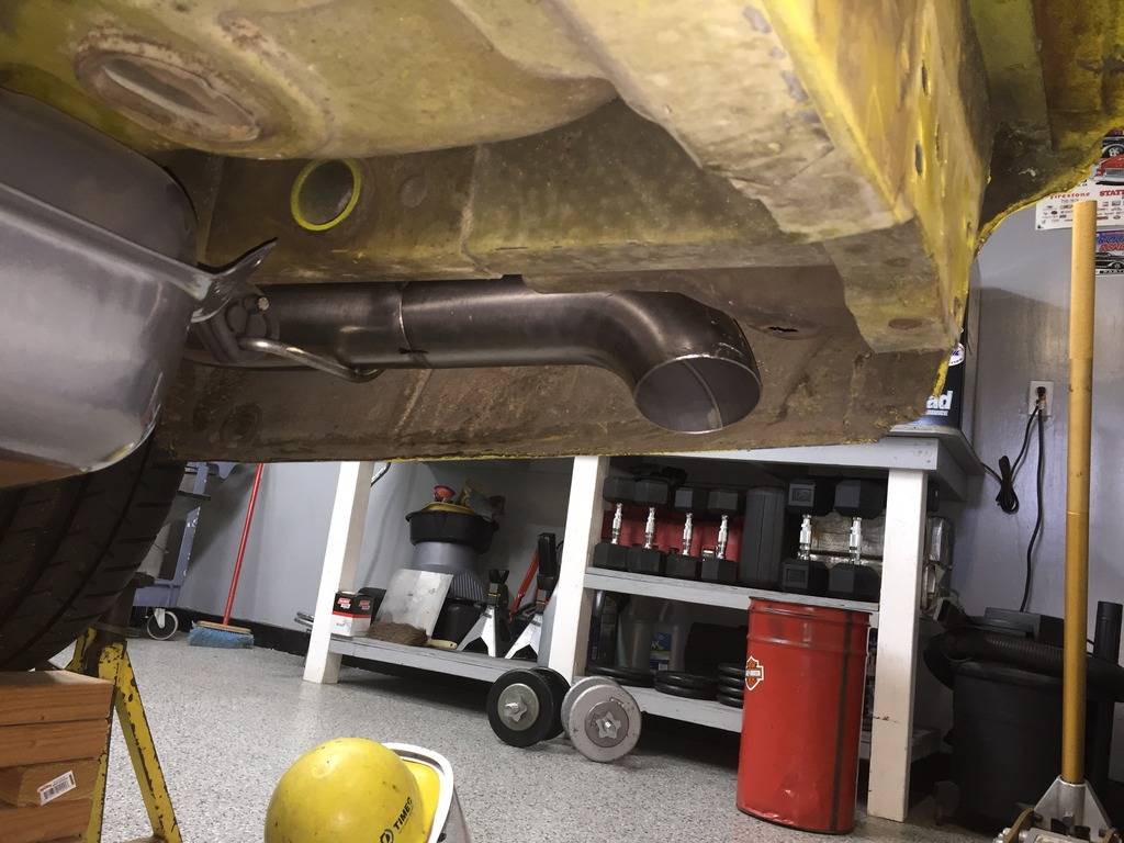

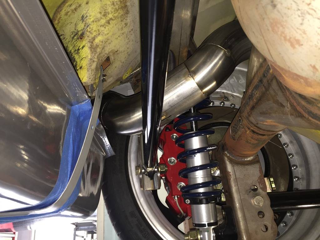

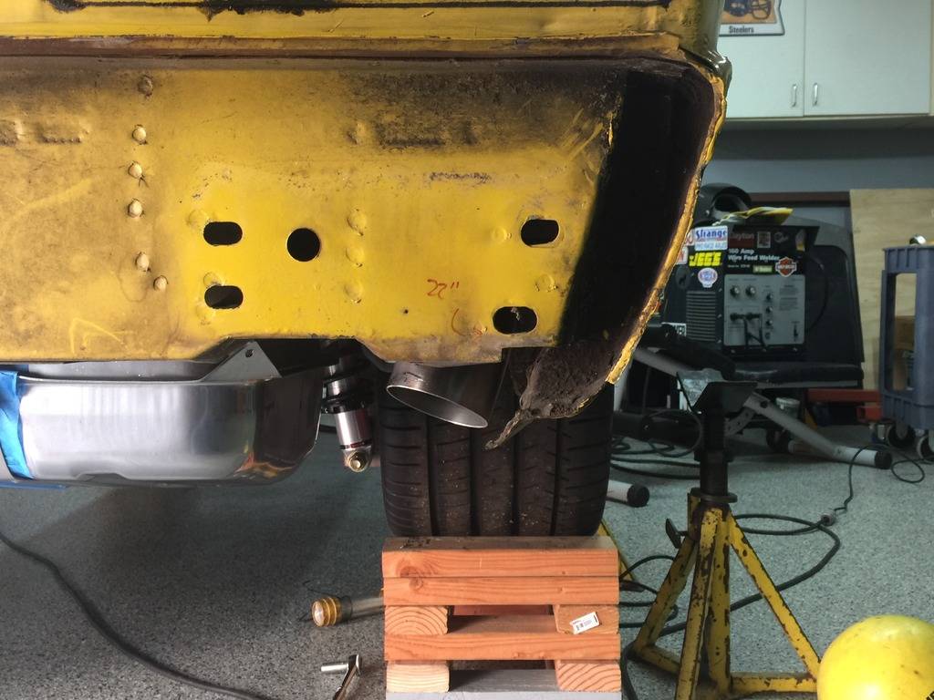

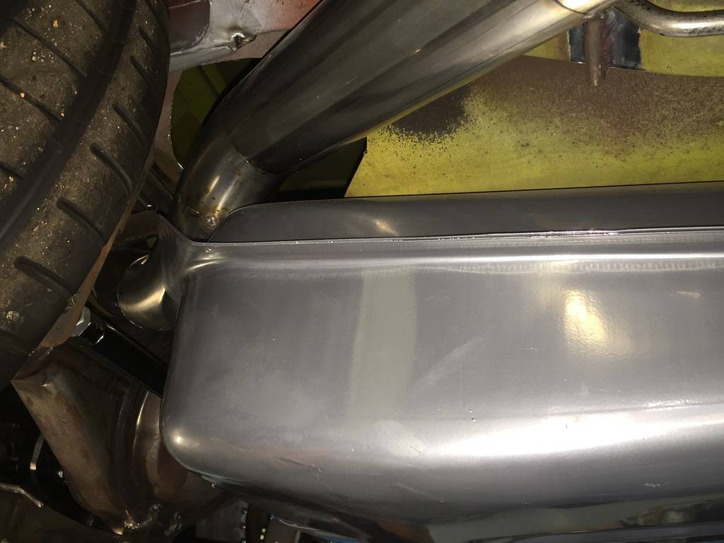

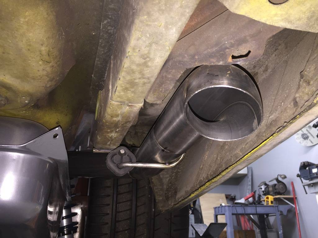

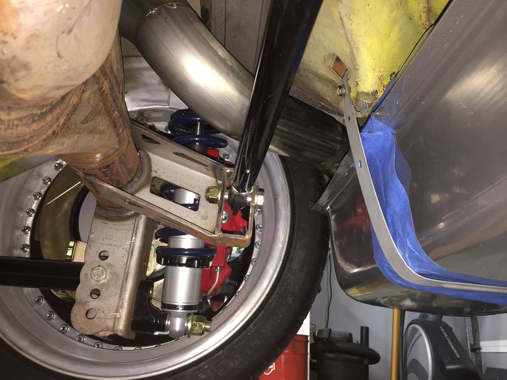

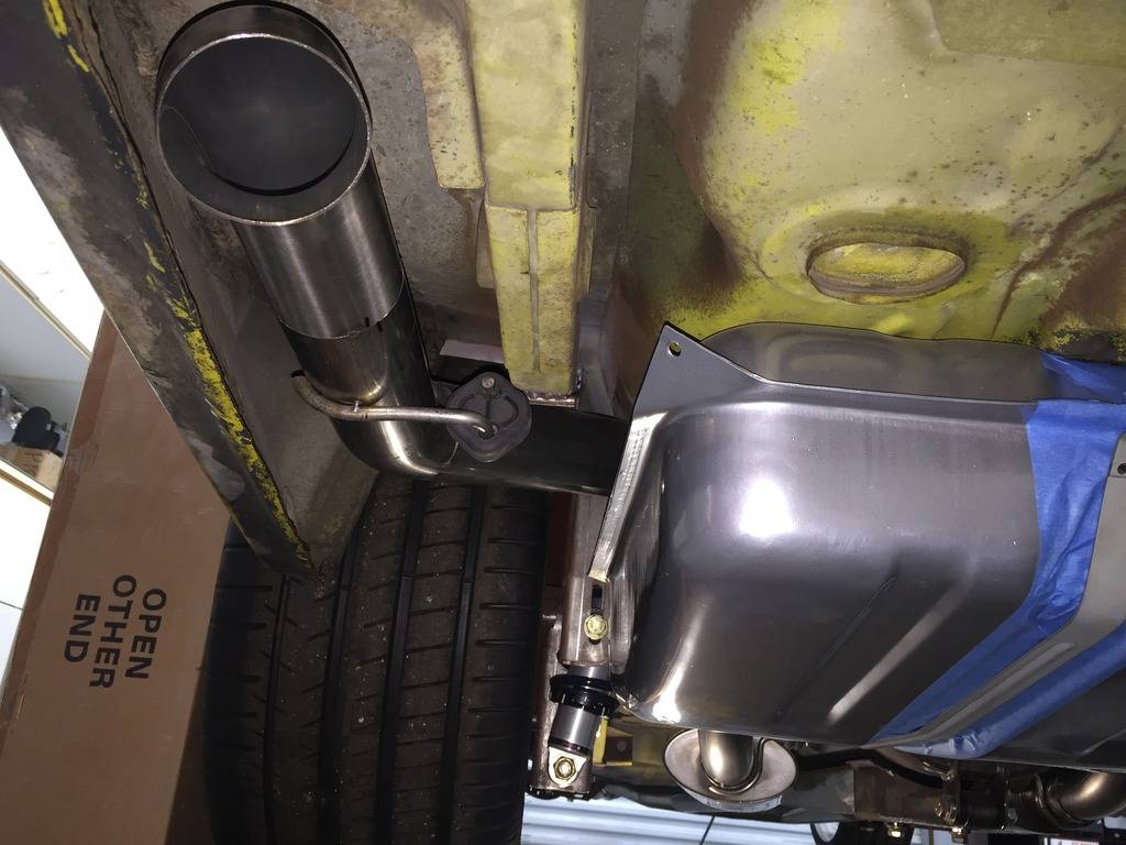

      Well didn't finish what I had planned for this break, but did make some progress. Finished up the passenger side exhaust over the rear end and to the back just before the rear bumper. I'm pleased on how it came out, hanger installed and plenty of room for movement under there. It's a slow process, but I'm seeing the finishing product down the road.

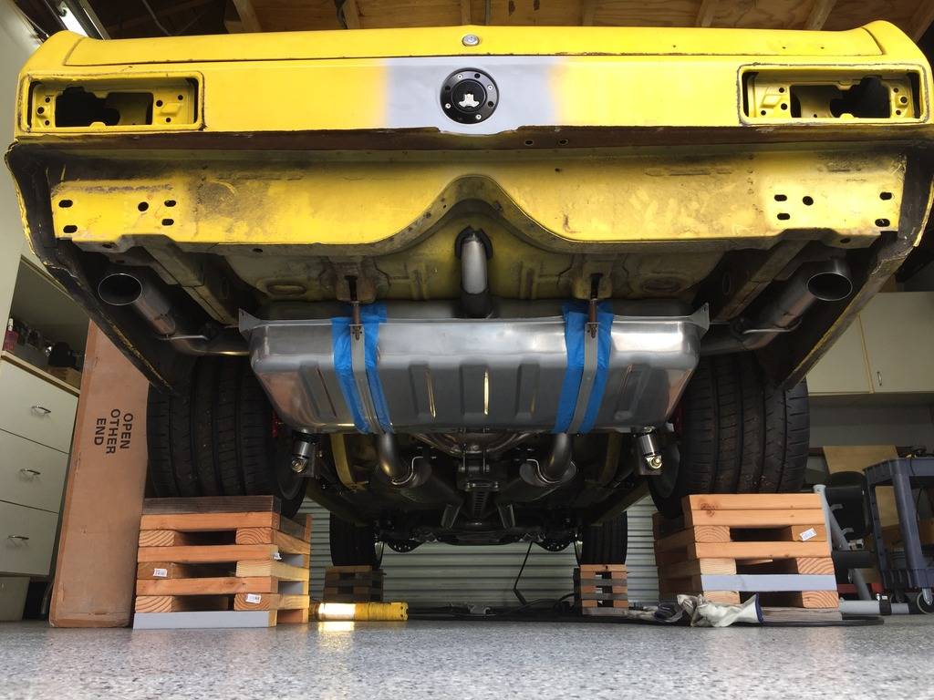

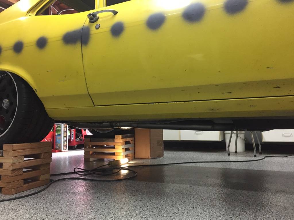

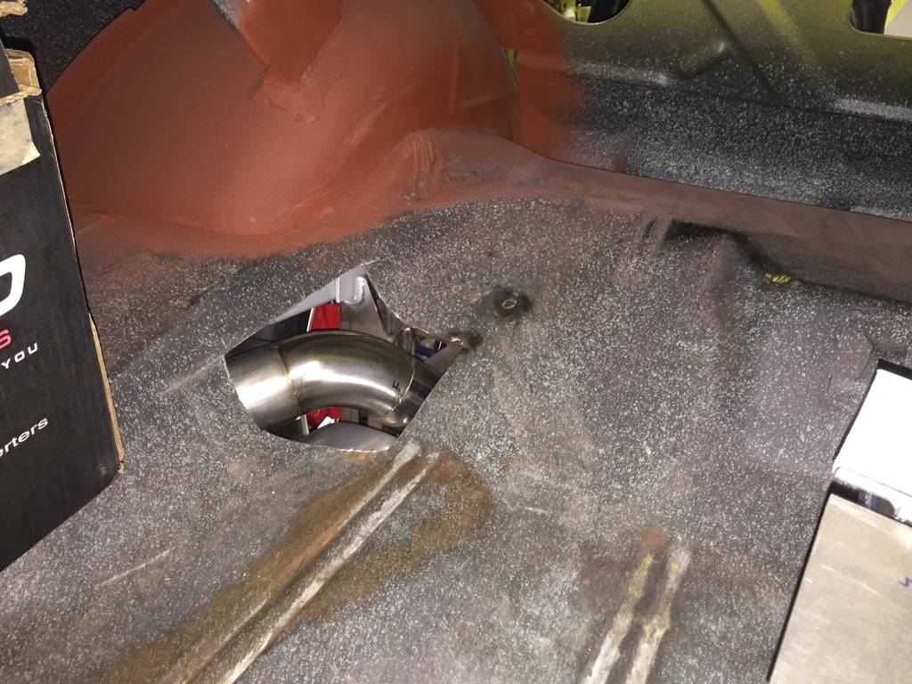

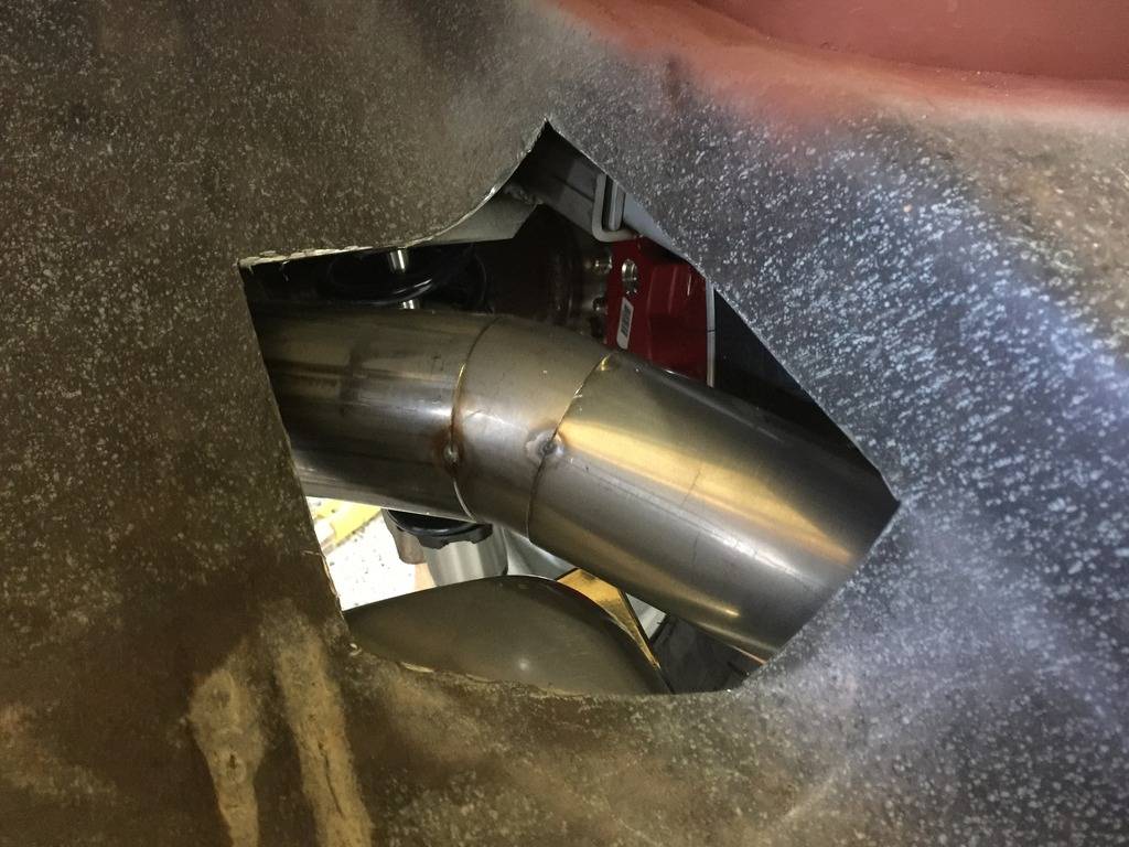

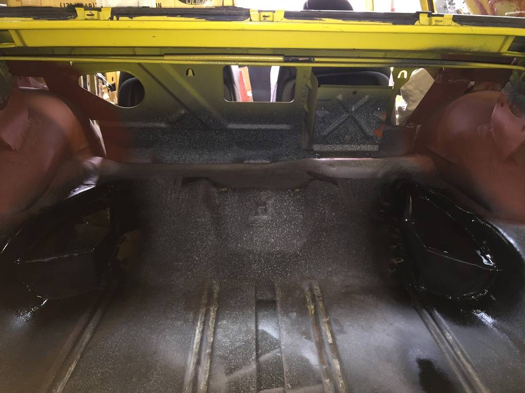

      FINALLY!!!!! I'm quite relieved that I'm done with the exhaust, well.... as far as its all tacked up and in its final place. Have a another header tube that's needs repositioning other than that final welding will be done when car is stripped down ready for body & paint. Some patching needs to addressed now in the trunk area Moving on to the front of the Nova I'm planning on fitting front sheetmetal, inner fender wells and adjust front ride height roughly to see if any modifications need to be addressed to fenders / inner fender wells. Until next time with more progress & photos.

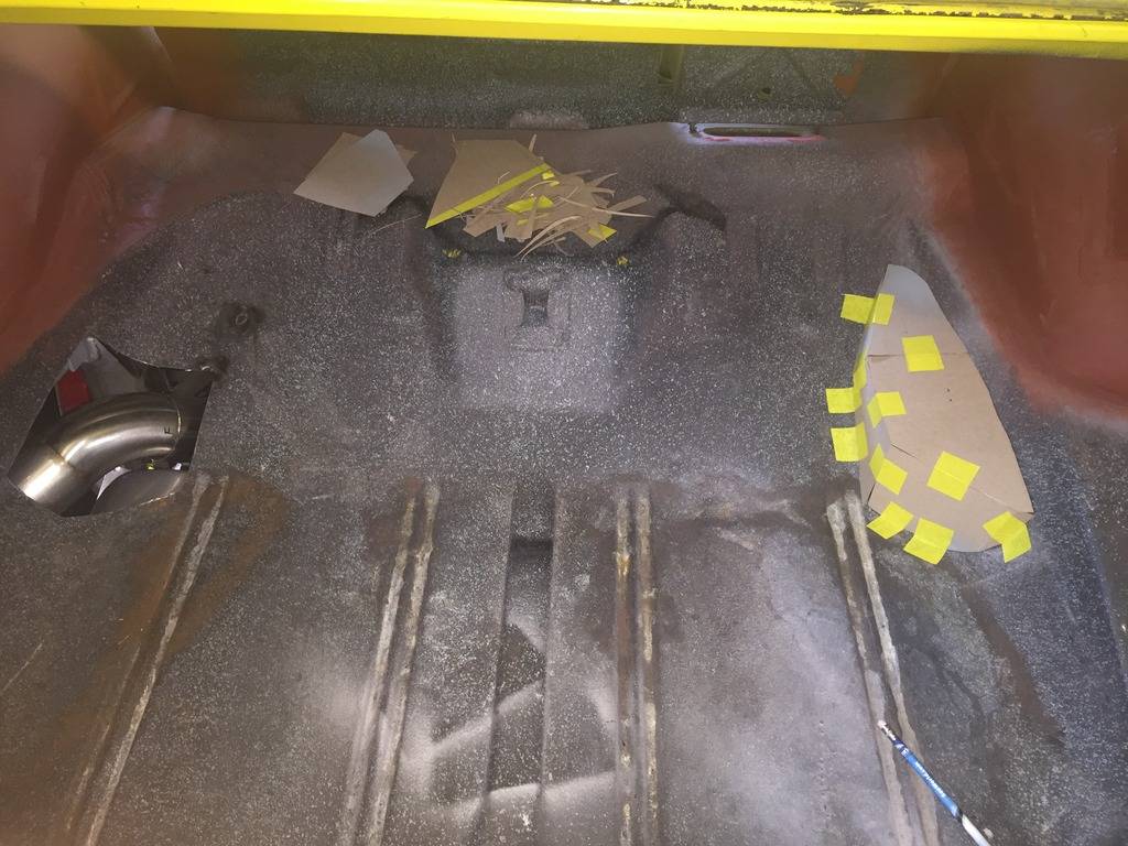

      Made a little progress this last couple of weeks. Fitted up front fenders, radiator core support, adjusted ride height some more to find out that drivers side fender rubs on the lip. Now the passenger side same height doesn't rub, hmmm. I looked into the drivers side a little closer and notice it has been repaired and not a very good job at that. So needing to replace fender with a new one and check again so I can move on to inner fenders fitment. More on that later, the patches in trunk from the exhaust cut outs I made are covered now. Slow progress but things are getting done

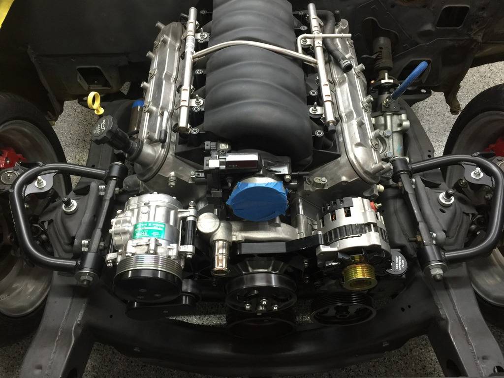

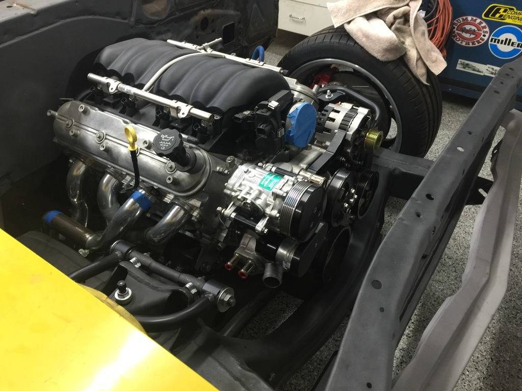

      While I'm waiting for my new front driver side fender, I've decided to start on some other tasks. I started with the front engine accessories which I had purchased a ( VintageAir LS Front Runner ) system from a forum member here. I must say I like this system cause of it being very compact. Will have about 6 1/2 in. of room in front of it for radiator/ electric fans, so I'll be looking around for something that will work. Also ordered some Sparco sliding seat tracks so I can start fabricating for the GTO's seats to be mounted. This will keep me busy for now lol.

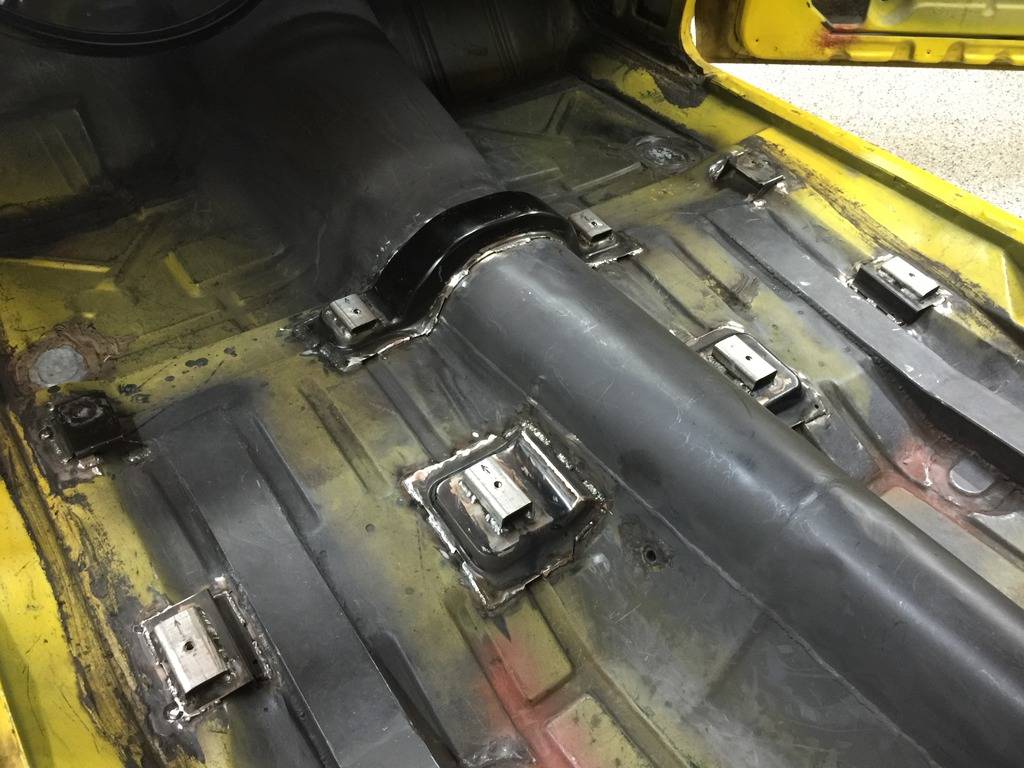

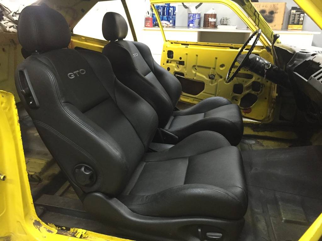

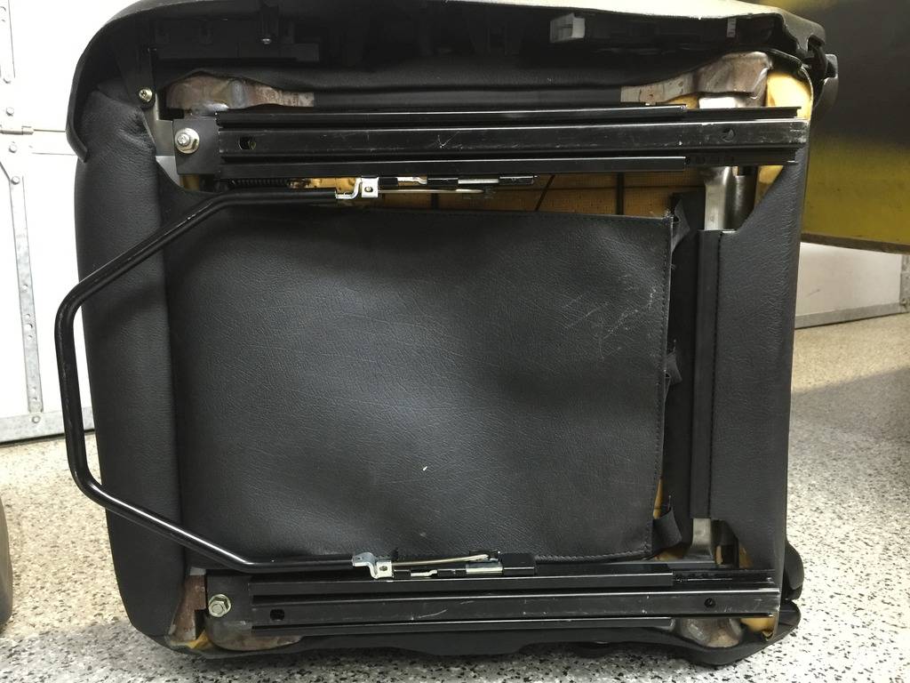

      Still waiting for my front fender and was told that ETA would be around the end of July. So I went onto the seats and began with making some brackets for the Sparco sliders to be mounted to the bottom of the seats. I had purchased some stock bucket seat brackets that were for an original bucket seat car. Had to modify them to work with my raised tunnel and then weld them down to the floor. Mounted the seats and must say I like the look very comfortable too. lol Next will be figuring out how to make the back seats work. Be back soon ✌

      Nice! They look right at home! In the shop here we have had real good success with PRC fan and shroud combinations. If you're after something used, in browsing the web I've heard people say that Ford Taurus dual fans work great, not sure how that would fit the Nova.

      Great progress! Judging from the pic it looks like youll have plenty of headroom with those seats and custom mounts.

      Thanks Centerforce, making as much progress as I can. By removing the electric tracks from the seats I was able to mount the seats as low as I could. The only thing electrical that I kept is the part that adjusts the reclining of the seats. With a helmet on I still lots of room to the headliner, though it helps that I'm not a very tall man lol

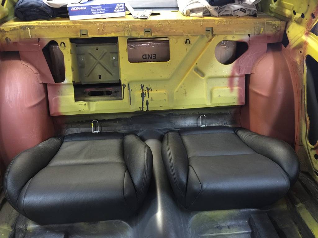

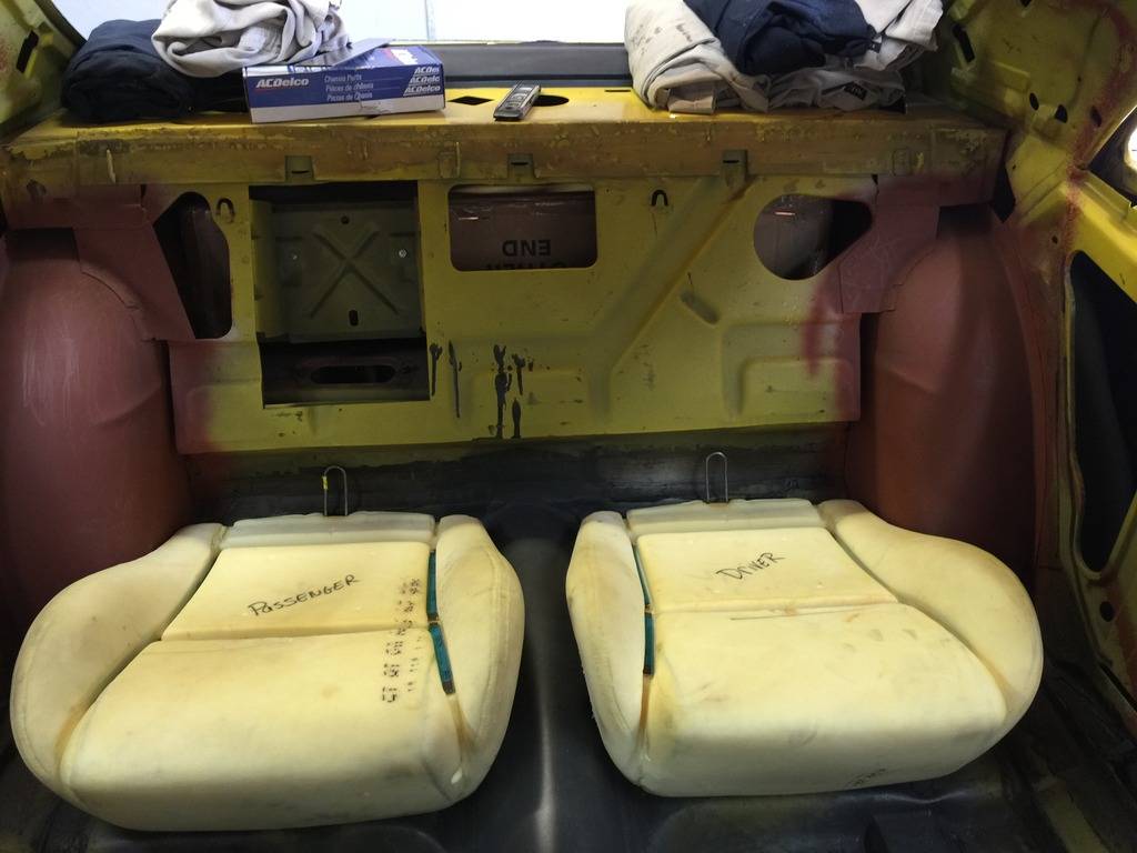

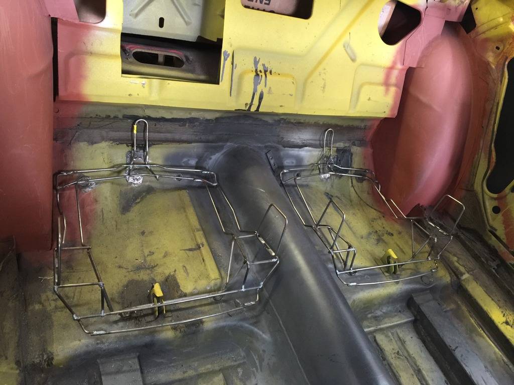

      Today I finished up fitting the bottom portion of the back seats. They had to be placed a little towards the center cause of the mini tubs, but other wise look ok. Looks like I'll need to remove the back seat bracing, firewall etc to move it back about several inches to accommodate the top portion of the back seat. Will see how things go.
