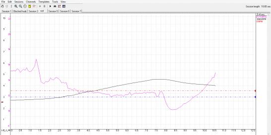

      I got the Innovate Lm2 installed on my car and cannot leave it alone. It is a great tool once you figure out how to use it. I went from a performer rpm dual plane to a torker 2 single plane intake, looking for better fuel distribution and maybe shifting the torque up in the rpm band. I have a 1 inch open spacer and a 600dp. So I am re tuning everything. I had violent lean backfire when the secondaries open. So I went back to basics. I disconnected the secondaries and tie wrapped them shut to dial in the primary side first. My lean backfire is only when the secondaries open.
      On the primaries only, it pulls cleanly all the way up. I spun 3rd on the freeway,never did that before yikes! My car has never ran this good. I can't believe it is only on the primary side. The log is a partial 4th gear wot pull.
      My final primary side tune:
      28 squirter with pink cam no. 1 position
      .026 ifr/ .0625 iab, idle screws,1.5 turns out, 12.5 inch vac at 800 rpms
      68 jet
      .020 hsab
      .070 pvcr
      10.5 standard pv
      my timing is at 15 deg locked out on 91 pump
      Autolite 24's gapped .028
      My current afr readings
      Idle: 14-15 A very clean, crisp idle
      Crusie: 13.5-14.5 Part throttle cruise gives the best fuel mileage and best driving characteristics.
      Wot: 11.5-12.3 When I hit it, the afr's drop to a safe range to prevent detonation and gives peak power for a turbo car.
      Red dotted marker line is: 12.3 afr shows the leanest
      Blue dotted marker line is: 11.5 afr shows my richest
      Datalogging: Hit record and it saves this info to an sd card. After the run, I load onto my laptop for review.
      Purple line: airfuel ratio verticle axis
      Black line : rpm verticle axis
      Bottom numbers are time in seconds for the datalog session. Wot starts at 2-3 seconds. Horizontal axis.
      For wide open throttle, the goal is a nice flat afr reading . If it is anything other than flat, some tuning is needed. Could be bigger jets are needed, or the fuel pump can't keep up etc. This allows me to get the tune in a safe range. For max power, data logging combined with quarter mile runs is the best way. Paying attention to the highest mph and reading the plugs after chopping the throttle from a run will tell you what the engine really wants.
      Name:  Lm2 Wot primary tune.jpg
      My next step is to connect the secondaries. I think the lean backfire is related to the secondary accelerator pump. It is a #28 squirter which may not give enough fuel during the transition of the secondaries opening. I will drill to #31 and see if it is any better.
