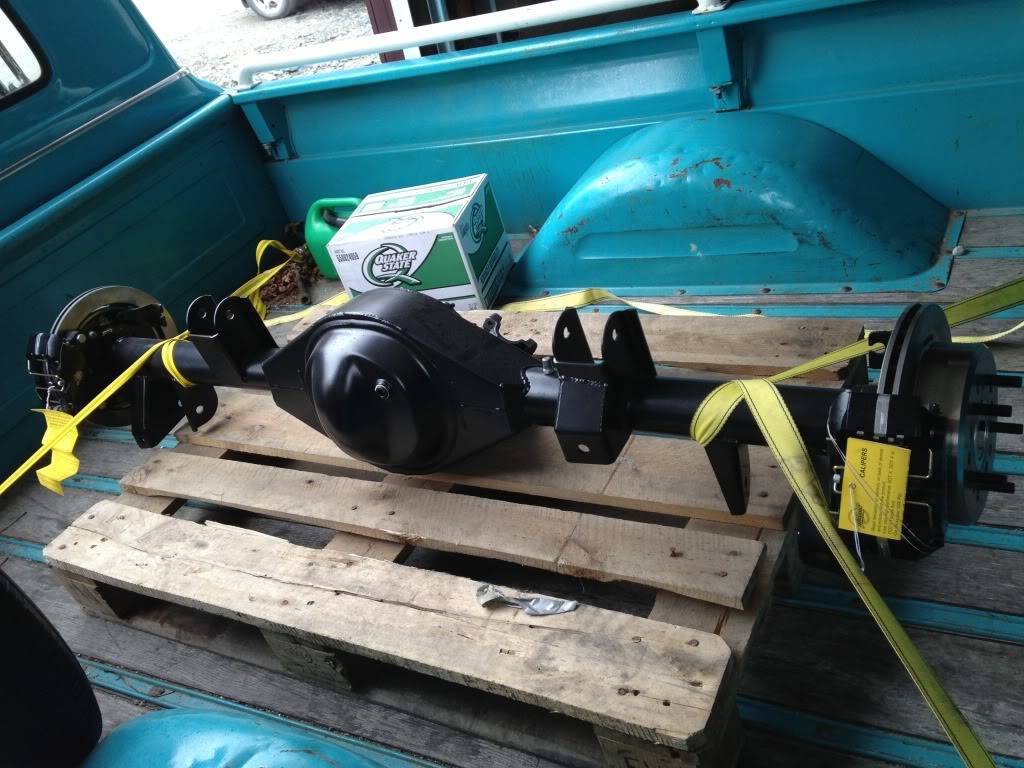

      Strange 9" rear end.

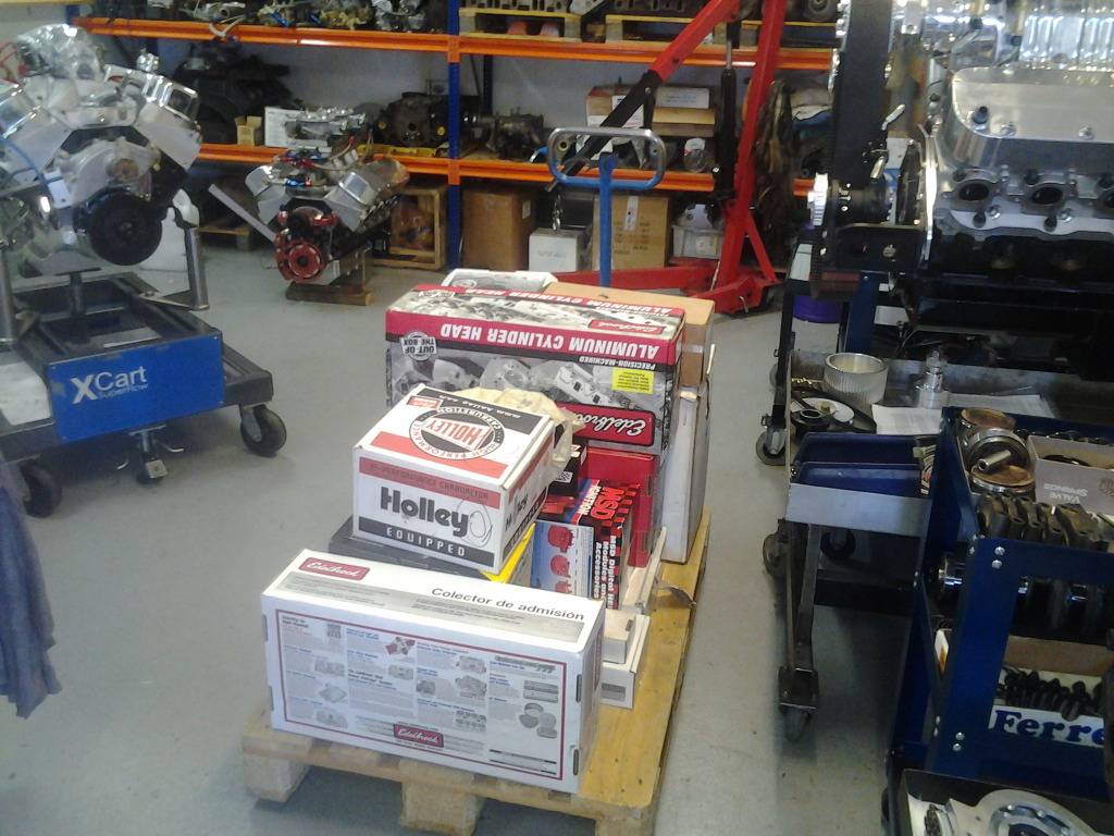

      Scat forged stroker kit
      Edelbrock topend kit (aluminum heads and intake)
      Holley 870 Street avenger carb

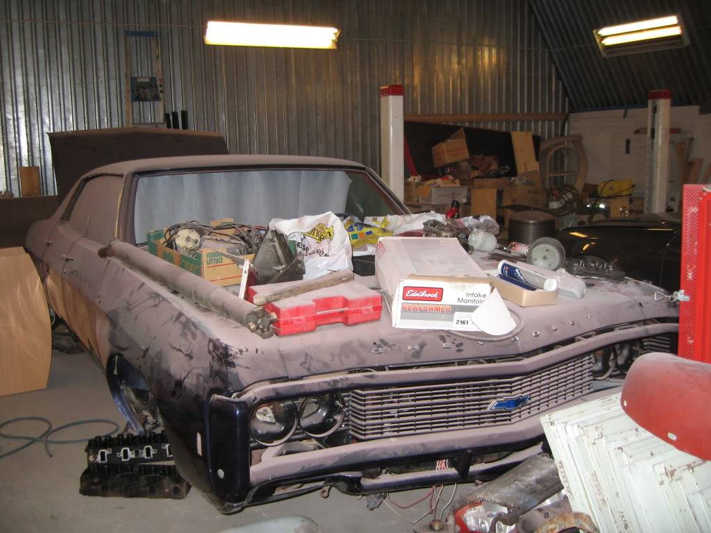

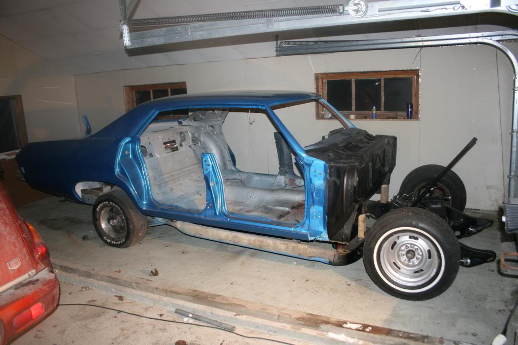

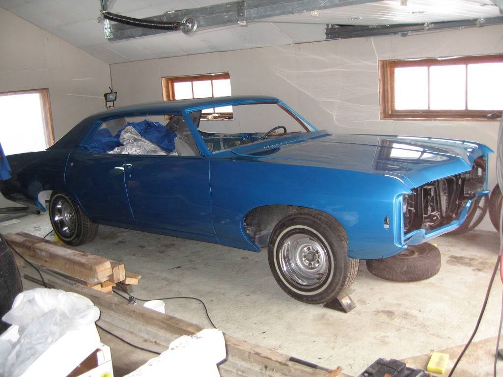

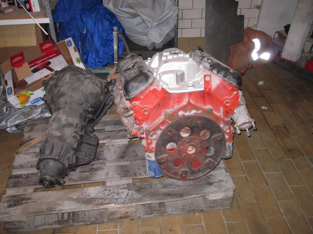

      How I saw it the first time. I had never seen this car before since grandpa sold it way before I entered this world. Buy or not to buy, that was the question. Of course I had to buy it!

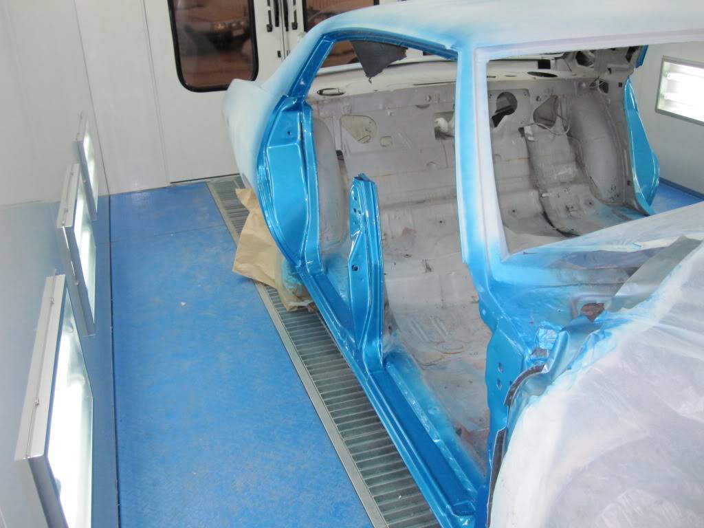

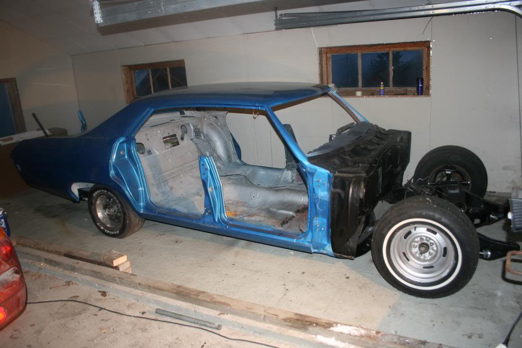

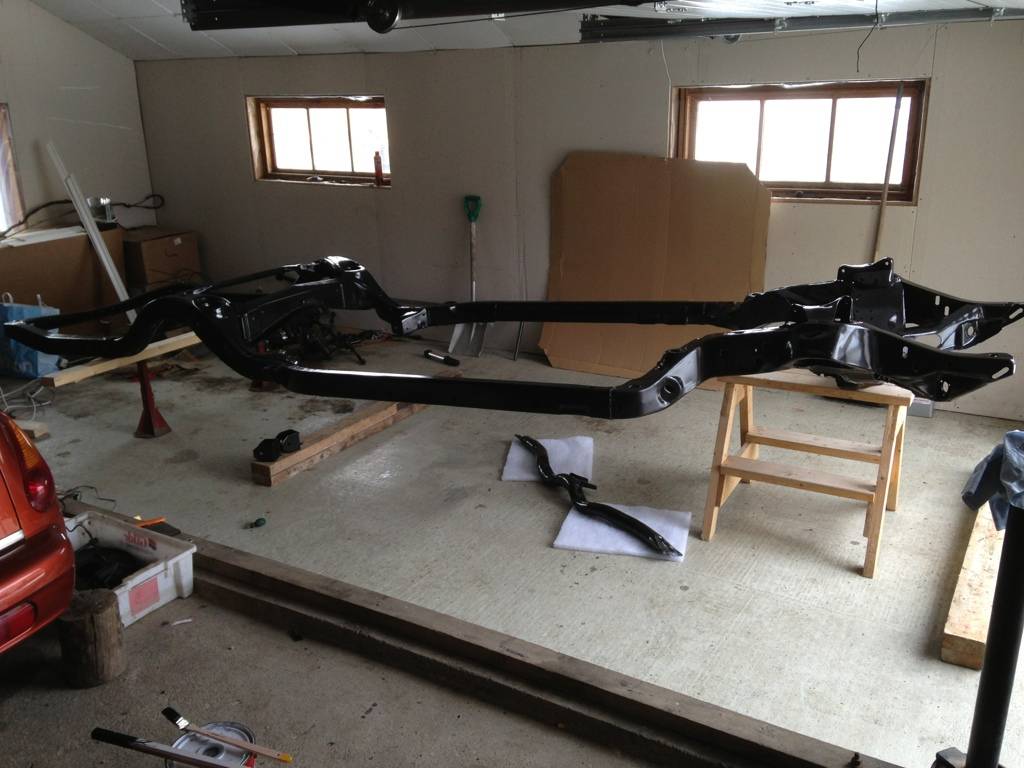

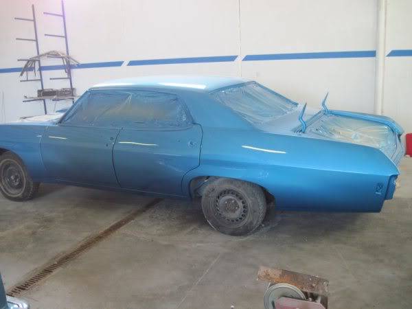

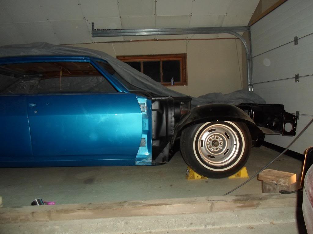

      Off to the bodyshop. My first plan was to get the bodywork done and painted, put the car back together and use it, but that didn't happen.
      The closest to done it was.

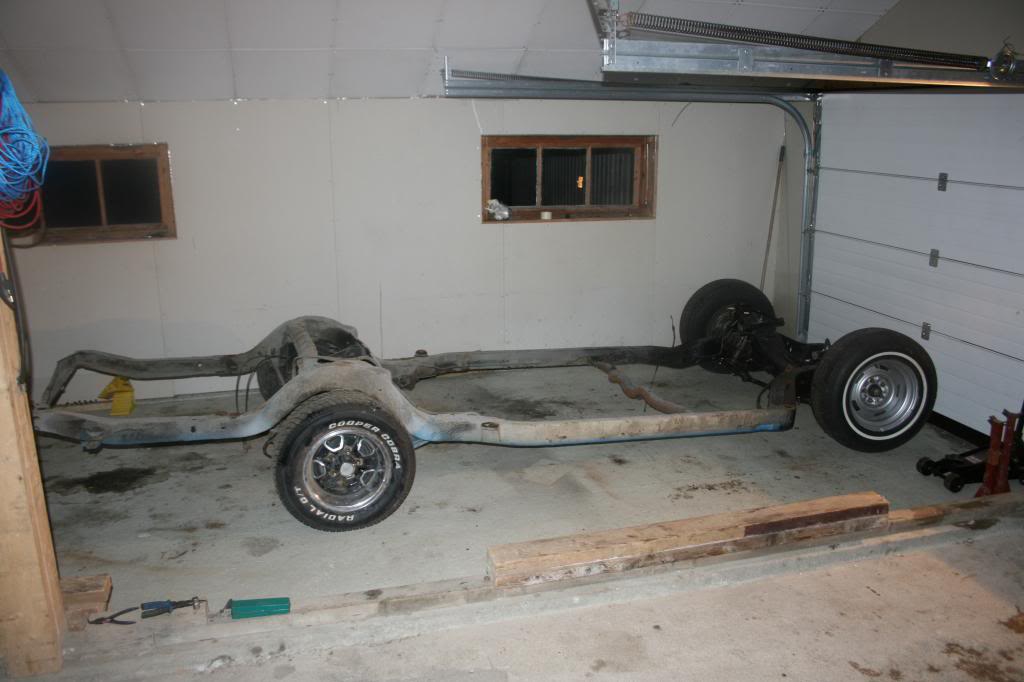

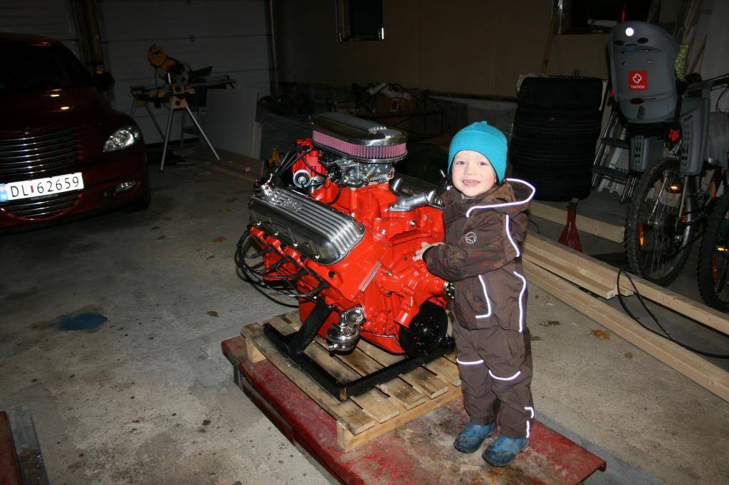

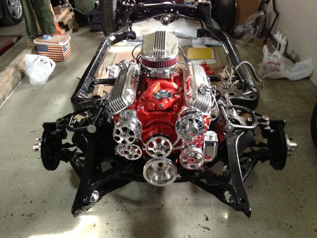

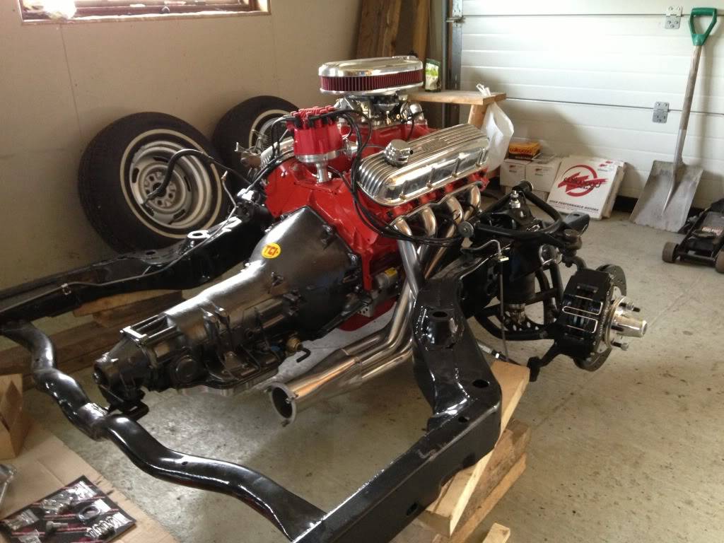

      Engine

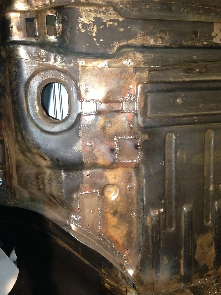

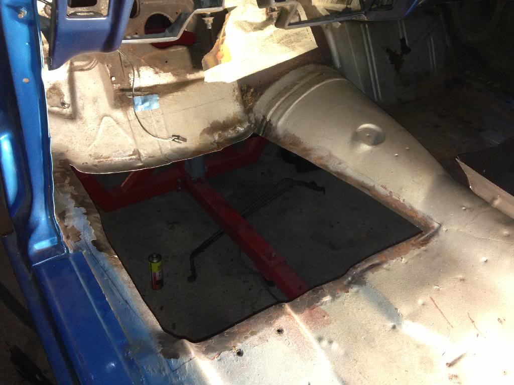

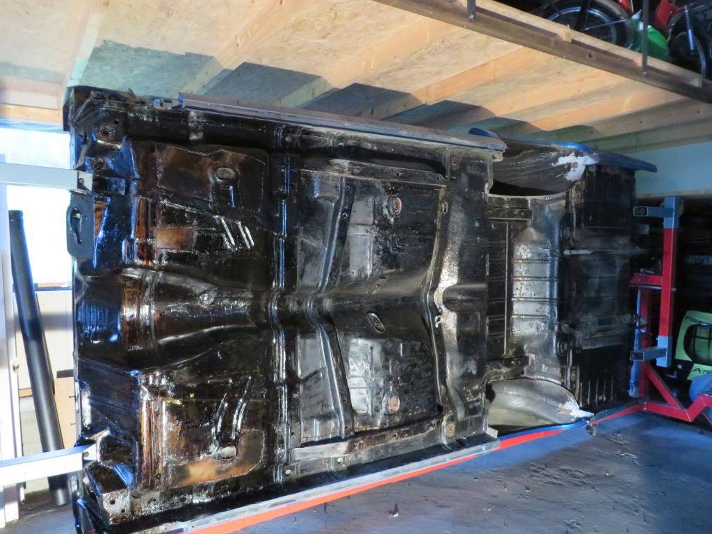

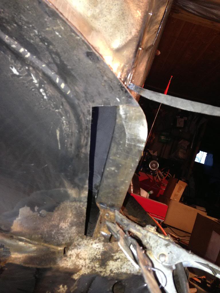

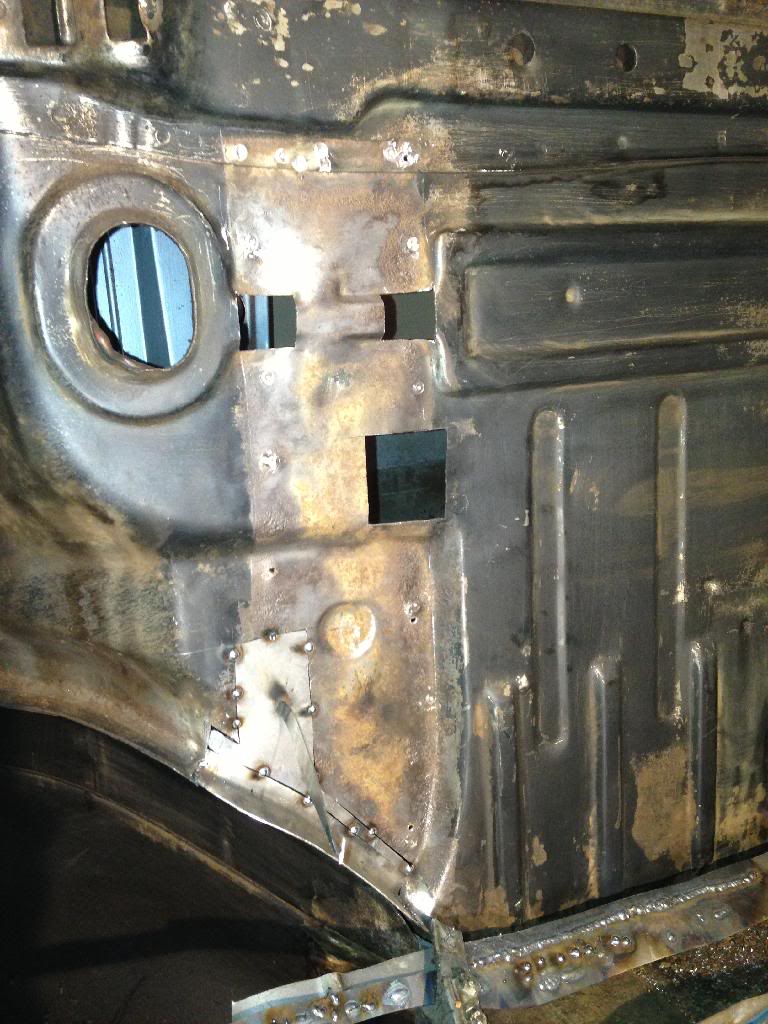

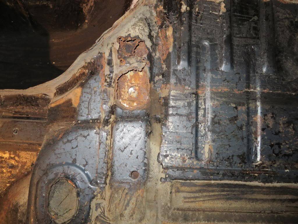

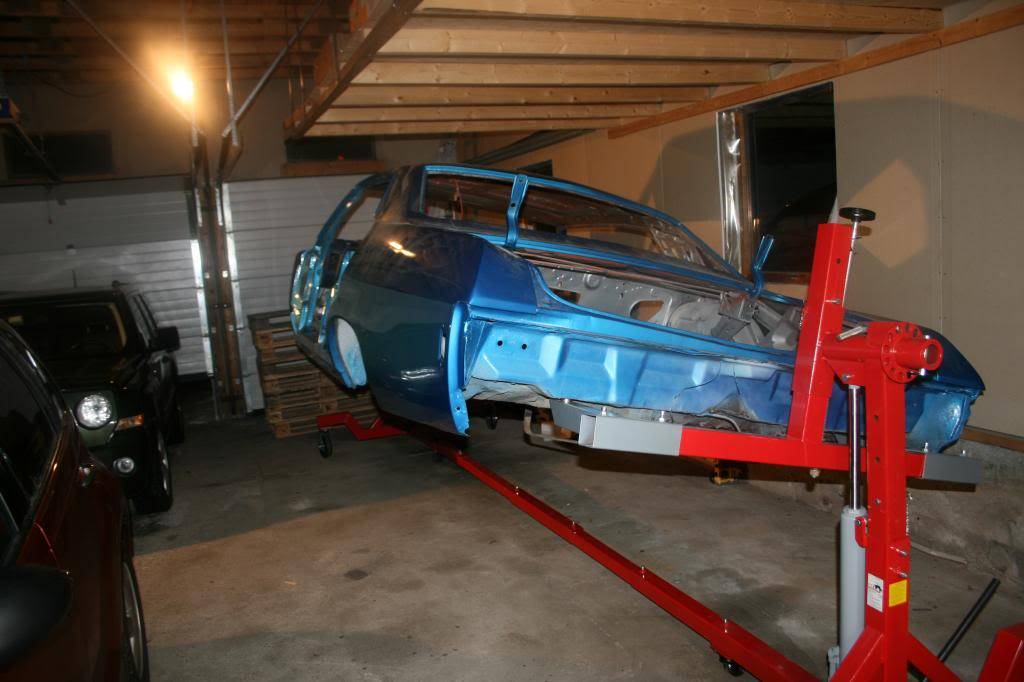

      Under the body. Removed all the old junk with heating gun and scrape and then degreaser and wirebrush. Found lots of rust so have been installing new sheat metal.
      Daddys mini helper

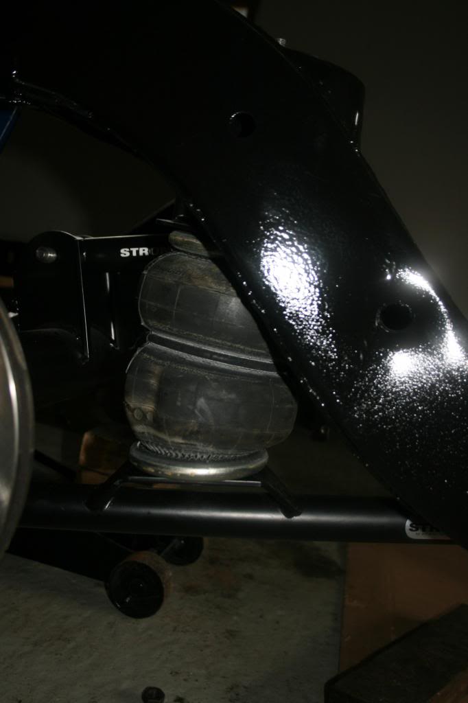

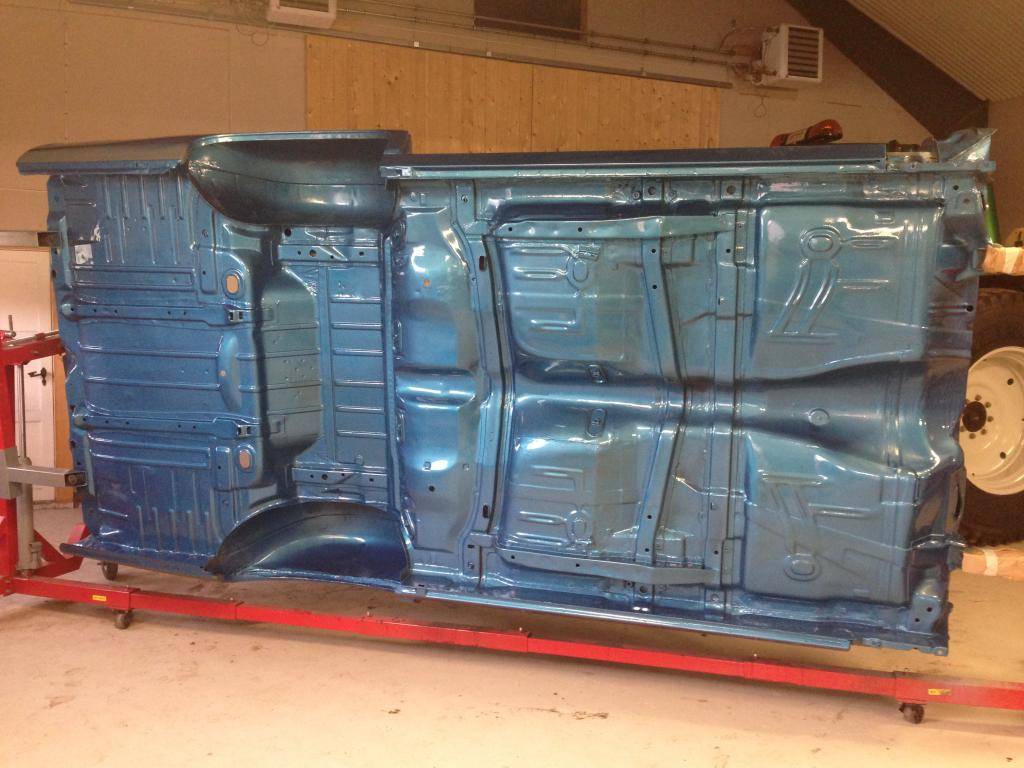

      This is where I am now. Future plans will be to get done welding under the body, clean up the firewall and paint the underside and the firewall LeMans blue. Then figure out Vintage Air setup, electrical harness, paint the inside of the car, install the airride system, clean up the trunk and then just mount everything together. Sounds like a quick fix, right? Hahahaha

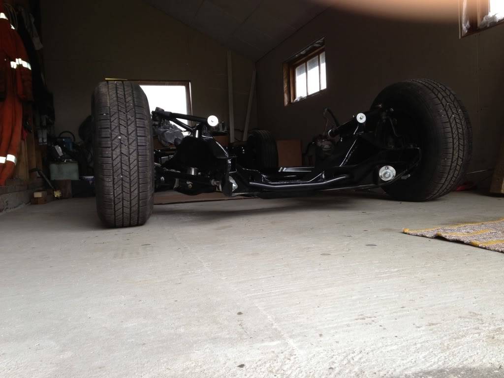

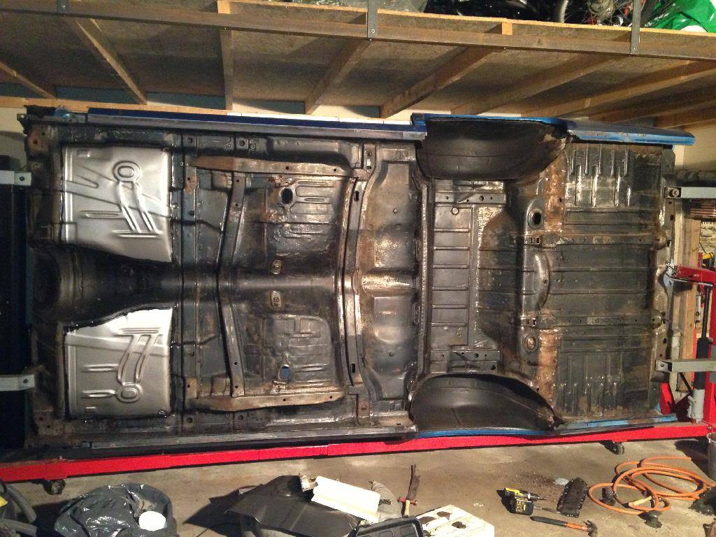

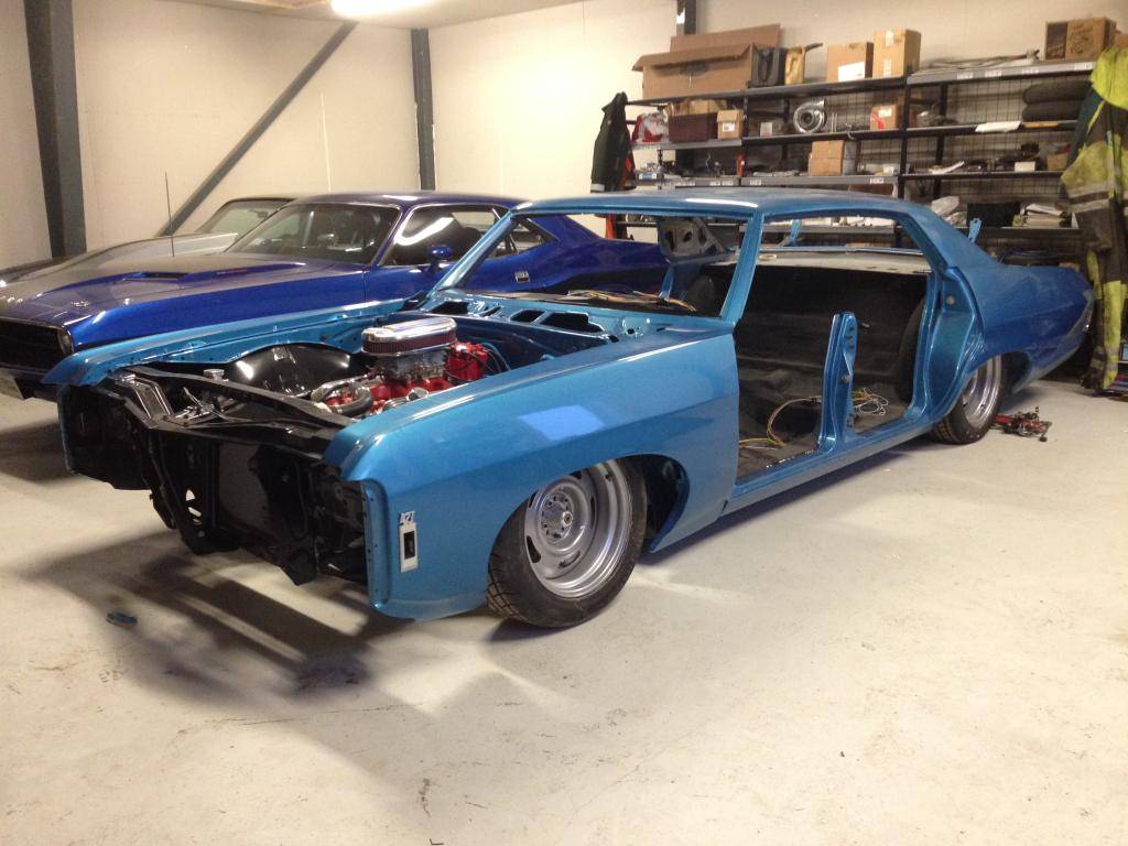

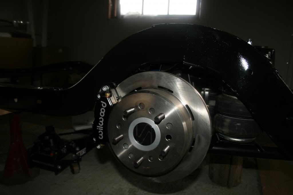

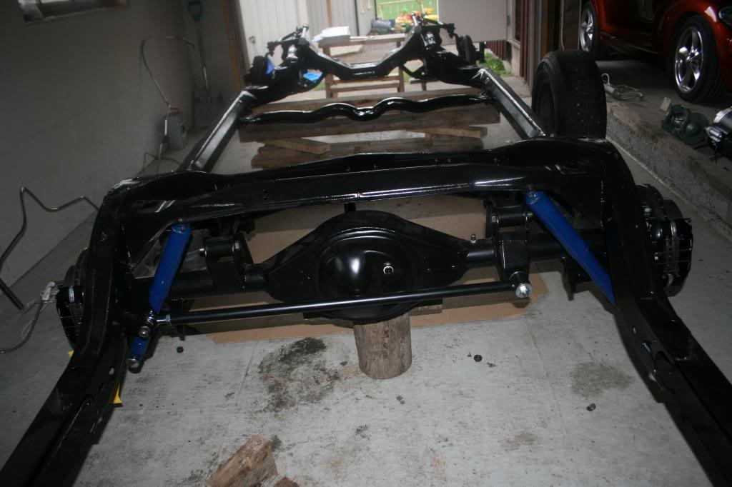

      Some progress
