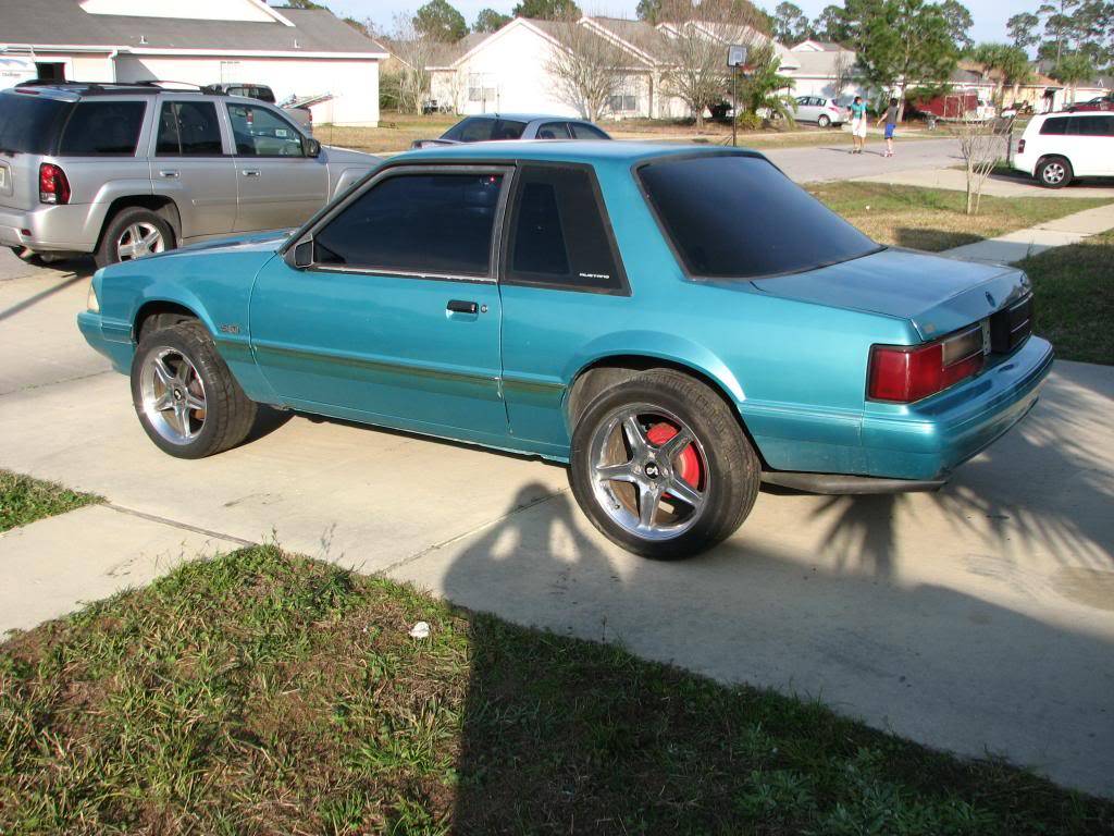

      This is the car after coming out of storage before I began cutting on it.

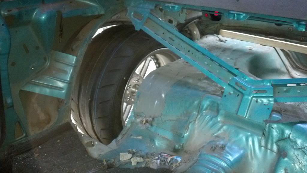

      Factory rear wheel tubs removed and clearance for larger mini tub

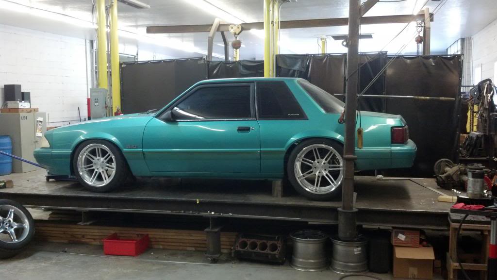

      Mocked up ride height on one of my chassis tables

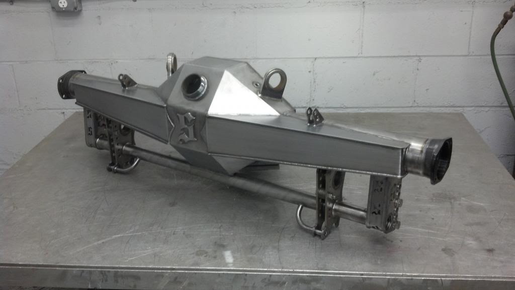

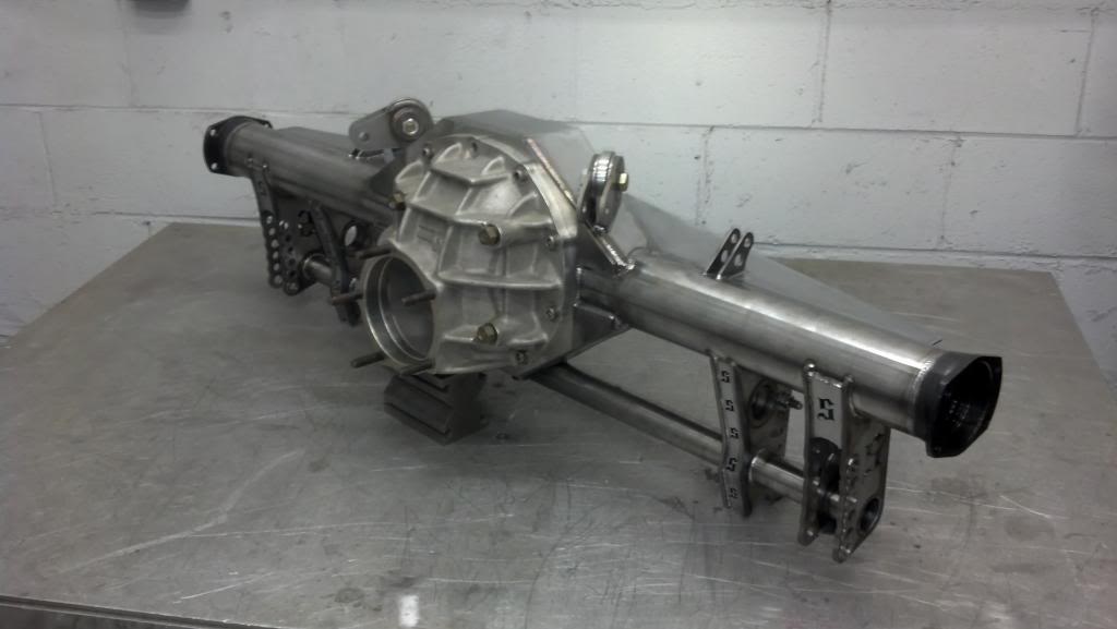

      One of my sheet metal 9" Mustang stock suspension housings

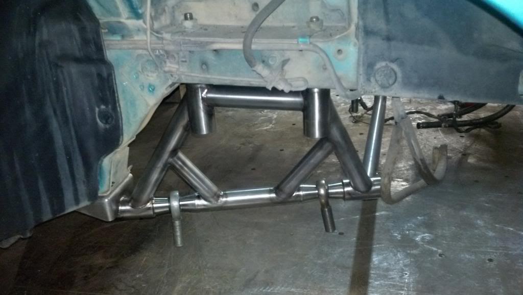

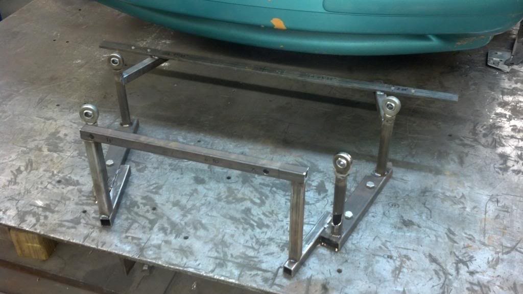

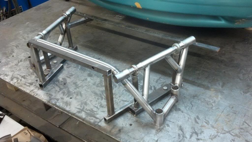

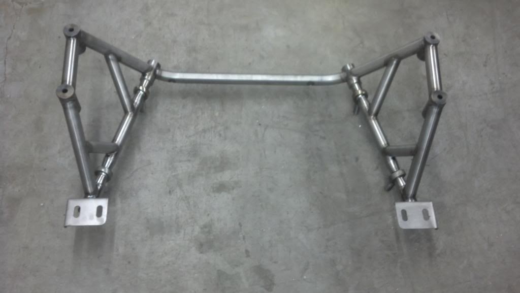

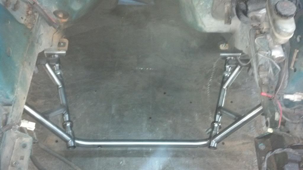

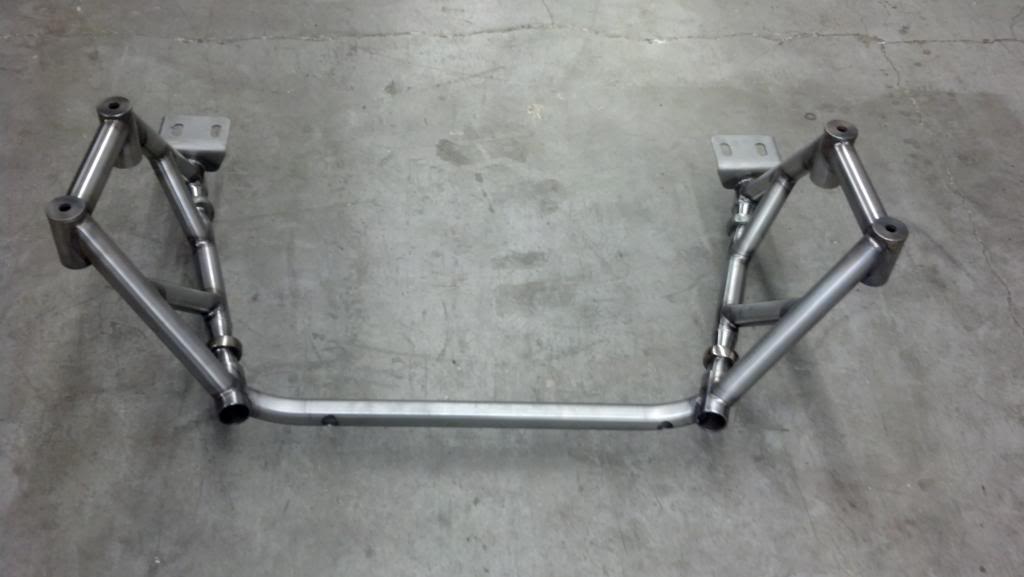

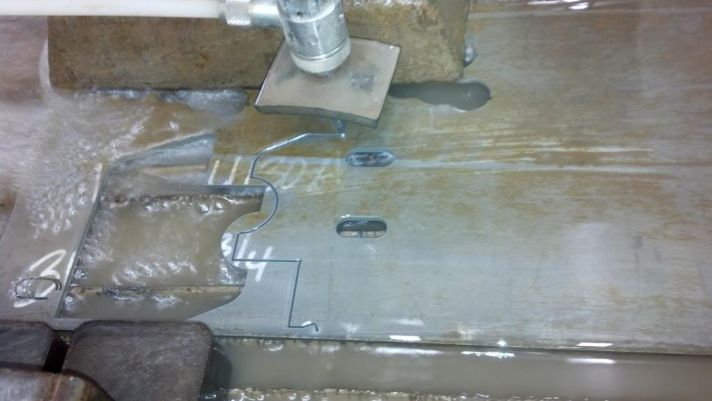

      Made some progress recently. I decided to fabricate my own K-member. I definitely did not expect for it to take as long as it did to build, but i'm glad I opted to build my own vs. buying. Next I need to fixture my spindles in place so I can fabricate the lower control arms. I also plan to sit the engine in place tomorrow and build the engine mounts to the k-member.

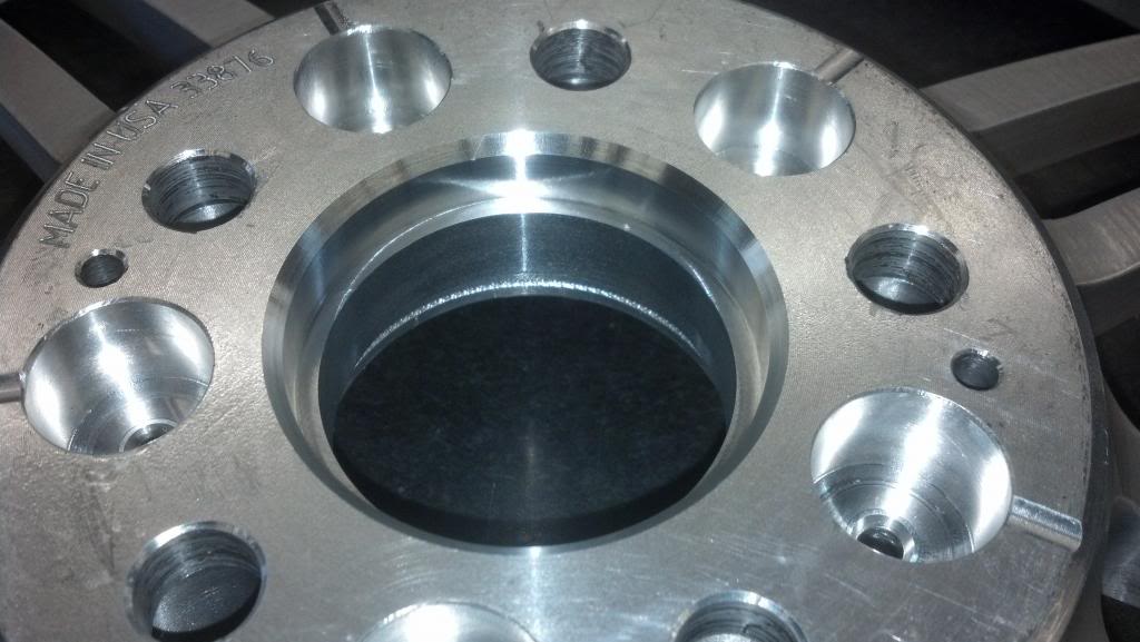

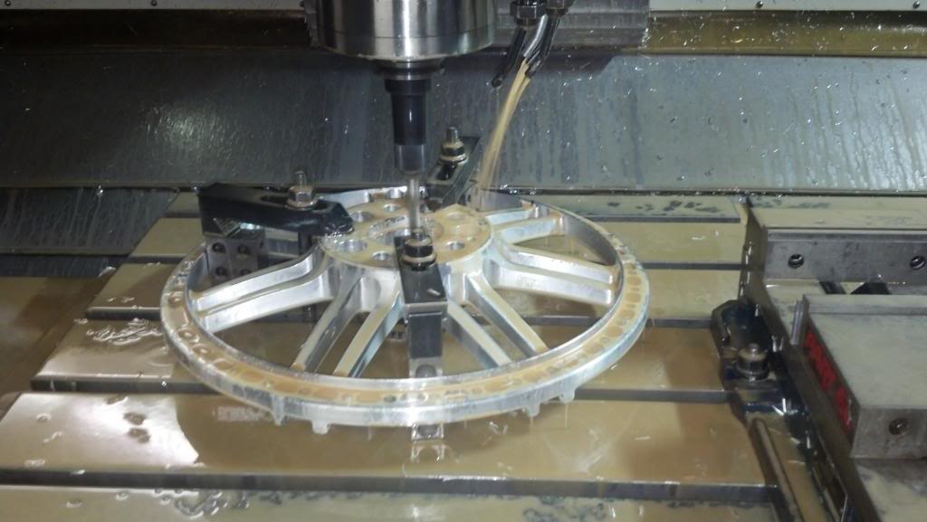

      Rennen did not machine the wheels to the correct bore center so I had to unbolt the centers and machine them in the mill to accept the new spindles and brakes.

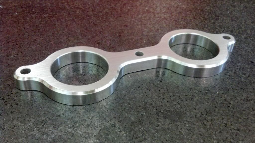

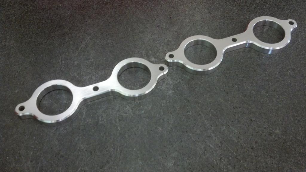

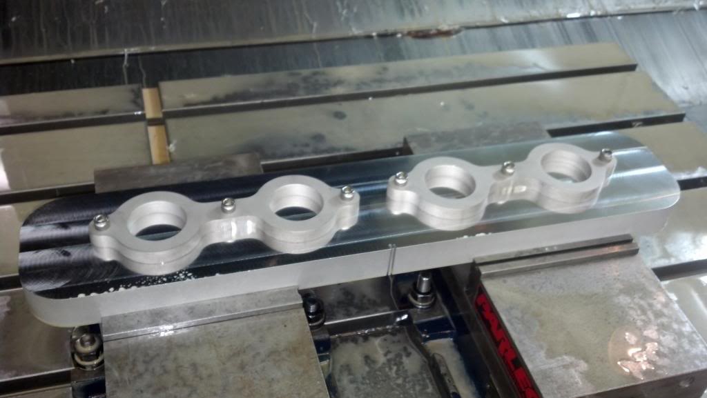

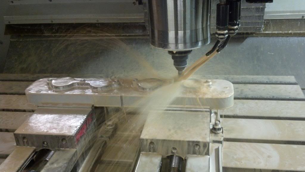

      I have also decided to ditch the Vortech in favor of twin Precision 6266 turbos so I went ahead and machined some 1/2" stainless header flanges so I can get started on the turbo system once the engine is in place.

      My crude but accurate fixture
      New step bore sized to accept new spindle.
      Oversize flanges on fixture ready for machine finish
