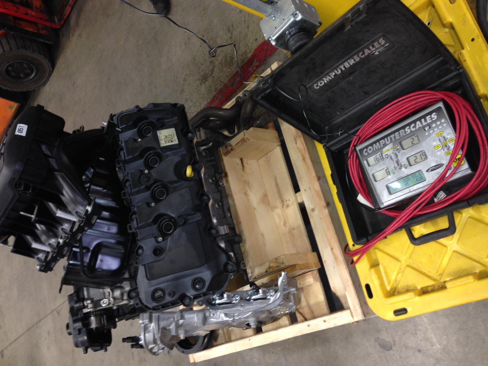

      I wanted to share some more great info he emailed me as I think the weights would be of interest to many on here........
      Old Motor (289) with flywheel, clutch, headers (as pictured) = 500 pounds
      Coyote motor with flywheel, clutch, headers (as pictured) = 420 pounds
      The only minor differences are that the Coyote motor was missing oil, spark plugs, coil packs, and wire harness. So that's a possible 15 additional pounds or so. That would bring it to around 435 pounds for a realistic weight savings of around 65 pounds.

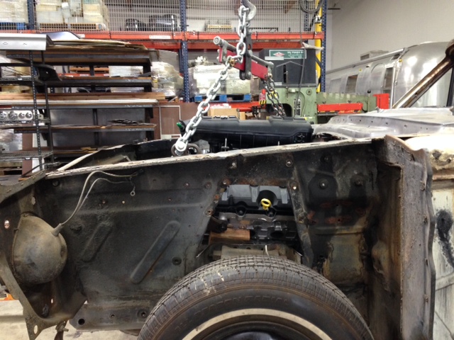

      Ok, now I am starting to get a bit excited myself about the Coyote option.....I just received a few new pics from Jeff at A-47 to get me excited about my visit tomorrow.....
      "This is with the tall boss intake that we don't use. The intake we use is slightly taller than the valve covers. Hood clearance? Check!"

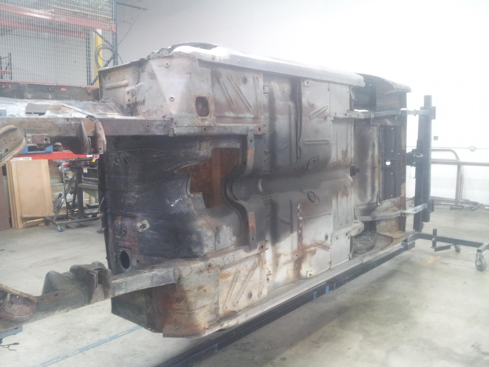

      Stopped by the shop to check out the build..... or should I say un-build for now..... Last week they got the car completely stripped down to the unibody and bolted to the rotisserie. Jeff has been going to town on the car cutting out every piece of unneeded sheet metal, brackets and whatever is going to be replaced. Once the core support and inner fenders are gone, the pile looks like it will be several hundred pounds when you include the metal, plastic, and glass that won't go back in. I am hoping that when done, we will be a couple hundred pounds lighter than the Harbinger, but that will depend on how much metal I replace with fiberglass.
      Does anyone have first hand experience with the fiberglass parts from Crites or others for these cars. I want to have a good finish, and have heard that the drag race stuff can be a little rough. I am especially interested to know if anyone has tried fitting the glass doors and the weight difference.
      Sixgun..... yes, the motor I use will likely be a clone of the motor you see in the Harbinger.
      Next week we should be off to the media blaster and in a couple weeks we should start construction.
      Here are a few pics of the stripped down unibody

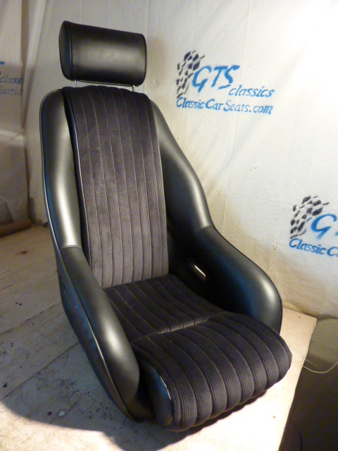

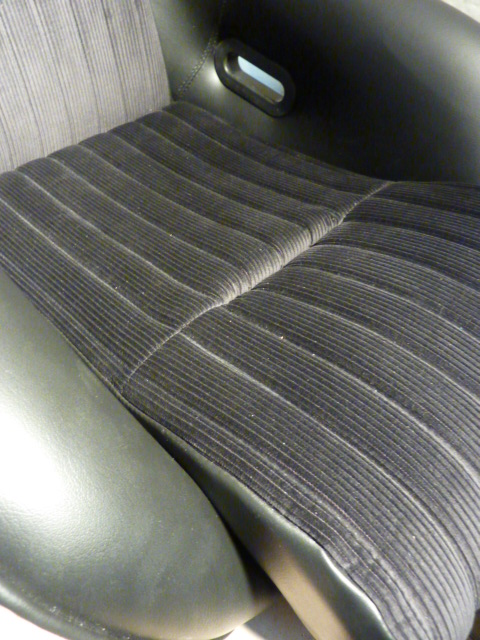

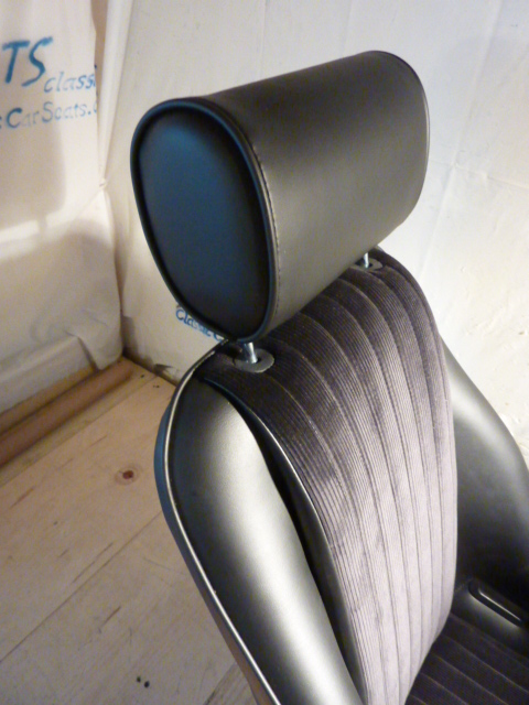

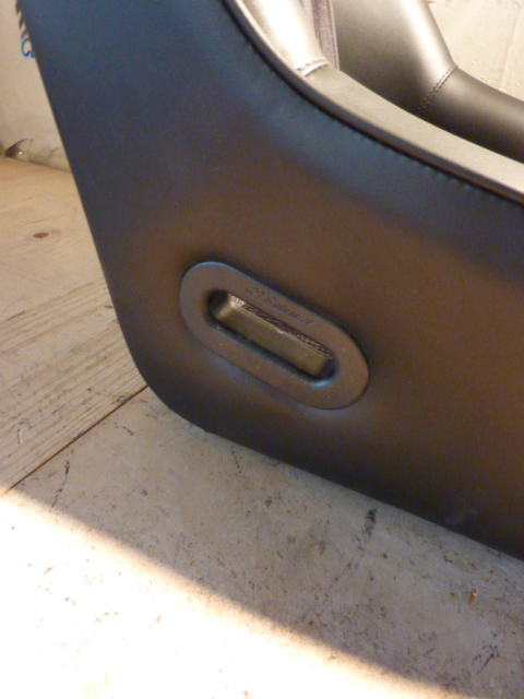

      I just got an email from Stefan at GTSclassics with some photo's of my completed seats that are now on the way. Some of you might think they are a bit old school for a modern build, but I really want to give the car a Vintage Trans Am period look as much as possible. These seats will be for street duty and we are building a seat mounting system so I can quickly swap them out for modern safety race seats for serious track days.
      These seats are his "Trans Am" Model and I think they will give me the look I am going for with the car.
      Cheers, Allen
