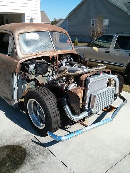

      I finished all the turbo piping and exhaust, got the brakes bled, driveshaft installed and fired the engine during my last r&r....gotta due some tuning and I'll be ready to drive. I still have a lot of body work to do, but I'm happy to be able to drive it!
      I bought a 3 link setup and had it powder coated and chromed...well, a 5 link actually, but the rear bars will have airbags for when I haul stuff. I'm gonna order the ridetech coil overs for it when I'm home again in February....doing a blazer rear swap and adding ZO6 rear calipers and rotors too.

Size:  66.0 KB A couple quick shots I took before putting it back into the garage before heading back overseas.
