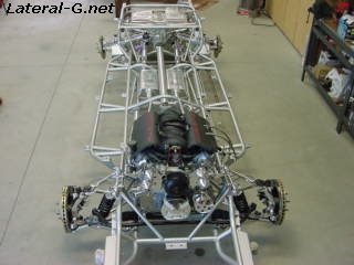

      There are so many details, where do you start. lol It has a turbo oil pump that primes the turbos before start up. The pump also runs on a thermostat that keeps the pump running after you turn off the car to cool the turbos so you don't have to sit there and let the car idle to cool them down.
      It's also riding on a full tube chassis. It's a very trick setup that uses all Vette suspension parts. That's just the start!
