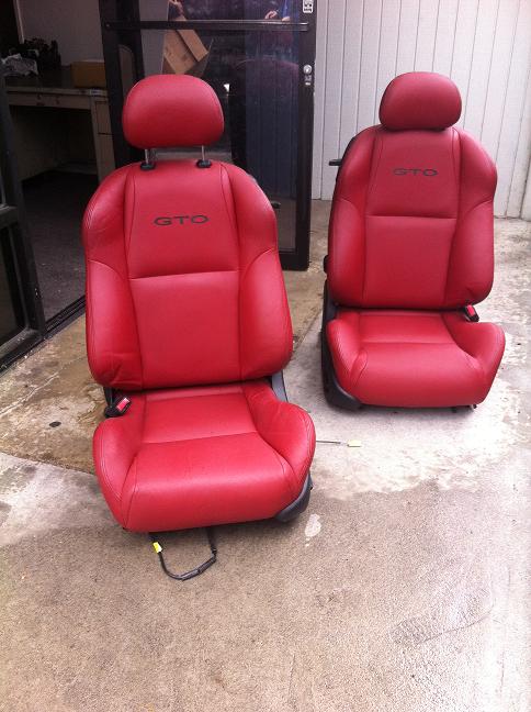

      picked these up for my 87 regal yesterdayName:  IMG_gto.jpg

      I'm looking for a set for my 79 TA myself! Those look great! Keeping them red?
      California City Ca.
      398
      yea i like the red, scored them on ebay there were a few black sets on there still. got them for 400 bux good condition no rips or scuffs.
