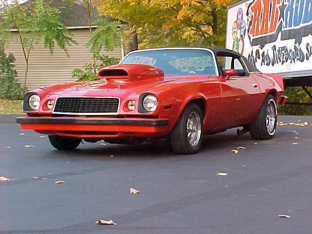

      Factory bumpers tie the front frame horns on most chrome bumper cars. During an impact a lot of force is absorbed by the bending of the bumper and the frame sections before the core support and front of the engine takes a hit. I've had fiberglass bumpers on street cars and was always concerned about an accident that might slam the engine through the firewall.
      The car below had a glass bumper & hood along with factory glass header and valance panels. If there was ever a front end collision there wasn't much left to absorb the impact. Was a light car though!
      That makes sense for the front, but I have a split rear bumper so Im hoping I might be able to get a similar force vector on the bracketry with the composite bumpers.
