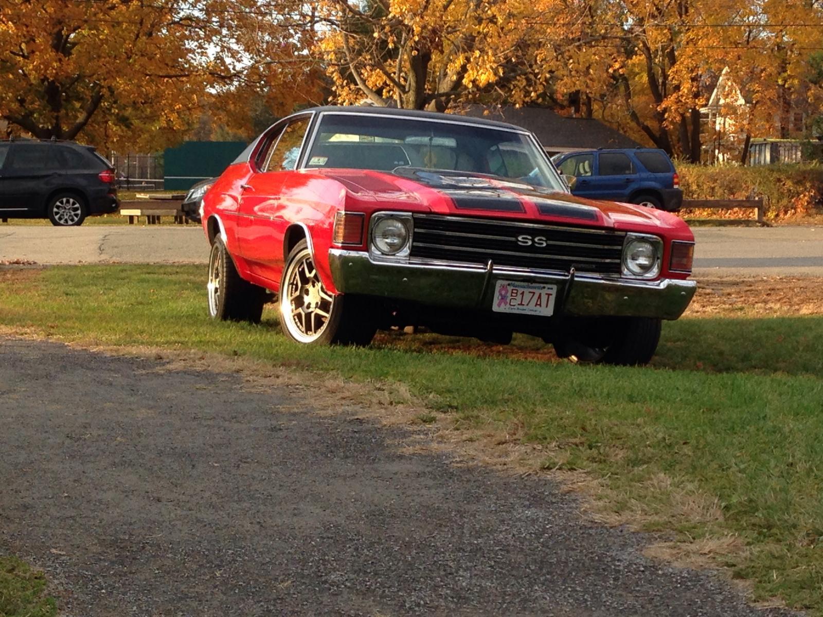

      Guys thanks so much for all the advice! I have a 72 chevelle it's fully restored so everything is in perfect shape I'm just not a huge fan of chrome... It's red with black racing stripes and I'm about to drop in my ls and lower it an inch or 2. I would do all the work myself so all I need to pay for is some grit and a lot of man hours lol here's how she sits now
