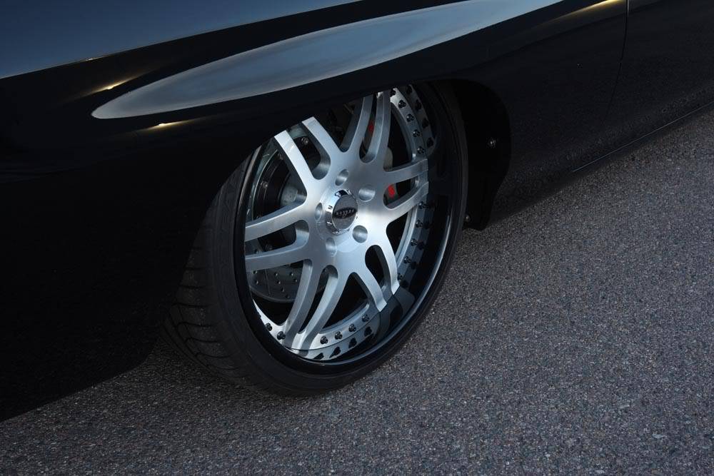

      Chris, I saw these wheels on your camaro at Sema. What size were the wheels? Could you PM me a price in these wheels in a 19x12 and 18x9 w/the same finishes. Sorry for hijacking the thread but great pics.
