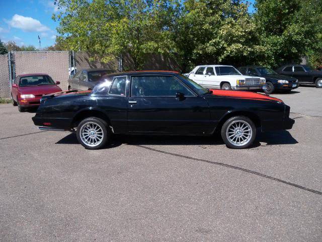

      Photochopped Stance, though it still has more rake in it than what I'm planning. Will have the front end a smidge higher than this.

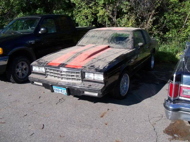

      VERY Dirty, we'll worry about that later.

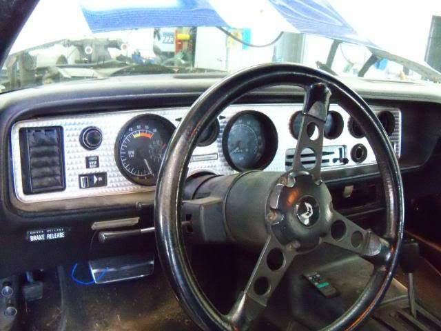

      Interior shot, dash is apart to sort some wiring for the digital Speedo and Autometer Tach, had some issues with them when it was parked.
