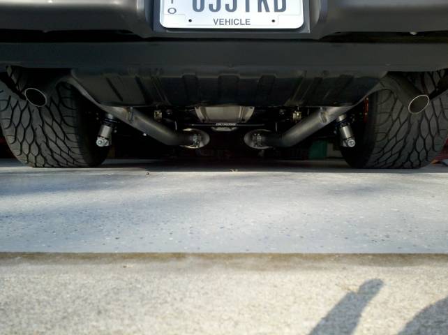

      Sold my Caltracs and about to pull the trigger on a ridetech 4 link for a second gen Trans Am.
      Does anyone have any install pics? Wondering how much room the upper link and shock support takes up? Ease of install?

      did the install in a day right in front of my house next to the curb
      Feb 2007
      1,402
      The install is not bad at all just take your time. the hardest part was setting the pinion angle. This is the best pic I have. you dont have a lot of room above the upper links. I have a stock width tank so I ran my exhaust under the axle. Not my first choice but I do like it

      The 4 link isn't your first choice or running the exhaust under the Axle?
      I was hoping not to have to redo the tail pipes. Guess that is what I get for doing it in stages.
      Feb 2007
      1,402
      The exhaust. You will have to redo you tail pipes. If you go with a notched fuel tank you will be able to run tail pipes over the axle
