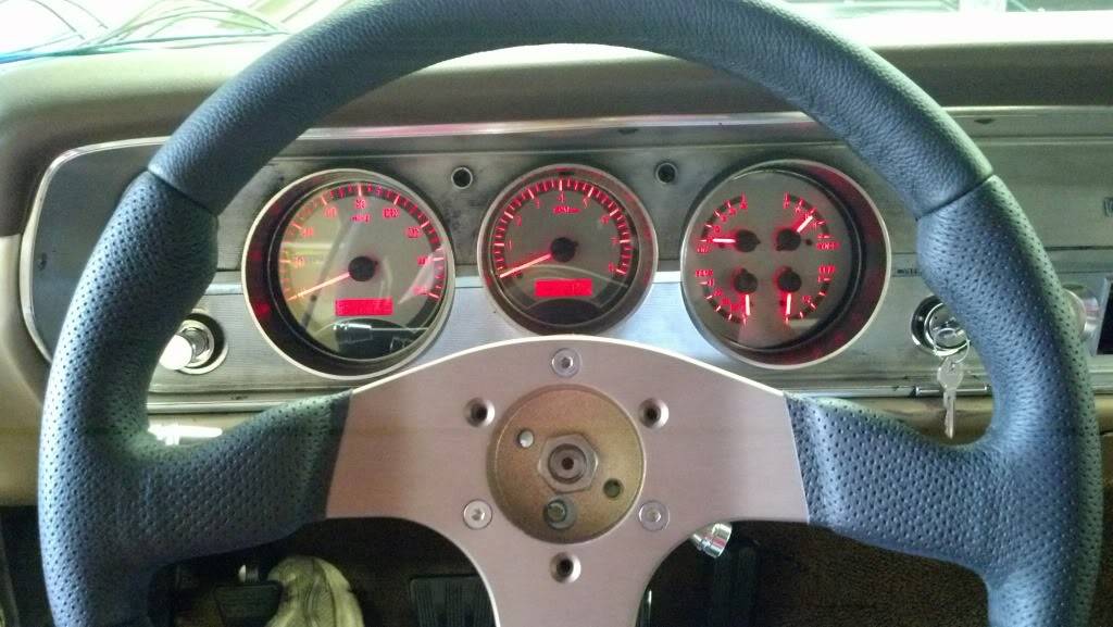

      I have an ididit column, but the stock mount is similar I believe. Momo has a 6 bolt pattern that will require an adapter for sure. My adapter came from ididit, but it may work on stock too??
      you can see the mounting pattern here, mockup only 3 bolts installed.
