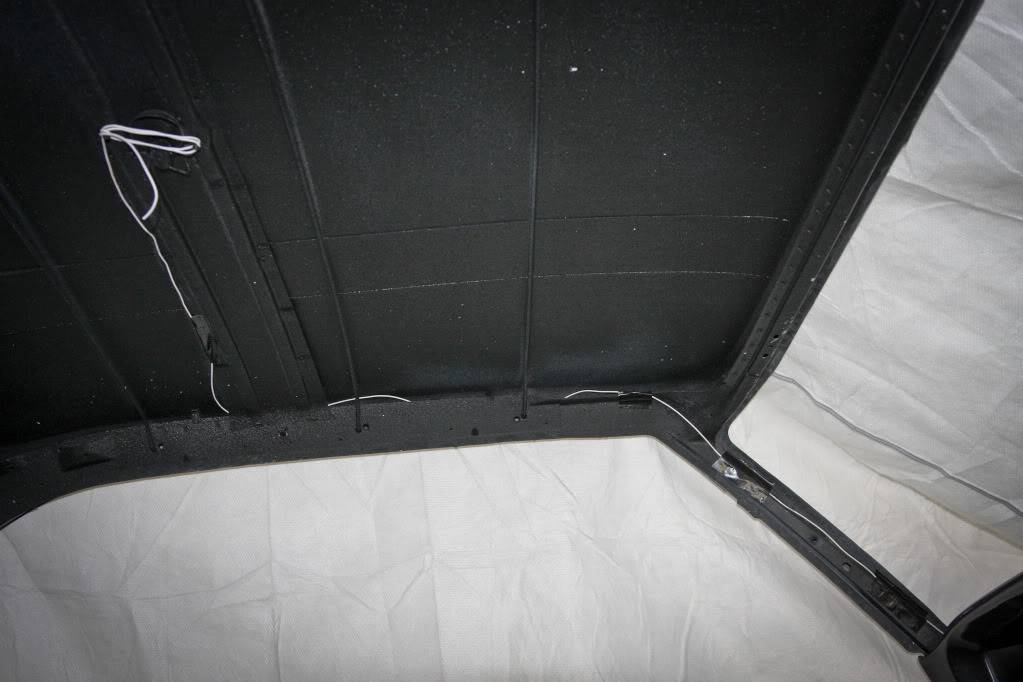

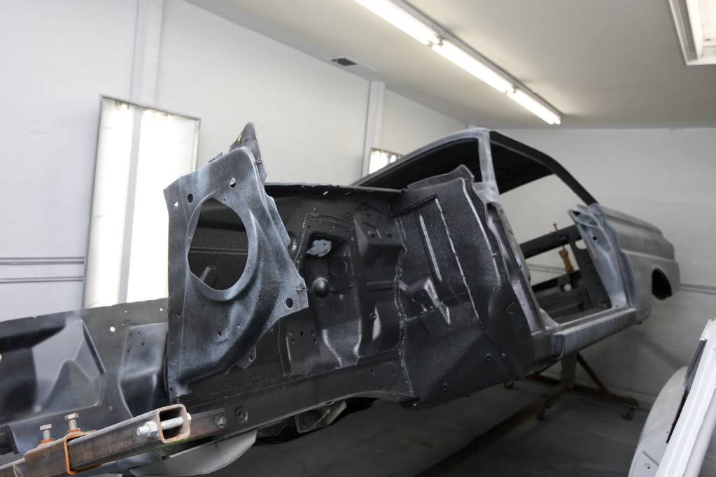

      I applied RL after final guide coat and before sealer.
      If you can, try to flip the car and get the top of the inner-roof and under the rear package tray.

      Munssey-
      Was that one kit that you used for your car? Or did you have to get more?
      It turned out great!
      May 2013
      Texas
      297
      Quote Originally Posted by Spork82 View Post
      Munssey-
      Yup, 1 kit did it all (barely!) The Falcon is still a relatively small car to cover. I think a pony car, Nova or Dart would be equal in coverage but something larger like a Challenger\ Cuda, Chevelle might take two kits.
