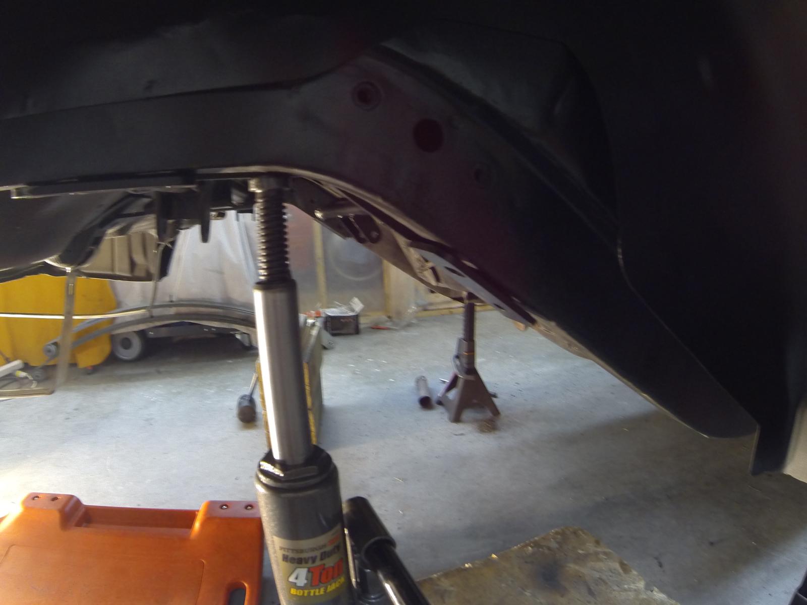

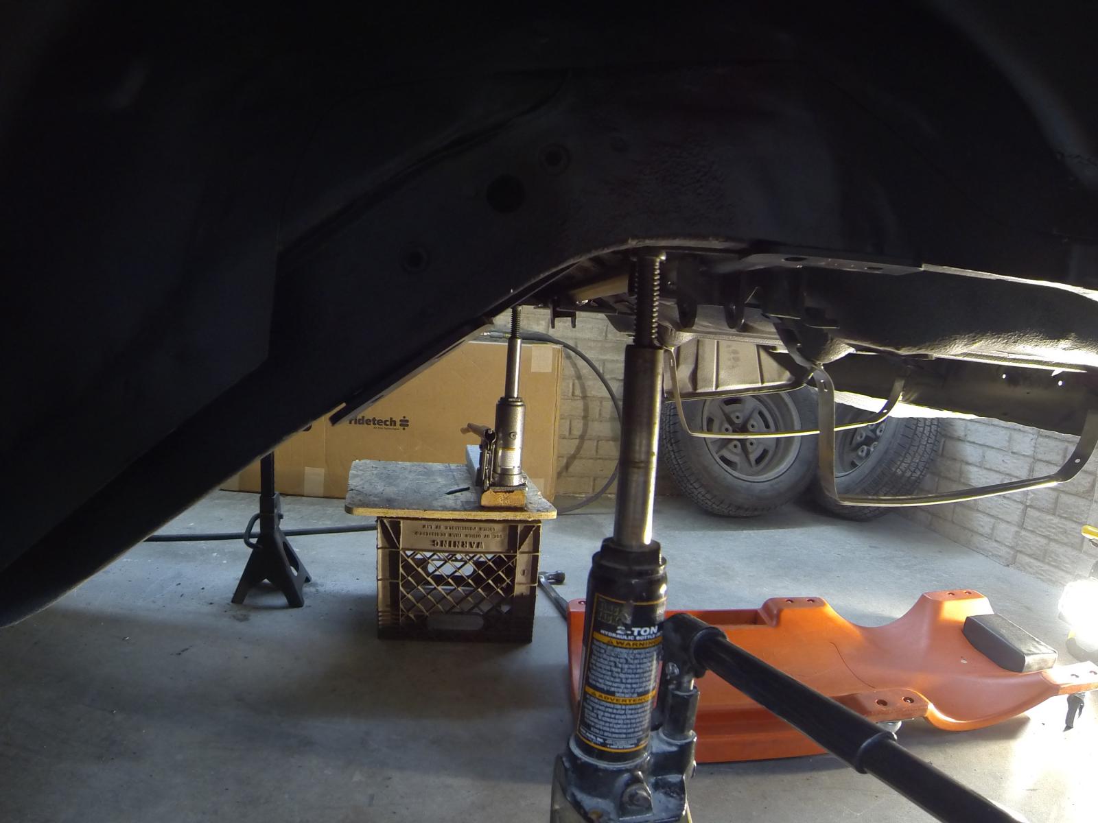

      Aug 2010
      451
Size:  141.2 KBName:  4-link 009.jpg
Size:  111.5 KBThese might give an idea of what I am talking about. Sorry about the wide angle...had to us my Go Pro.

      Didn't you say that the center pinion snubber mount is still in place? If so, then that is where your fitment issues are happening. I installed this same setup in my 67 Camaro. I followed the instructions to the 'T' and had no install problems.
      Aug 2010
      451
      I will double check, but I don't think I have interference at the pinion snubber. I was under the impression that the snubber had to be removed for maximum drop when using air ride instead of coil overs.

      The pinion snubber mount will have to be removed even when not running Shockwaves to allow full suspension travel. As far as mounting the cradle, the main thing is slide if forward as far as possible. Due to manufacturing tolerances back in the 60's(even newer), no two cars fit the same. Some fall right in, some have to be massaged. If you start bolting it up the gaps should lessen. I would get the upper bars placed before welding. You can weld it when your putting the final welds on the bars tabs. Remember to set your pinion angle before welding the upper bar tabs on. Generally the pinion is set 2 to 3 degrees parallel with the transmission.

      You are over thinking this, really. It's important to follow the instructions very carefully on the install and not try to think outside of their original design. The reference points that are not on the 69 are not really needed. If you remove the pinion snubber 'mount', then you will have enough room to slide the cradle all the way forward and allow the cradle to fit where it was designed to fit.
