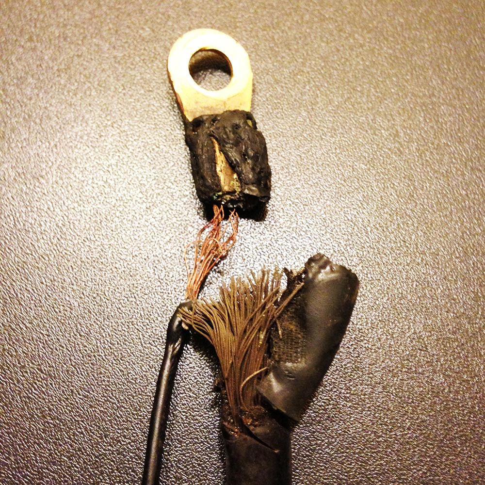

      Very timely thread. I just had an issue last night with my alt. When out this morning and found this.
      This is a 4 gage wire from my alt to my battery (14" long) - this WAS charging cable to my battery. No wonder I had a dead battery.

      So I cut open the AUDIO wire I had used. Roughly the first 4 inches was hard as a rock, the rest of the wire was fine.
      Pulled it out - for curiosity.
      When I found fresh wire this powder came out - the smell burnt the inside of my nose.
      About 6 inches inside the wire was corroded to death.
      Finding better wire tomorrow. As you say - not all wire is created equal - I know this and I still got caught.
      Feel free to learn from my mistakes.

      First. The wire. I was in a pinch and had to buy a chunk of Pyramid High Power Pro Wire... (sigh)... and forgot about it.
      2nd. I did have a dead short in the interior that took out a wire that excites the internal regulator, the lens had came loose from the LED indicator light and expose the leads (joy). No other wire was hurt under the hood. This was very corroded and the dead short happened last week. Based on how I have it wired, I think it's co-incidence as wire that connects the charge circuit and the excite circuit was untouched.
      Fortunately, it's an easy fix. And I was lucky that I shut down right at my garage door. Normally, not that fortunate.
