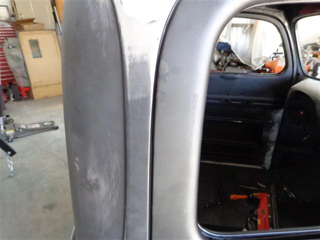

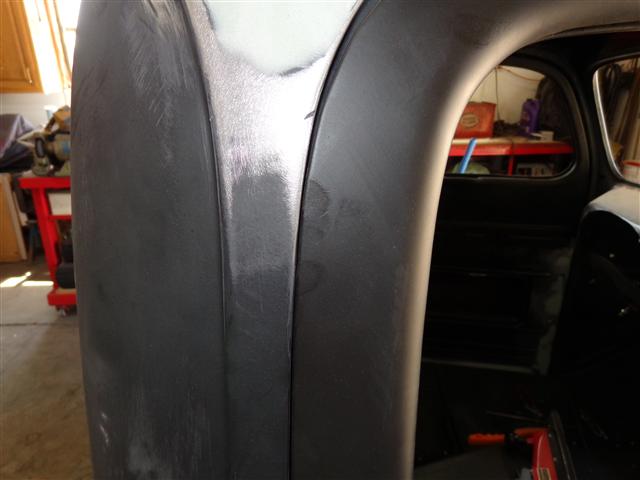

      I went out this morning thinking I'd get the body work on the cab finished up and primered. I tried to adjust the door hinges but nothing good was happening. I measured the other cab I have and found that the door posts were a 1/4" farther apart than this one. Out comes the portapower. In a little bit I had nice door gaps. My memory isn't good enough to remember how the gaps looked when these trucks weren't very old but this has to be way better than it was. I did some more bondo work but aren't far enough along to primer the whole cab.
