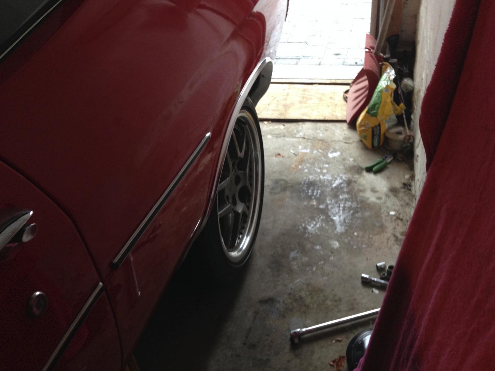

      then i swapped out my bench seat with some new bucket seats that i re-covered myself. I don't have any pictures of those at the moment.

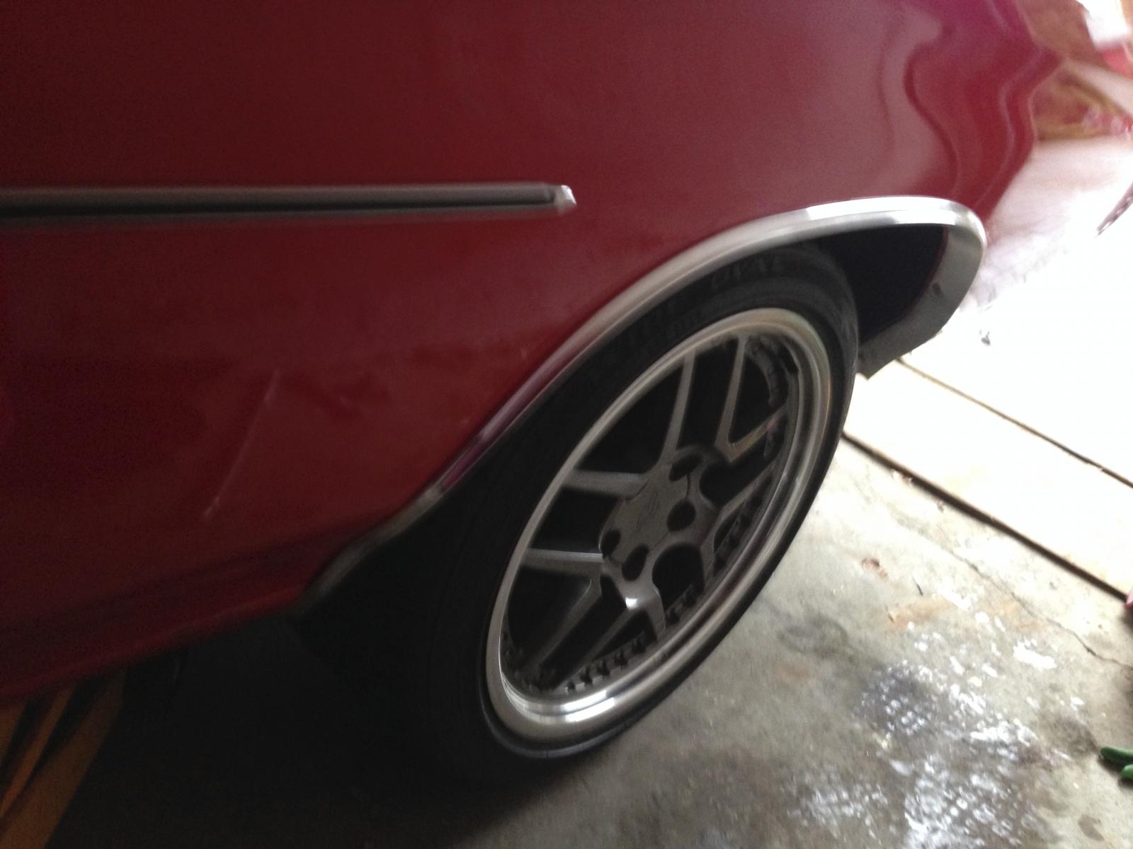

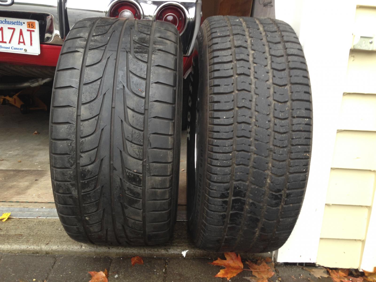

      Lastly, I picked up some new rims and tires off a friend today. They are from a corvette and am still waiting on the spacers to come in the mail but here is a mock up of one of the rear tires
Size:  139.1 KBName:  IMG_4459.jpg
Size:  191.8 KBName:  IMG_4465.jpg
Size:  130.4 KBName:  IMG_4464.jpg
Size:  125.5 KBName:  IMG_4460.jpg
      the car looks messed up because it is still jacked up.

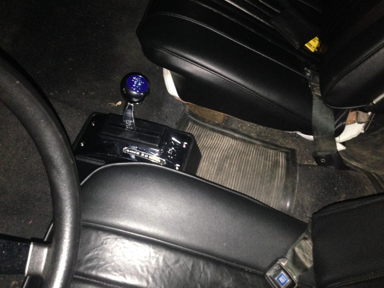

      Finally got all of my stuff into the car. I ran into a little issue with the B&M shifter though...for some reason, no matter how i adjusted it, i keep getting a double reverse gear. So when i shift down to revers, i get reverse for two clicks before i hit neutral. Any experience with this??

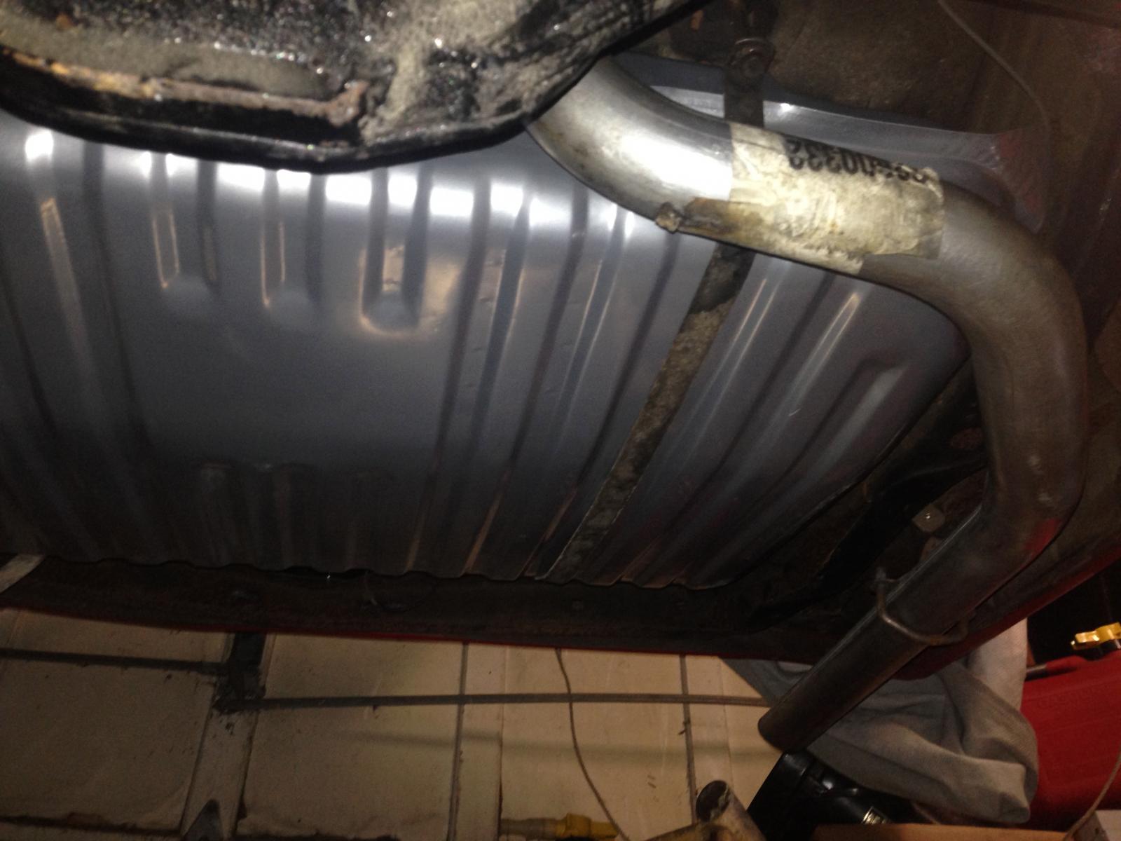

      1) tank's inc full set up--EFI tank, In-tank pump, sending unit

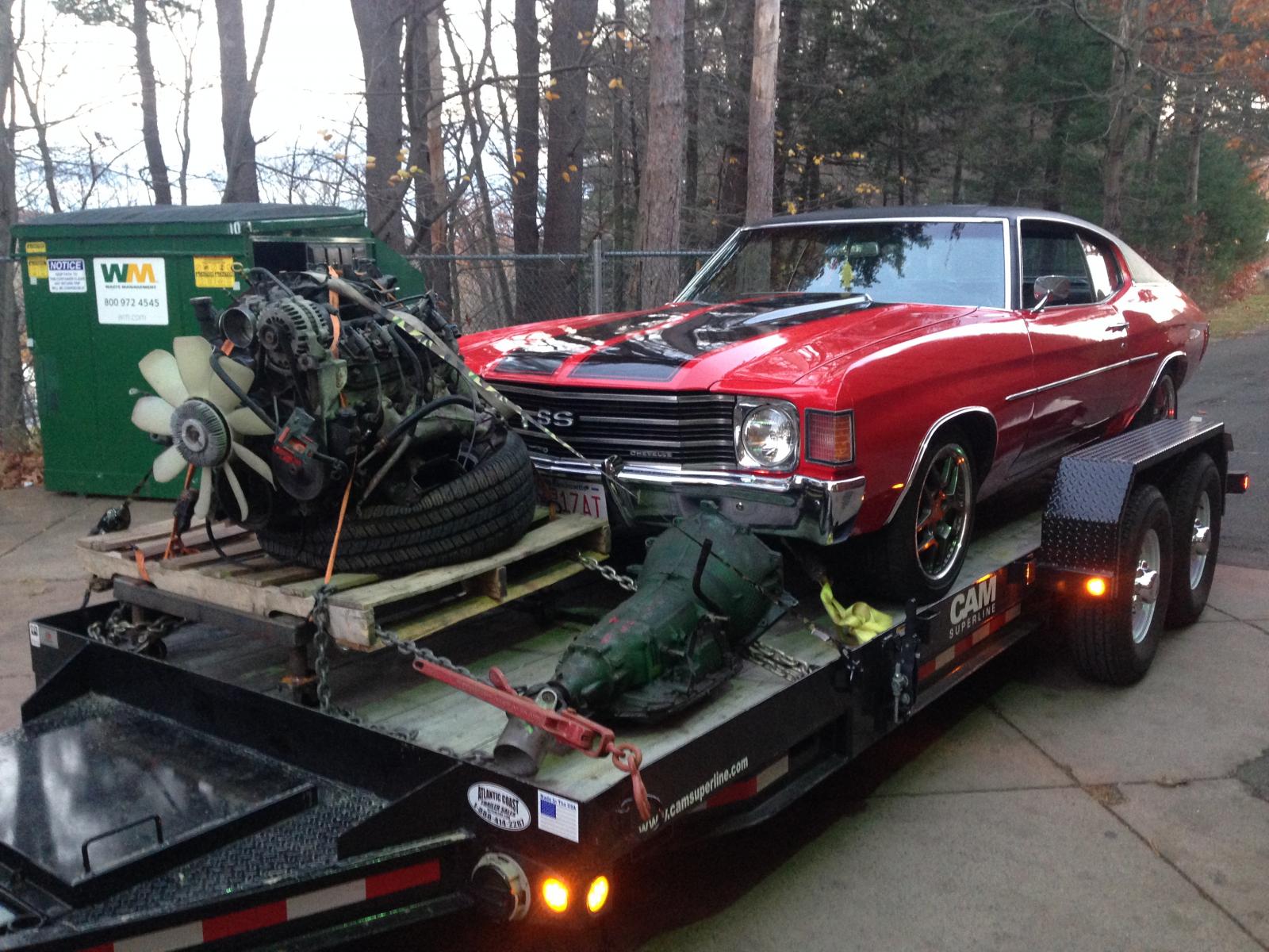

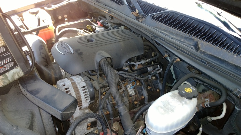

      5)last but not least. i will be picking my 2004 5.3l up next friday. its out of a youkon with 120k on it. runs perfect. also coming with it is a 4L80e and a complete(and worked harness) as well as the computer. im hoping the 80e goes in without too much hammer use i already have a paint scheme and set up for my engine and bay but i will leave that till next time...

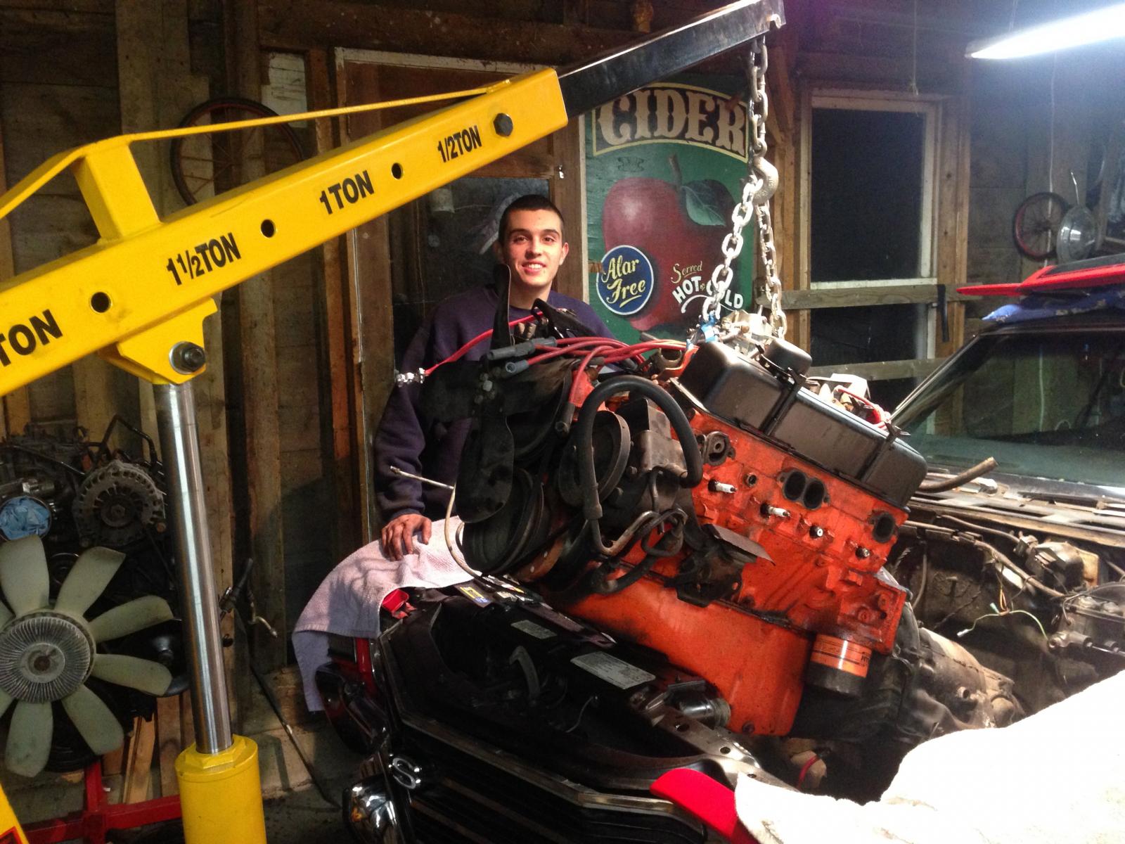

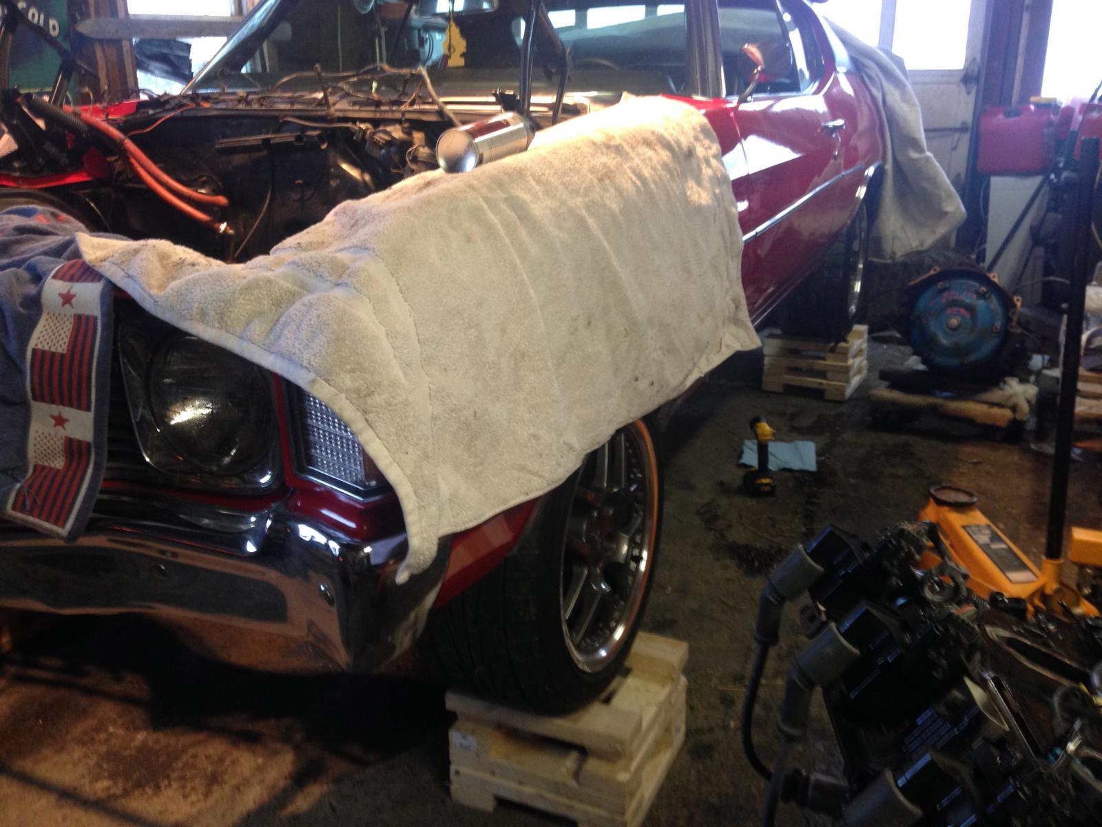

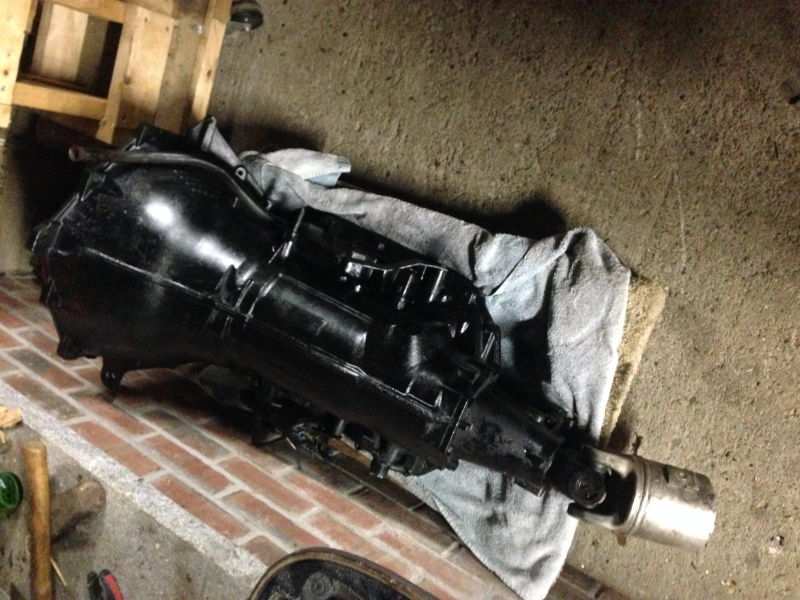

      Had a very productive weekend for working with myself and 1 buddy. got the motor and tranny set in and wired. this week hopefully i can get the flex plate and converter mated without having to pull everything again. any advice on a p/s pump pulley?
Size:  273.2 KBName:  IMG_4851.jpg
Size:  254.6 KBName:  IMG_4852.jpg
Size:  225.1 KBName:  IMG_4830.jpg
Size:  232.8 KBName:  IMG_4835.jpg
Size:  137.6 KBName:  IMG_4854.jpg
Size:  233.8 KBName:  IMG_4816.jpg
Size:  244.1 KBName:  IMG_4843.jpg
Size:  232.2 KBName:  IMG_4802.jpg
Size:  208.4 KBName:  IMG_4833.jpg
Size:  118.8 KBName:  IMG_4832.jpg
Size:  208.9 KBName:  IMG_4836.jpg

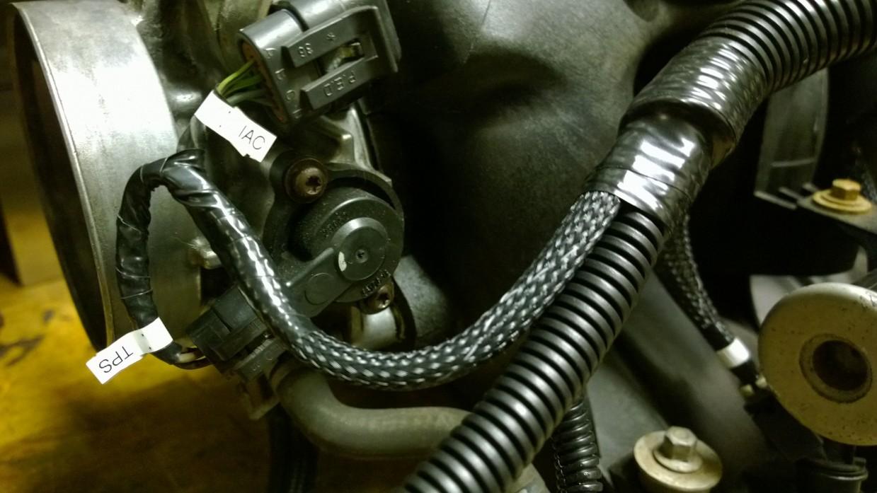

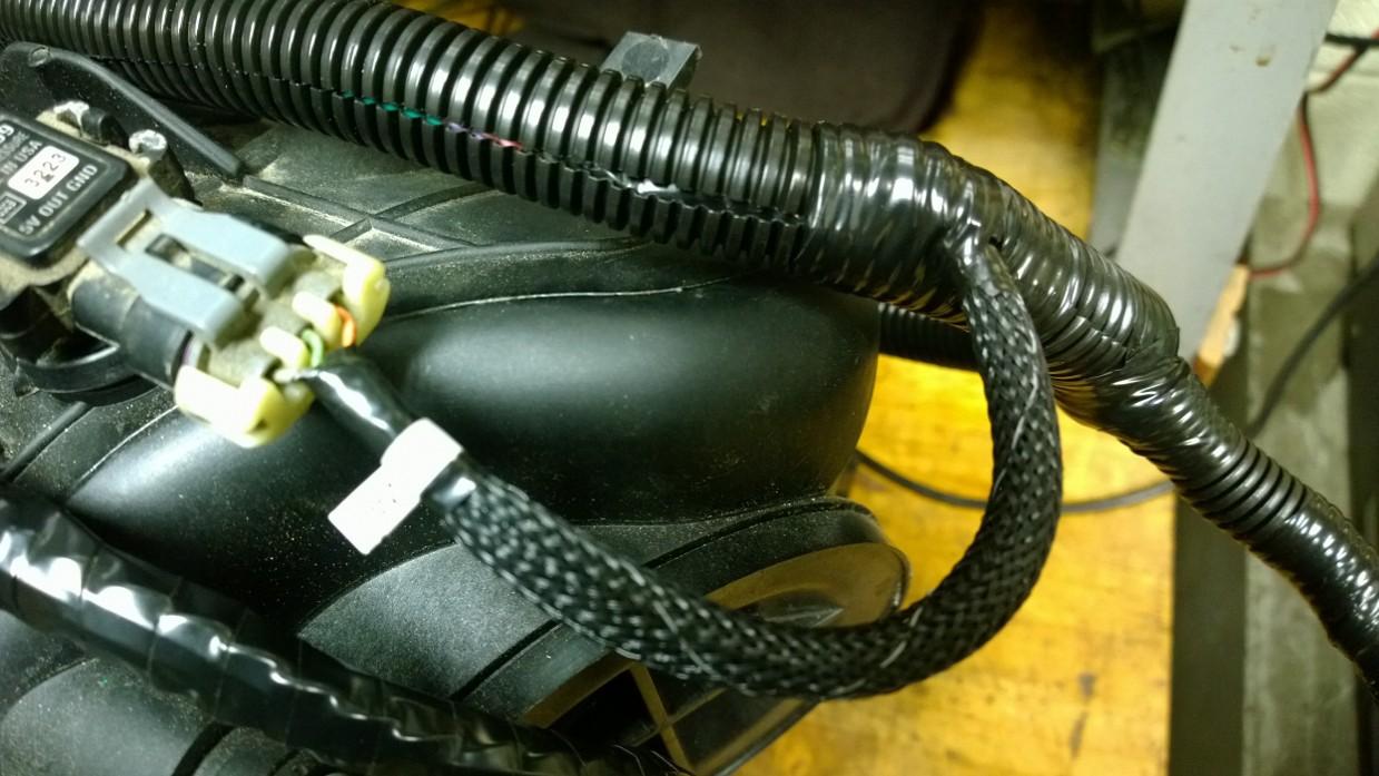

      spent some time this past weekend getting some finness stuff done. got most of my wiring completed. still waiting on some gauges and forgot to get a relay for my fuel pump lol. also got my fuel completely plumbed, new tank in, and the new 12 bolt in. i realized after the fact that i had everything wired, bolted in, and completed that my flex plate on the 5.3 will not mate to the 4l80e... so i ordered a new tci one with the spacer and bolts and hopefully that won't take up an entire day this coming weekend lol
Size:  106.0 KBName:  IMG_4920.jpg
Size:  230.3 KBName:  IMG_4927.jpg
Size:  306.7 KBName:  IMG_4916.jpg
Size:  125.2 KBName:  IMG_4917.jpg
Size:  141.6 KBName:  IMG_4922.jpg

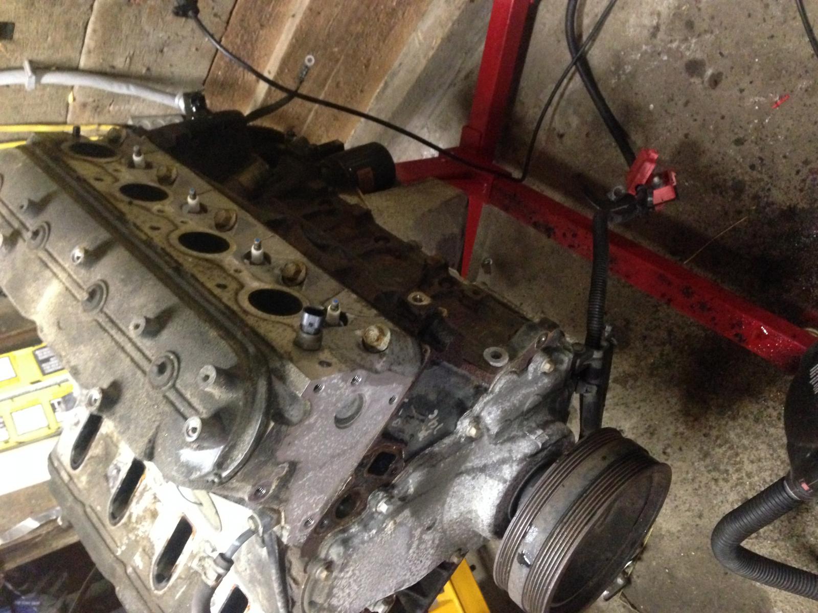

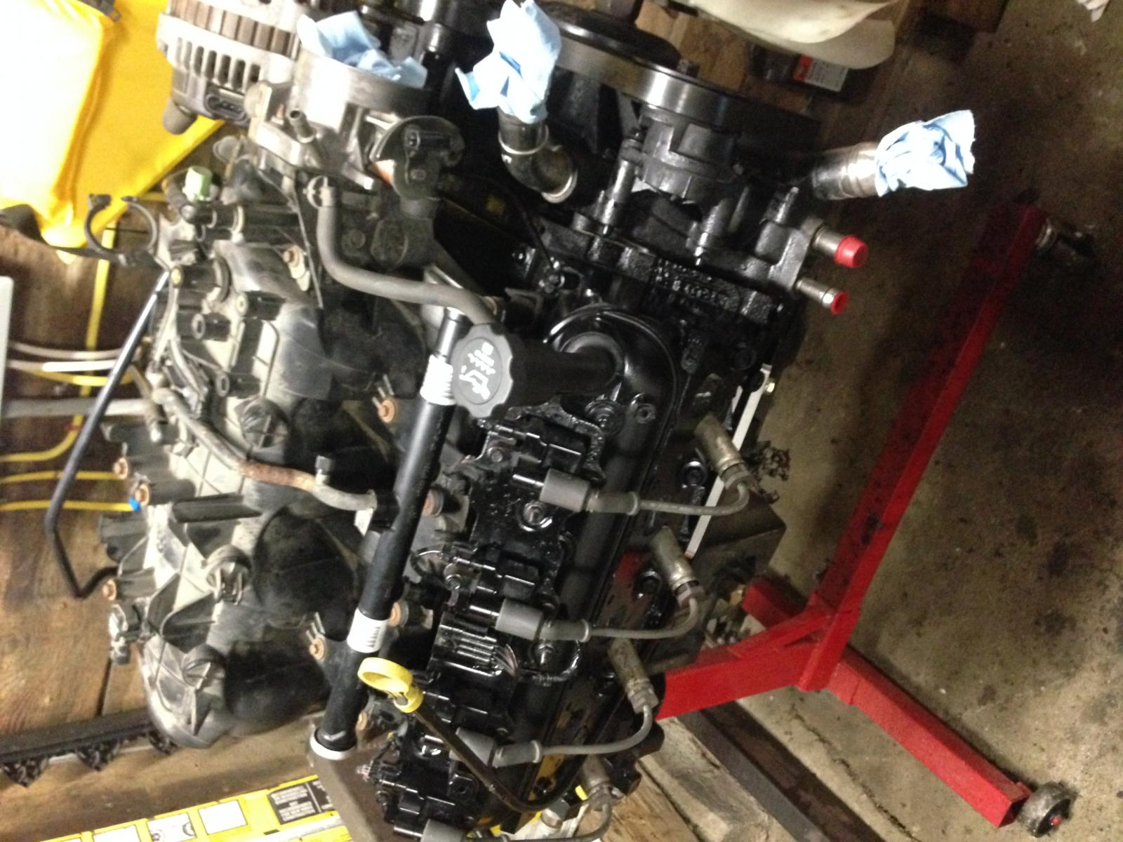

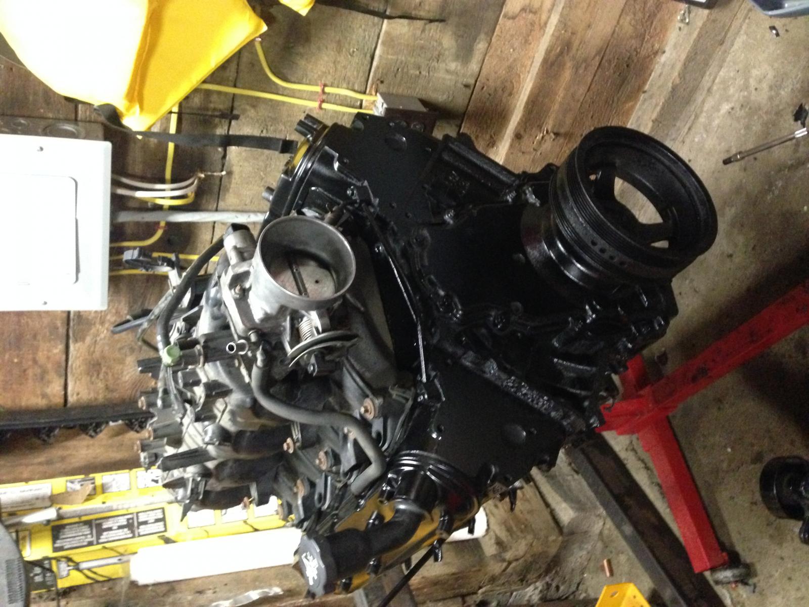

      last weekend i had some time to pull the motor again, install the new flex plate, and repaint the entire engine bay. that was bugging the crap outta me. This weekend I'm gonna try to bang out the rest of the wiring, trans crossmemeber and cooling lines. start-up hopefully over christmas break!! does anyone know how to insert images so they're smaller on the thread..?
Size:  229.9 KBName:  IMG_4940.jpg
Size:  188.1 KBName:  IMG_4945.jpg
Size:  208.3 KBName:  IMG_4818.jpg
Size:  189.6 KBName:  IMG_4946.jpg
      "Never let anyone tell you how to live your life, the only way to be happy is to follow your passion"
      1972 Chevelle SS clone
      1968 Caramro RS--in the works
      2013 Silverado 2500HD Duramax Z71 appearance package
      Sep 2013
      Lexington, Mass
      96
      Quiet an eventful weekend besides the 2 feet of snow.. Basically got a ton of little things finished up: 98% of my wiring is done. Just need to order gauges and hook them up. Got all of my trans lines plumbed. Got the rear end and fuel tank finished up so it's setting on its own weight again.
      Then what made it eventful... I was putting on my starter and somehow got a cracker plastic housing on it without realizing so when I torqued my 12v terminally it snapped off.. Great now a new starter. Then, I installedy trans cooler on my radiator and apparently the fasteners they supply puncture the radiator! When I filled it up it was leaking from there so now a new radiator... (If any one is getting rid of one let me know).
      So where I'm at is waiting on a p.s pump, starter, looking for a radiator and my headers will be in next week. Then I'll be ready to start her up. Oh how could I forget, a drive shaft haha. God this weekend took it's toll.
