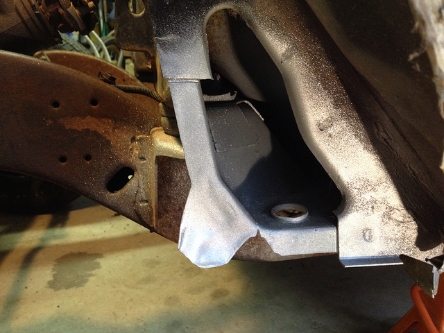

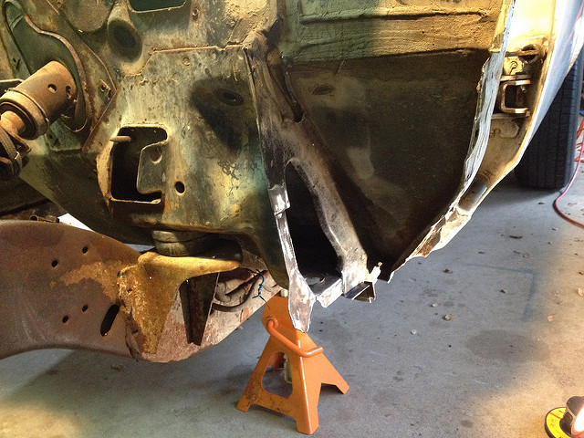

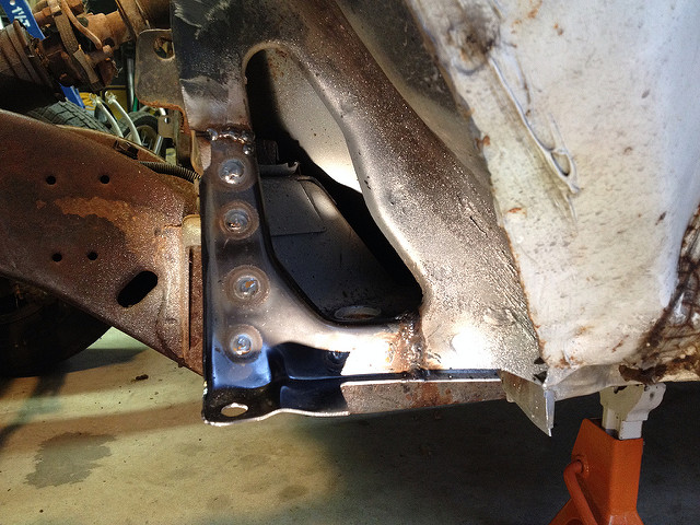

      Okay, finally got back in the garage. First, moved the car in to the garage (this is when Texas winter starts getting nasty) Cut out the crusty part of the left kick panel support and replaced it. The patch was (as expected) a little different than original, so some modifications were necessary. Cold galvanizer (weld-through), plug welds. Smoothed out the welds pretty nice, but I'll get a shot after its all smoothed out.
      Here's the prime time drama cliffhanger for the next entry (cue the urgent violins)

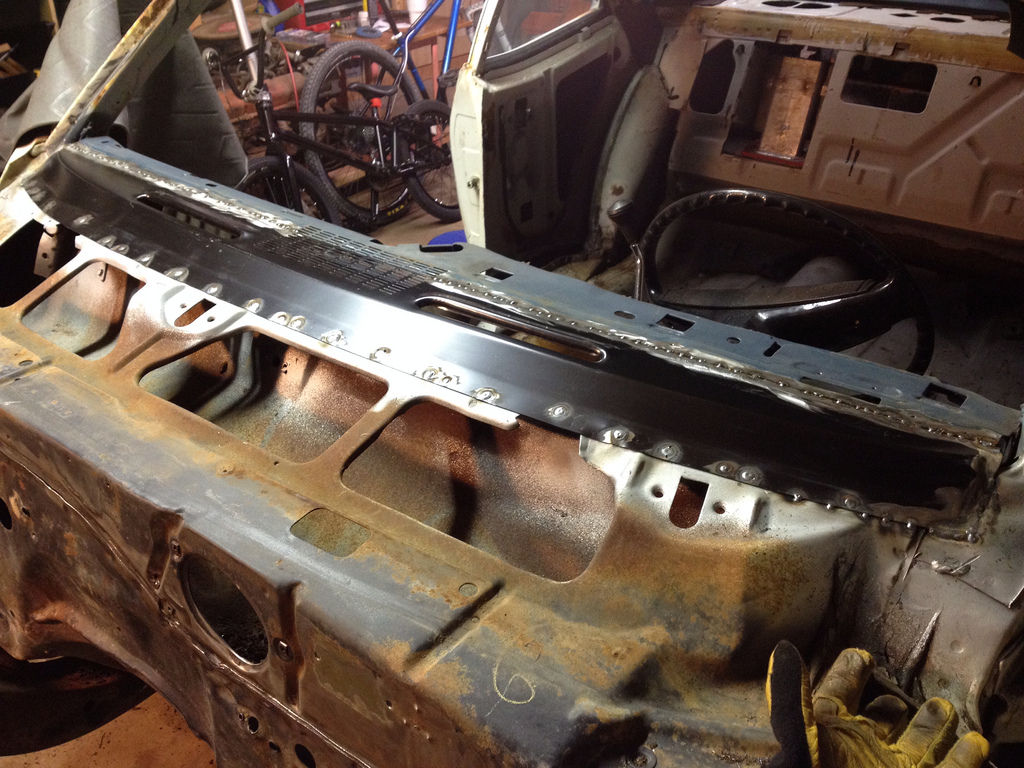

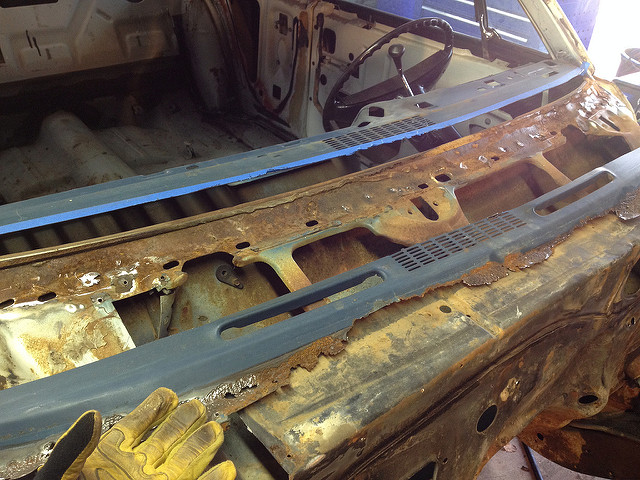

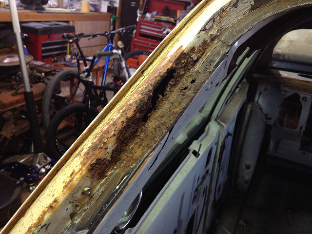

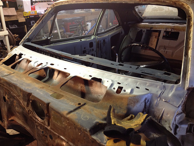

      Ok back in the garage. Decided to skip the passenger kick panel support for now (the pocket bottom inside the KPS is pretty crusty and will have to be rebuilt. Plans are to use what I need from the other patch panels and utilize the scraps with optimum shapes) So on to the dash panel.
      I popped the WS reveal moldings off the front and rear glass to find some more holes :l The windshield came out in one piece, luckily, as it has a top to bottom crack on either side. I feel like this spot can be replaced fairly easily with sheet metal. I've also decided on flush mounting the new windshield.
      After the dash panel spot welds were ground out, I found that the upper cowl panel was still in good shape.
      Here's the panel all tacked in. I'm gonna cut the speaker grille out and put a solid patch in there. Also, the passenger side of the dash was broke loose (spot weld) at the a-pillar, so I gotta sew that up when It's time to finish welding the patch.

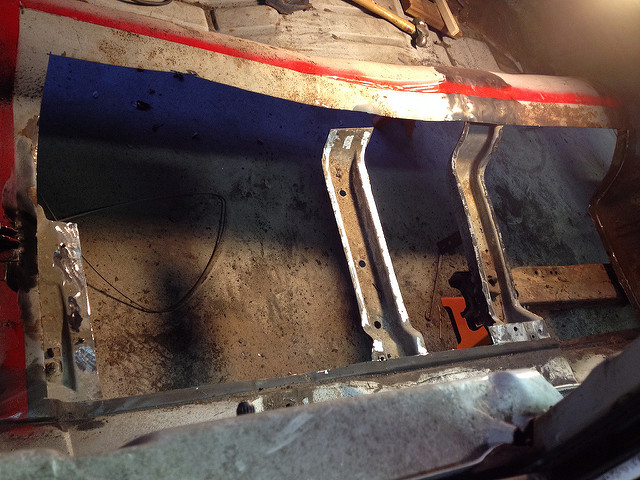

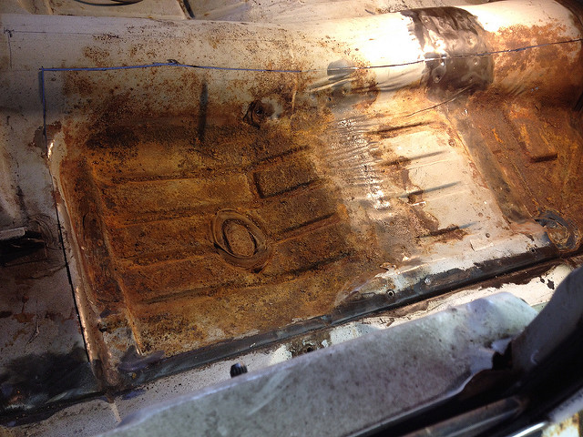

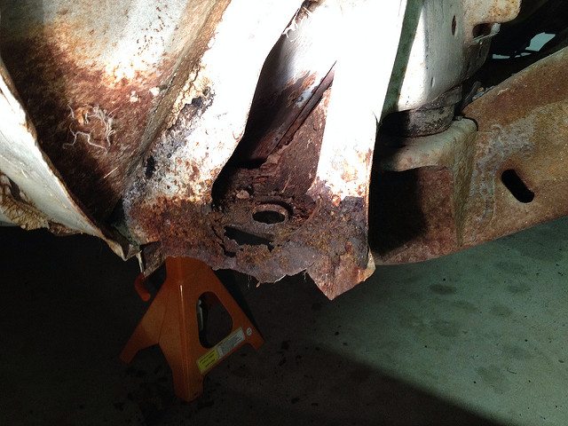

      Tackled as much of the floor pan as possible before it got too cold. Looks like a soda was spilled on this side of the car. I know modern sodas will eat through egg shells, plus the window crank knobs are all sticky. So if you spill a soda in your car, pull the carpet up and clean it out real good or you'll be lookin like Fred Flintstone #protip
      After the second picture, I laid a tape line and cut the flange back to about 1.25", lapped the panel in, and fixed it down with sheet metal screws to keep it square for welding. I guess I could have cut it flush and butt welded it, or even pulled the entire floor side out, but I felt like separating the floor from the rocker etc would be a mess and I didn't want to risk tweaking the cab. I also didn't want to pull the old floor out and find that the new panel doesn't fit right. I think this will be a nice solid repair. I'll go in with a body hammer and knock the panel down flush to the braces and tunnel before I get to spot welding.
