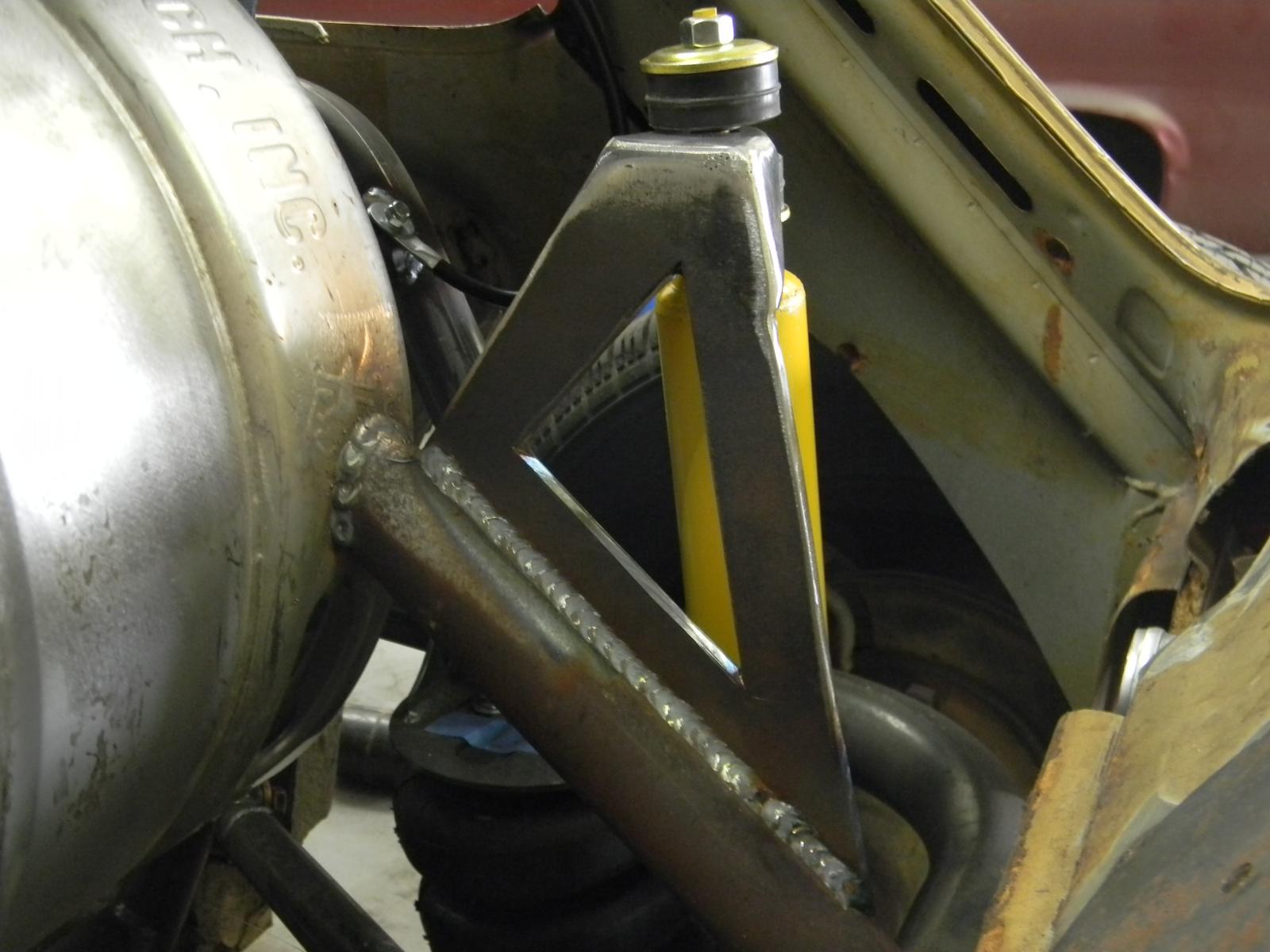

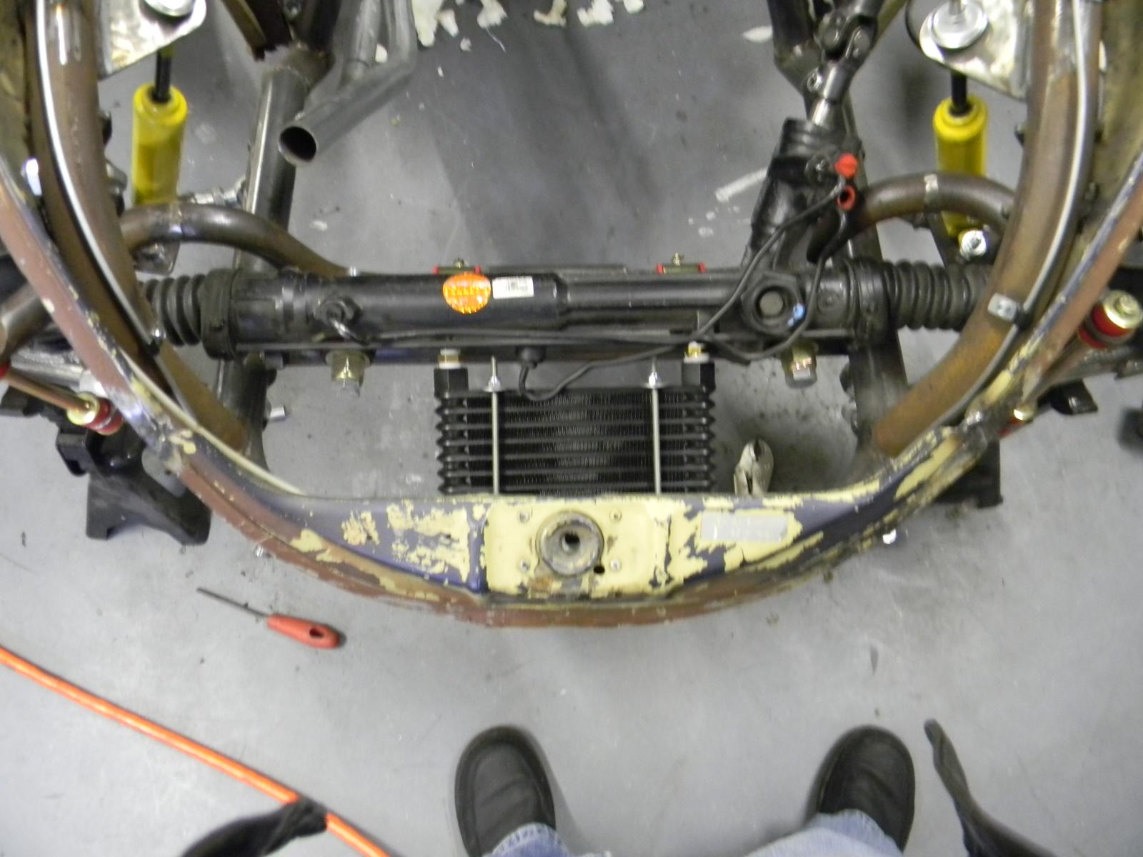

      Here are a few more random ones. I've been trying to keep all of these in order but I've totally lost track of what time frame I was at when they were taken. The steering wheel is made out of three BOSS 302 connecting rods (sorry ford guys) and a Mercury outboard forward pinion. Pinto rack and pinion and a chopped up sway bar. I've caught a lot of flack about cutting up the sway bar and welding it back together from all the "know it all's" at car shows but I've been driving the piss out of this thing for a while and its seems to be doing it's job and holding up just fine.
      Name:  bug shock3.jpg
      Name:  bug steer.jpg
      Name:  bug wheel.jpg

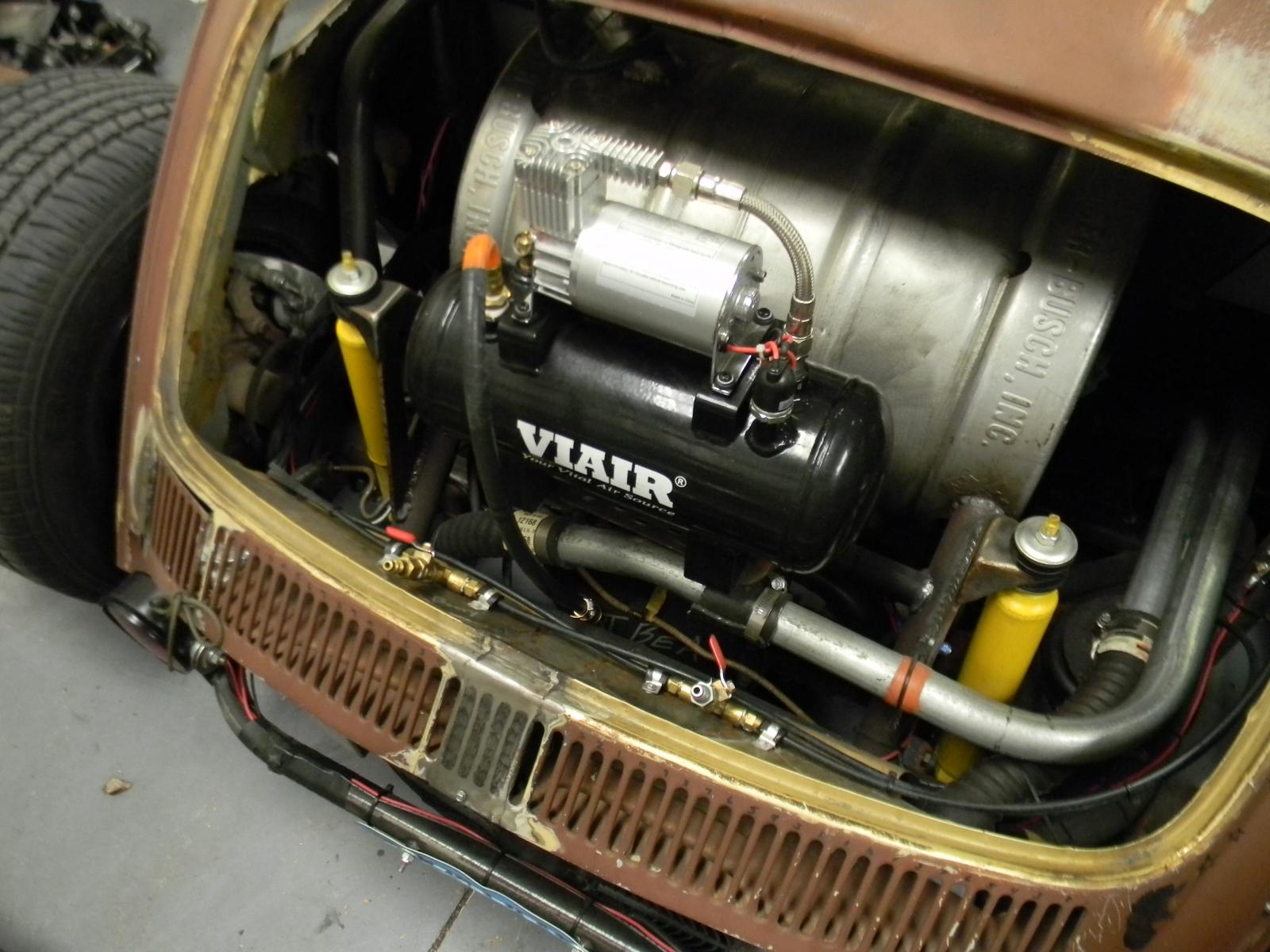

      Ran into issues with battery placement. It was either behind the passengers head with a very small battery or between the passengers legs with a regular sized optima. Some potential passengers might have had a problem spreading their legs for a big piece of plastic (the battery guys, come on) so I went behind the head with a mount from ballistic fab. Its the same battery that starts a Prius engine. That's as close as I can get to going green.
      No place for a battery means serious problems with mounting a compressor and tank for the bags. I found a 1.5 gallon tank and a Viair compressor that sorta sticks up out of the back window area. The tank will allow me to get to ride height one time without running the compressor. Its a compromise but it works. Manual valves.

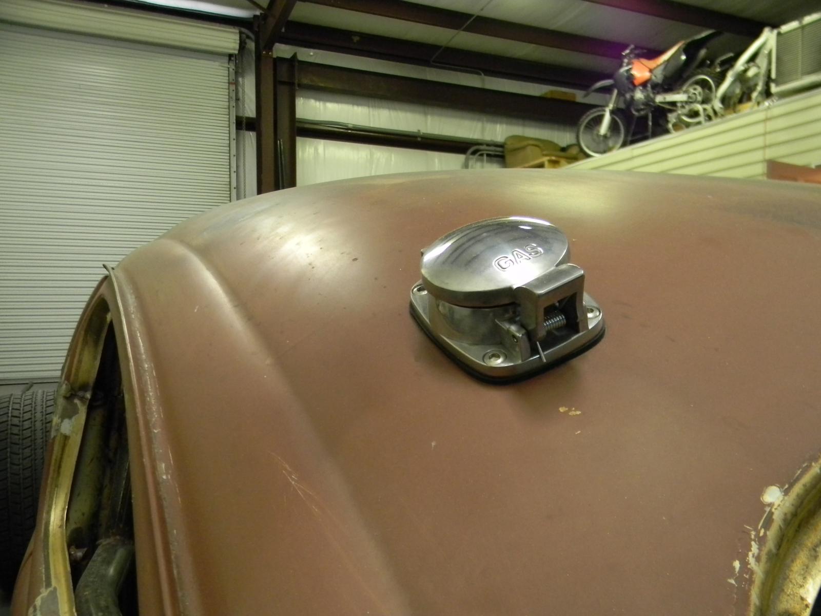

      A cobra gas filler cap left over from another project found its way onto the roof. For some reason I get funny looks when I pump gas into the top of the car.

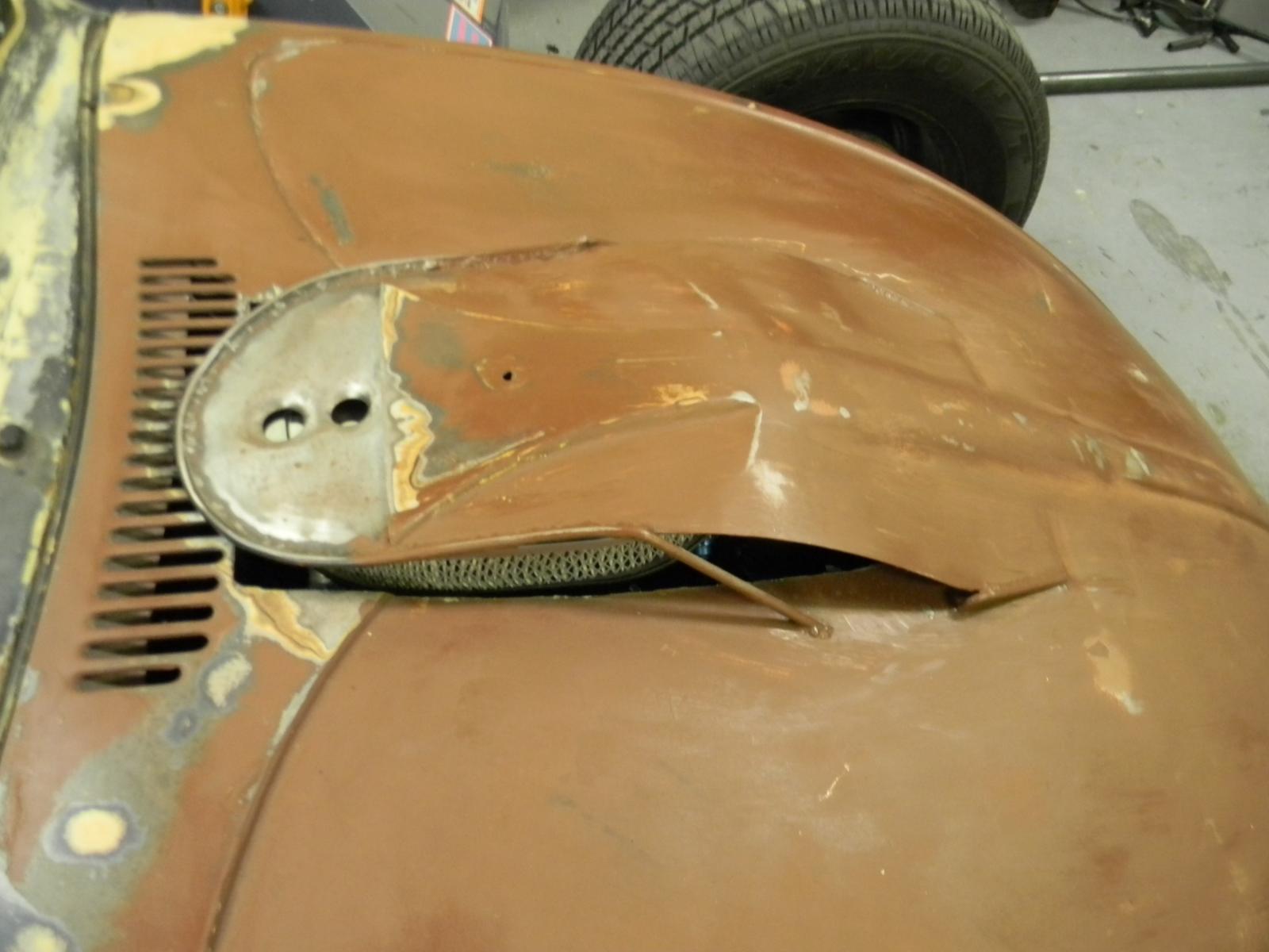

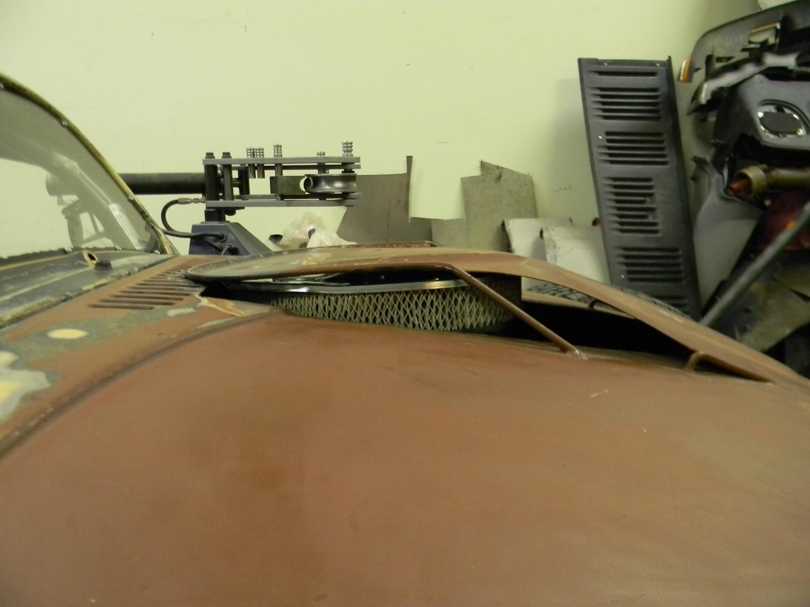

      I figured that at some point the hood would need to go back on. It wound up turning into a lift off style hood. Two pins push into the cowl and then the factory latch catches at the front. The goal initially was to keep everything under the hood but that's usually tough to accomplish when putting a V8 in what was designed to be a trunk and impossible in this situation.
      Plan B was to make the hood look as factory as possible. I'm still not satisfied and usually drive around without the hood.
