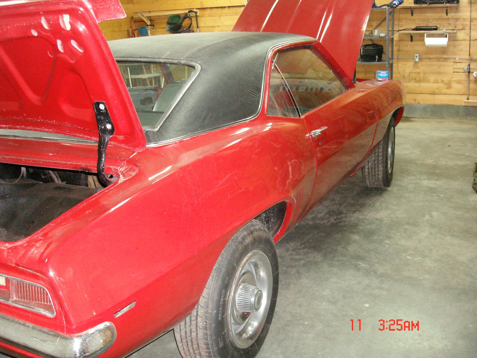

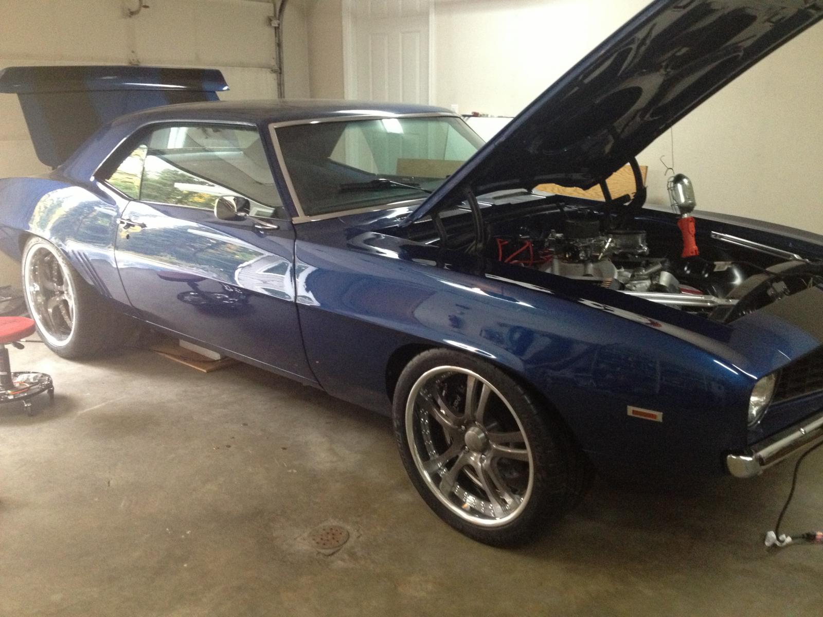

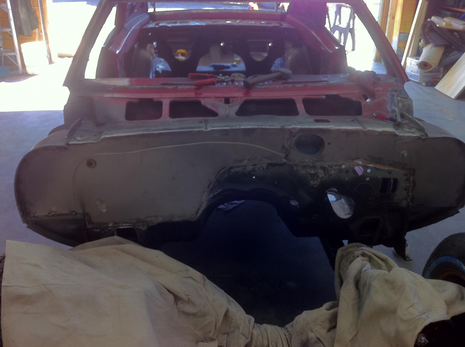

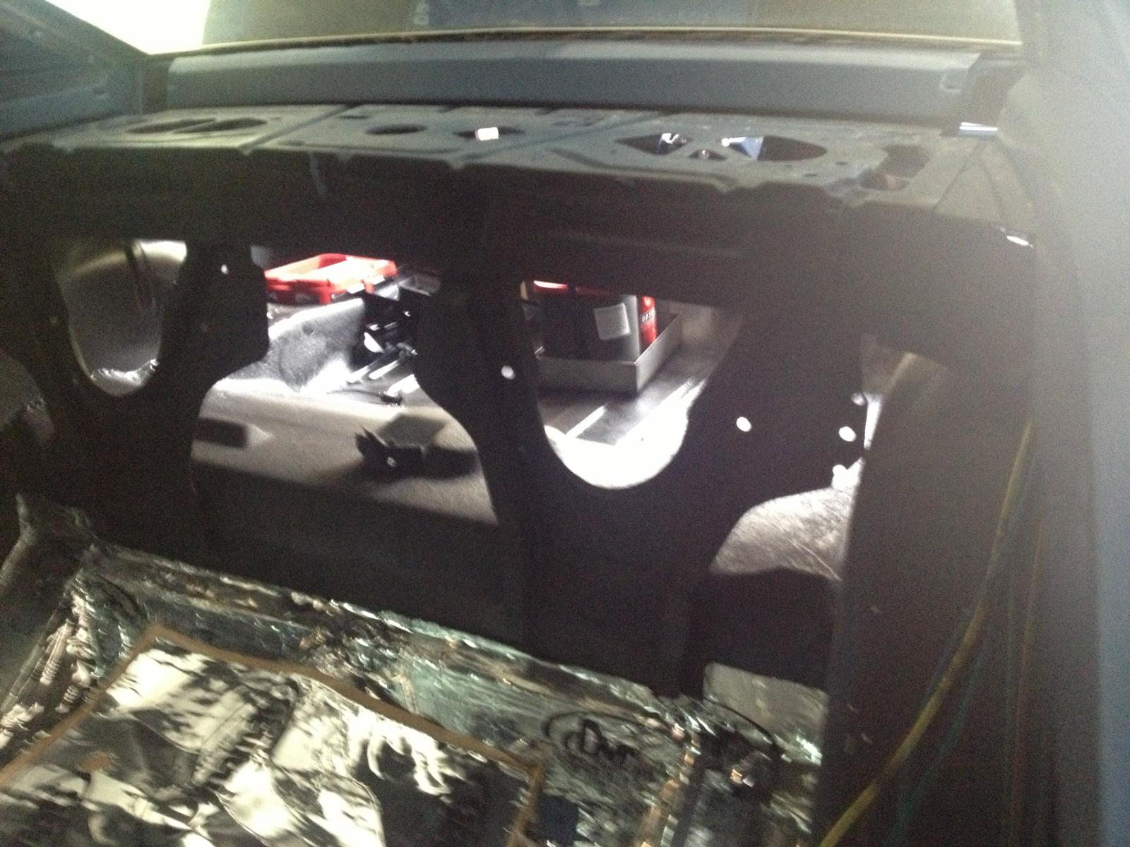

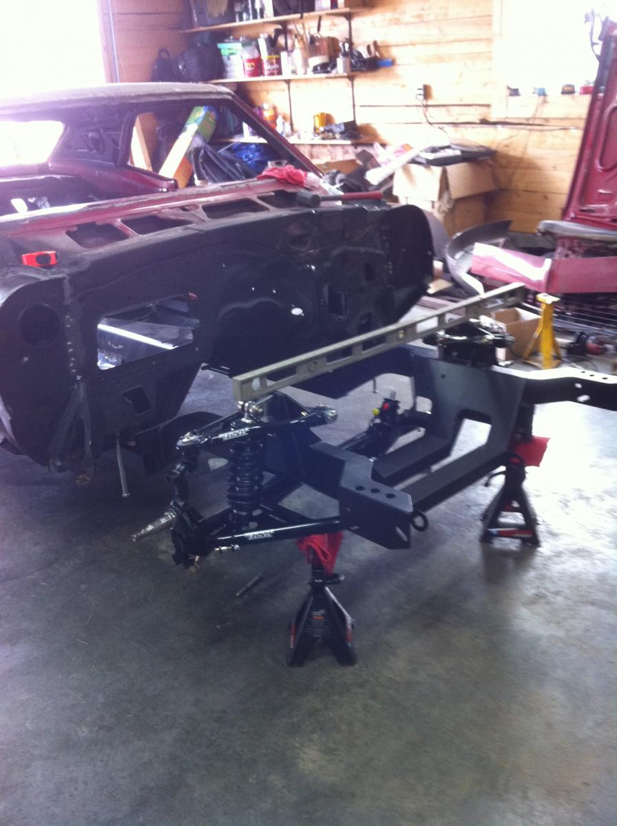

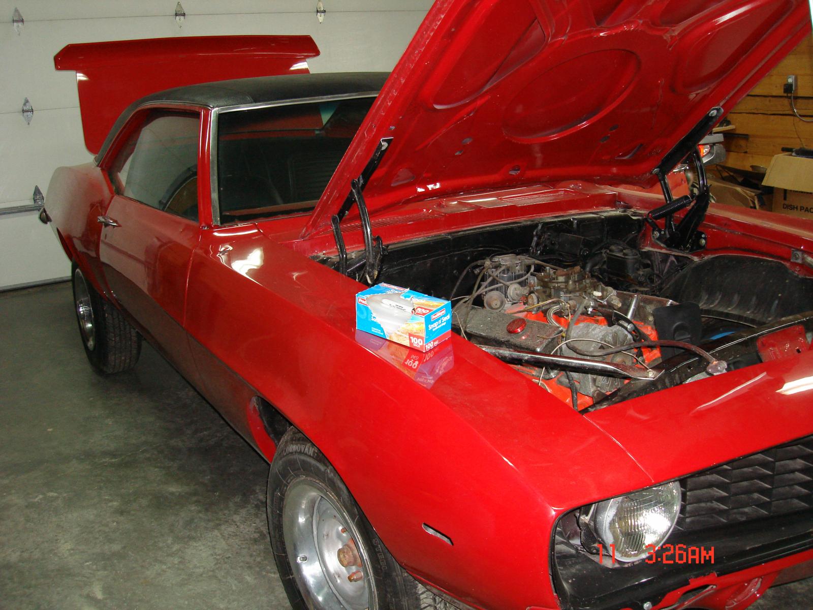

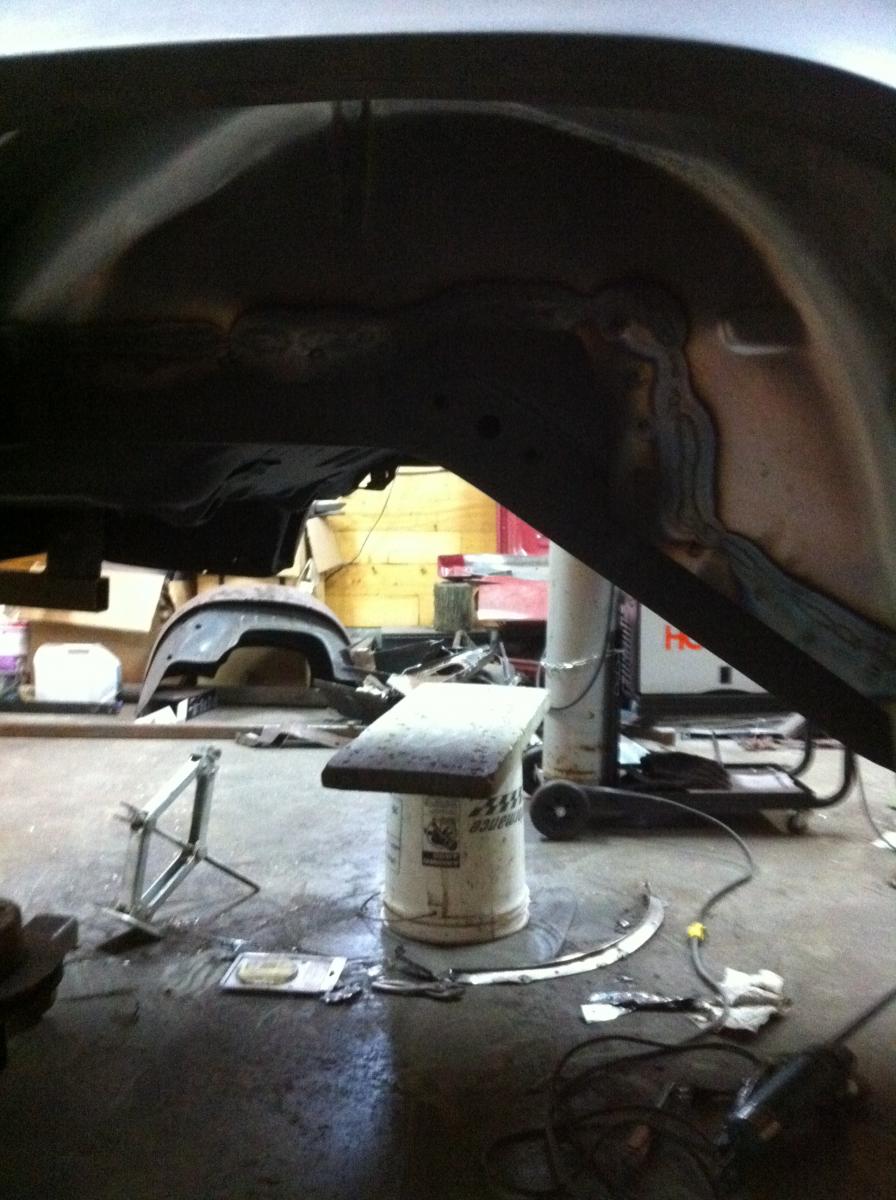

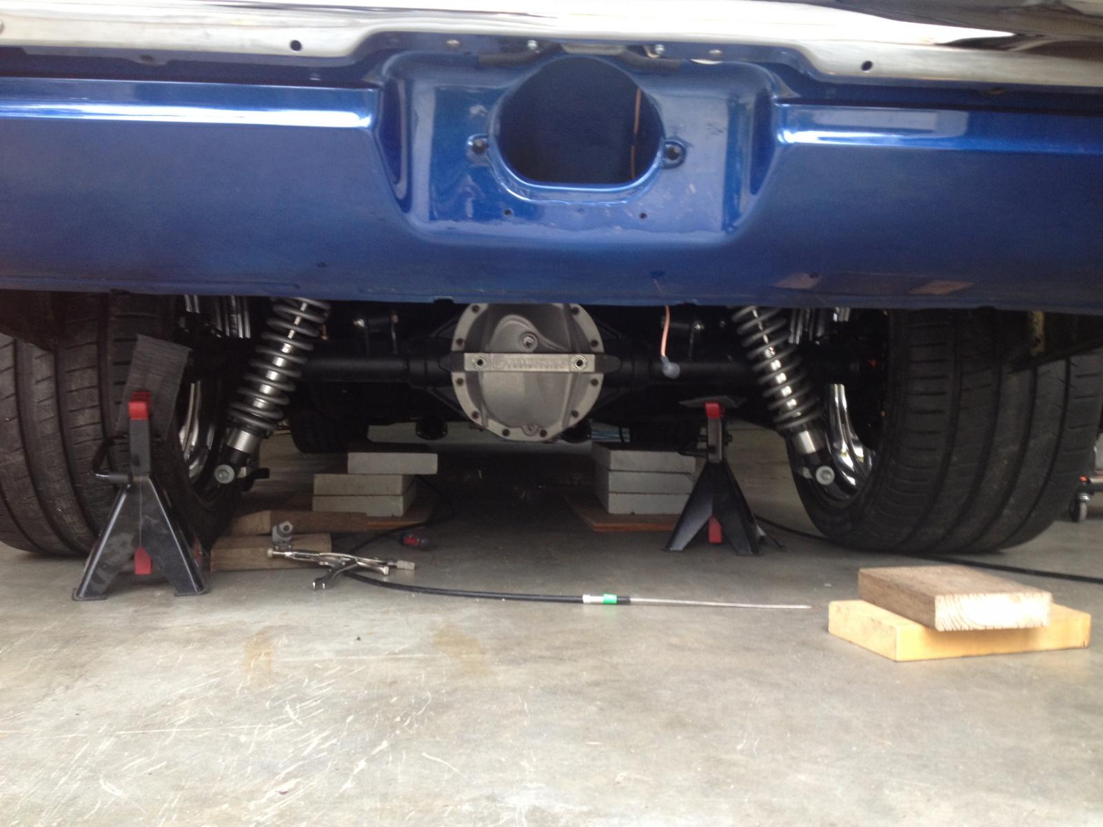

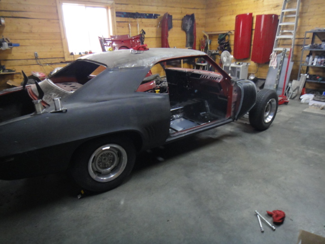

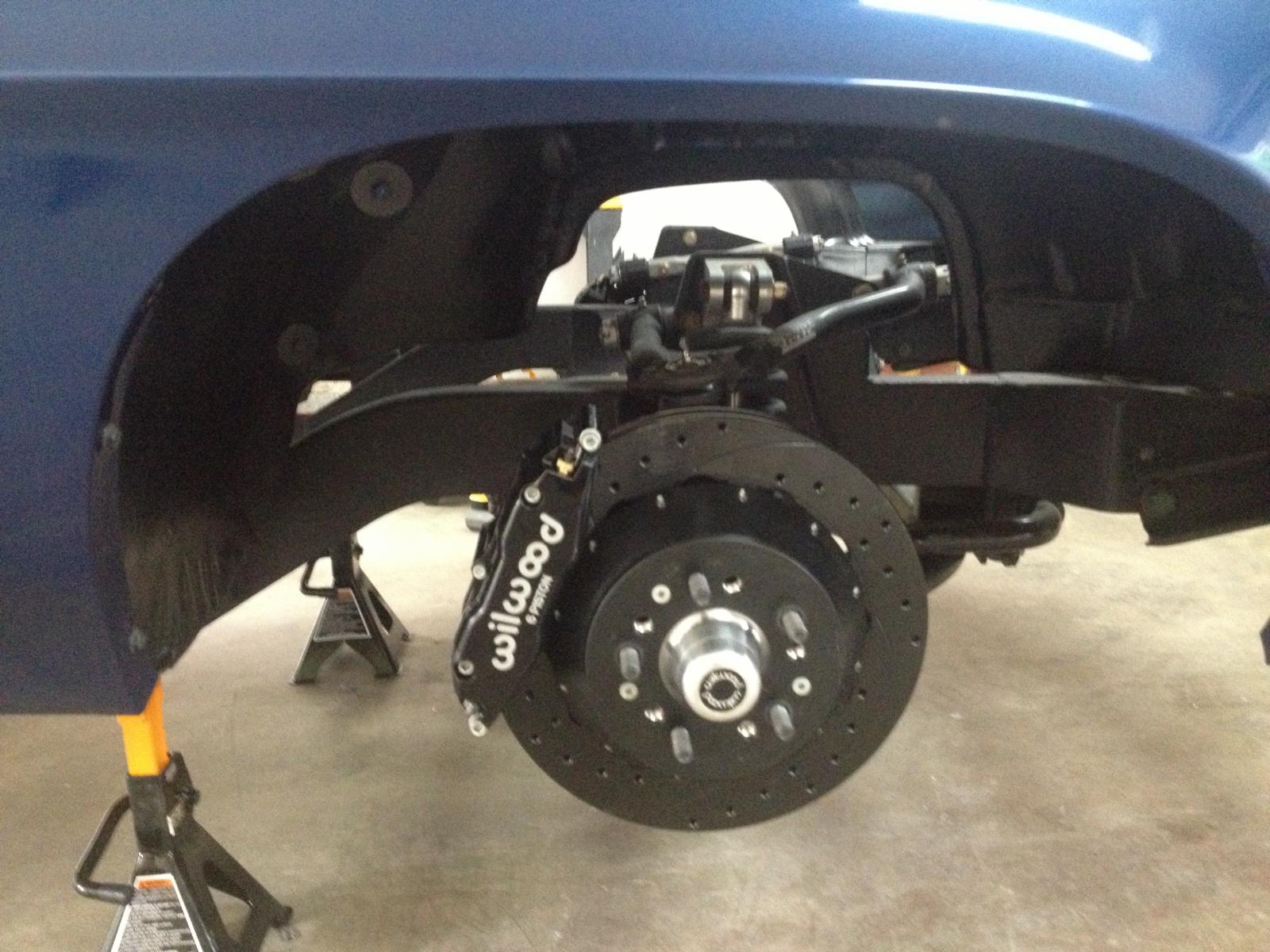

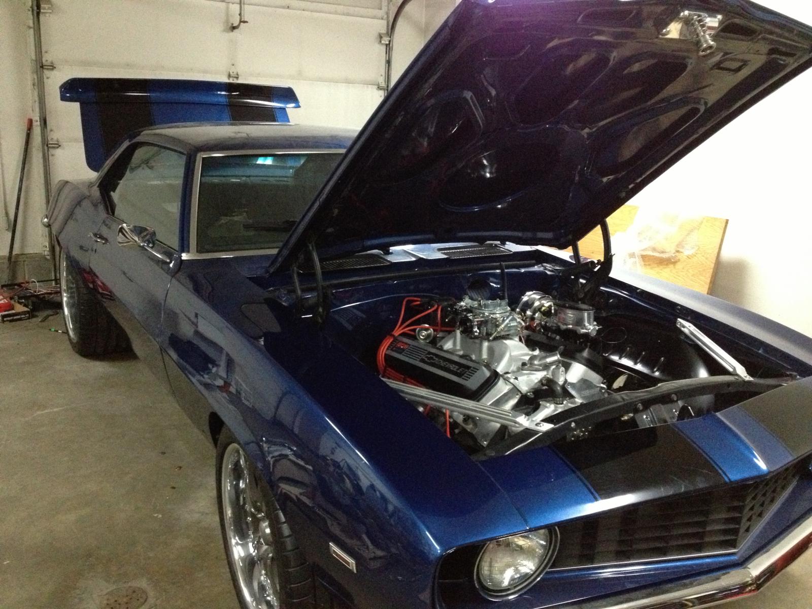

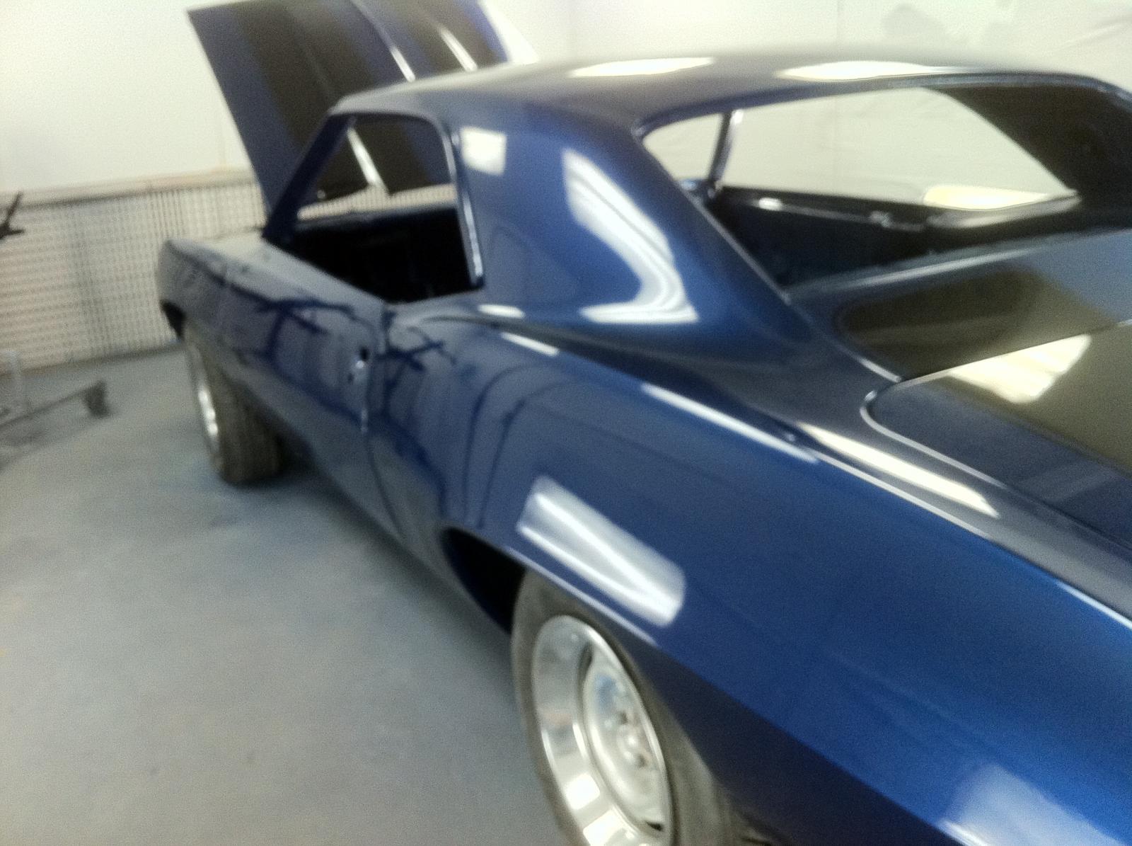

      Just wanted to show a 69 Camaro Alaska Build. All I can say is I'm jealous of lower 48 shipping costs and the amount of support that are down there. Not much help up here for this kind of build. My one year project that turned into three years and still going. I have had lots of help and questions answered from many sponsors on here. Wanted to say thanks to Frank from Prodigy Customs ( I know lots of people had issues with him but he took good care of me), Roger and Jay from Speedtech Performance, and Jason Rushforth from Rushforth Wheels. They are many more but can't name them all. I still have a lot of work to do and a project in the making. Thanks to all that's helped with guidance and suggestions. Here are a few pictures from start until now. Name:  iphone pics 525.jpg

      Beautiful build. Details on suspension, motor, body mods, etc.
      May 2010
      33
      Started in the summer of 2010. As for the hardware:
      ZZ502 Power Plant
      Husrt-Driveline T-56
      DSE Tubs
      Moser 12 inch, 3:73 cogs narrowed 3 inches
      Proidgy bar on a 4 link
      Dakota Digital dash
      TMI interior (this winter)
      Rushforth Super Spoke wheels (19x9 (275/35R19) up front and 20x12 (335/30R20) out back on Michelin Pilots
      QA1 Coil overs
      PBS Blue paint with three coats of heavy clear
      BeCool Rad (this winter)
      Dual rear trunk batteries
      Smoothed firewall
      Vintage Air
      Spectra dual cold air induction.
      Wilwood slot and drilled 13" (6 Piston up front/4 Piston out back)
      Wilwood 1.12 in front of a 8 inch dual mounted to 6 degree brakets (17 degree to hard of an angle
      Copper/Nickel brake lines
      This is just a few of the mods and upgrades. Will post more pictures later. Just wanted to give some thanks to where they are owed.
