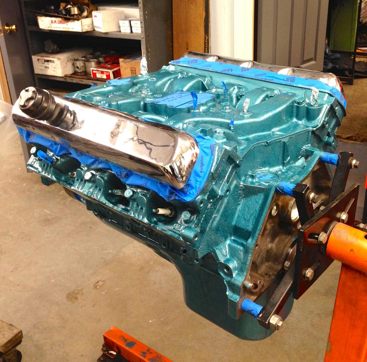

      Engine is almost done.
      I converted the 425 to hydraulic roller lifters, not as easy as it sounds as the 425 uses .921 dia lifters which required a cam with a reduced base circle
