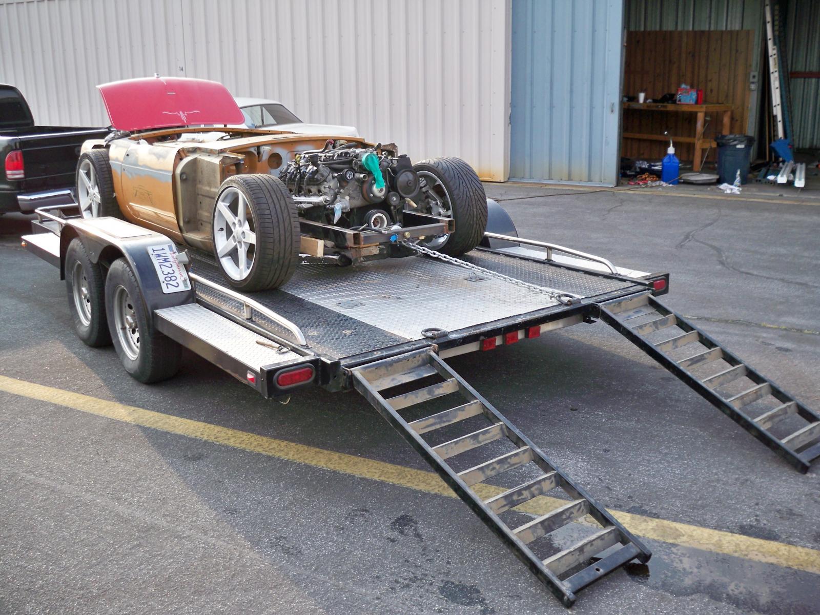

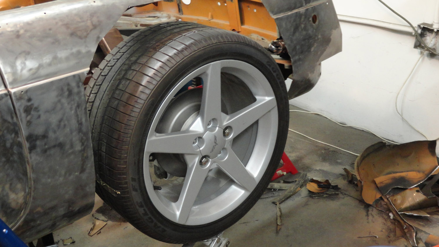

      Later-A-body - No offense taken. When I first had the plan for the car I built it around the C5 wheels I had. I was really trying to get the stance right. With the Corvette front suspension and Jag IRS in the rear with a tread pattern of the corvette I really wanted to have an autocross capable car. I plan on TRYING to break it as much as possible when its done.
      Basically I really wanted a widebody MG and sorry that my pic is on a trailer but here you can get an idea of the stance. I hope to run the New Forgeline Laguna wheels which had a vintage road race styling that I think will compliment the car well with the sized wheels during moch-up

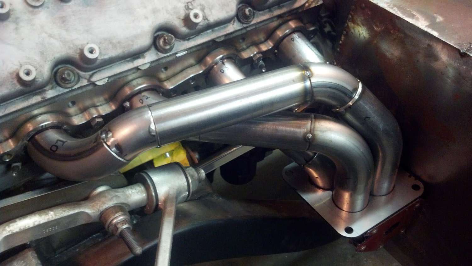

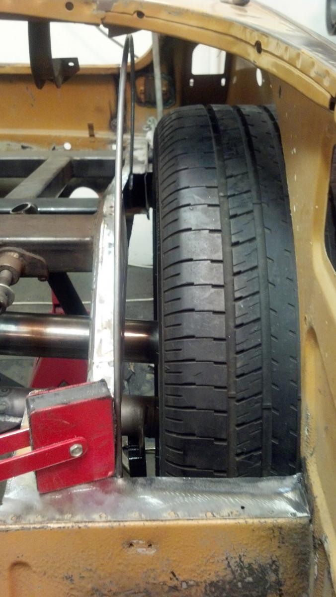

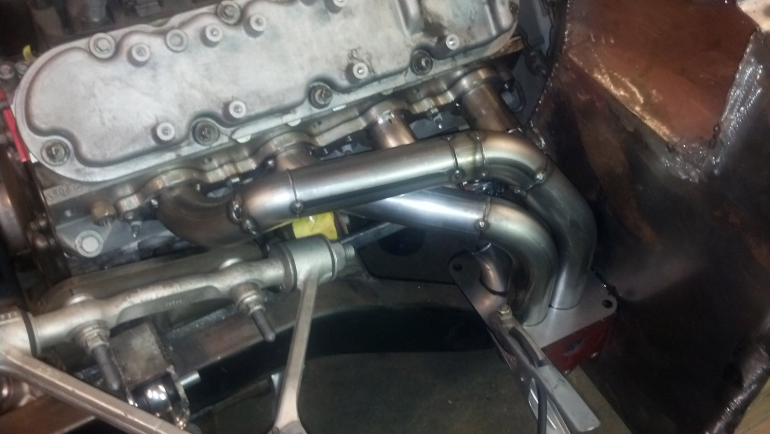

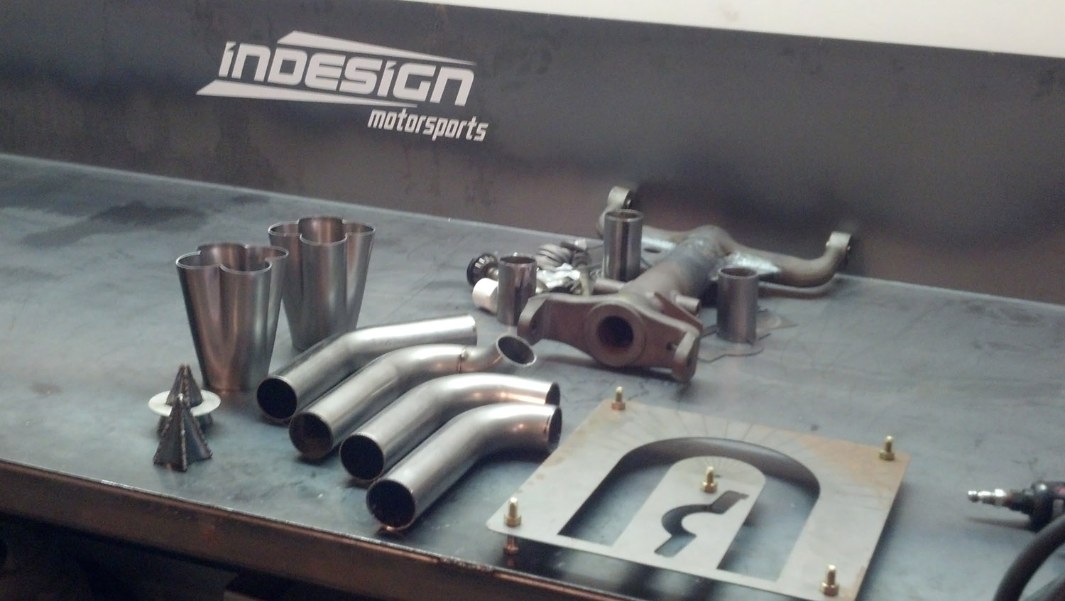

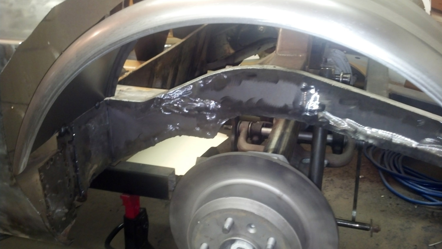

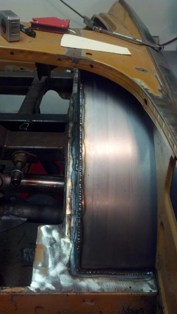

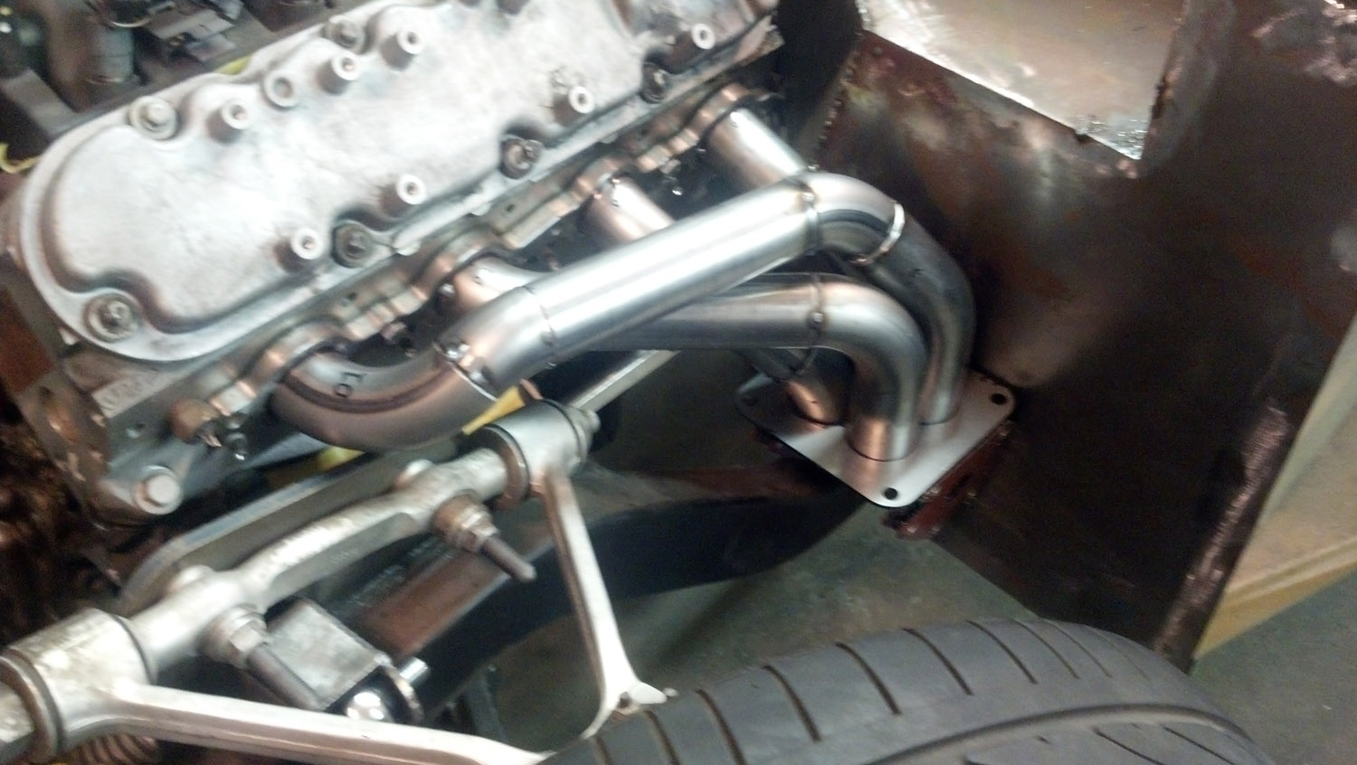

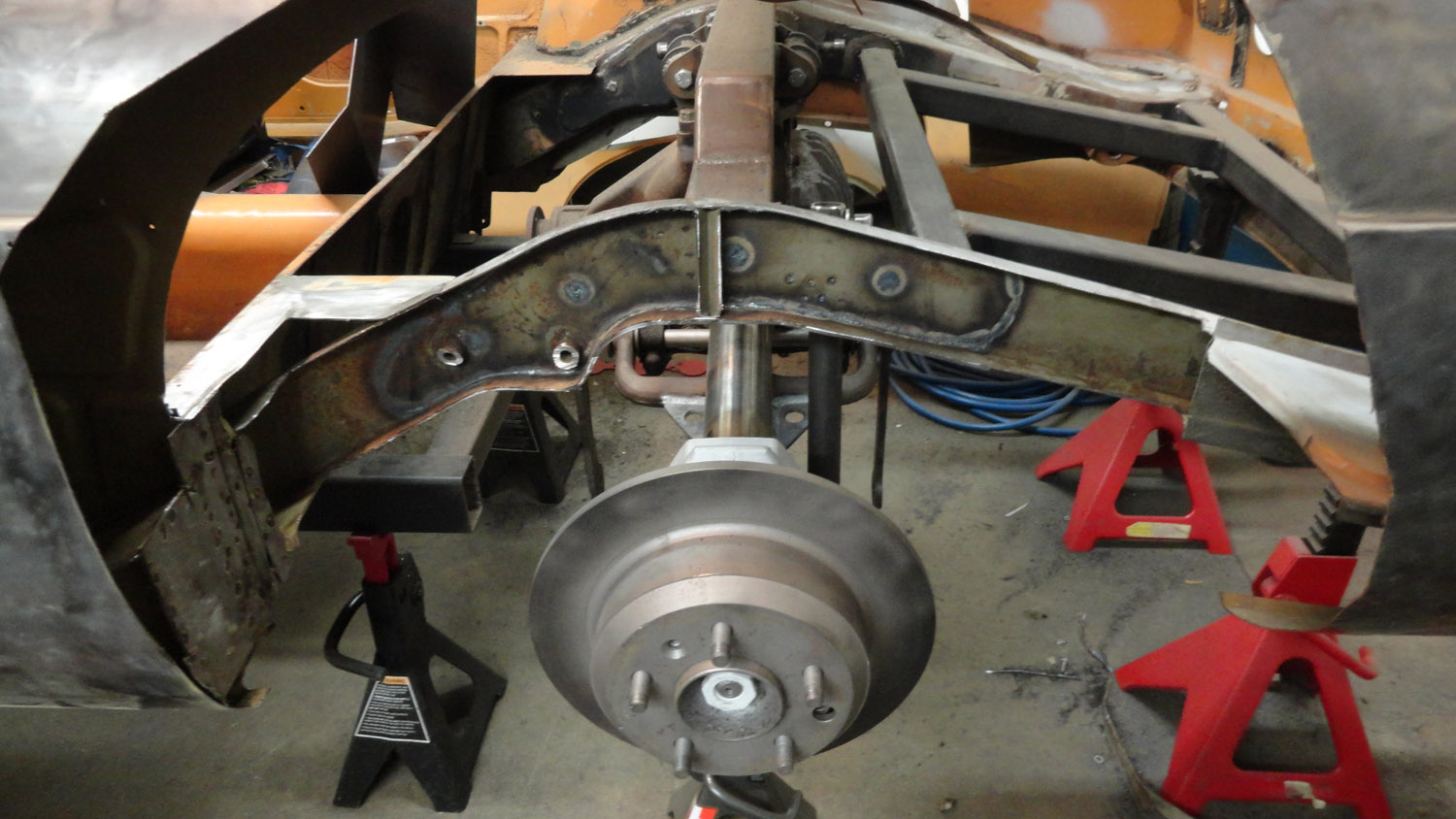

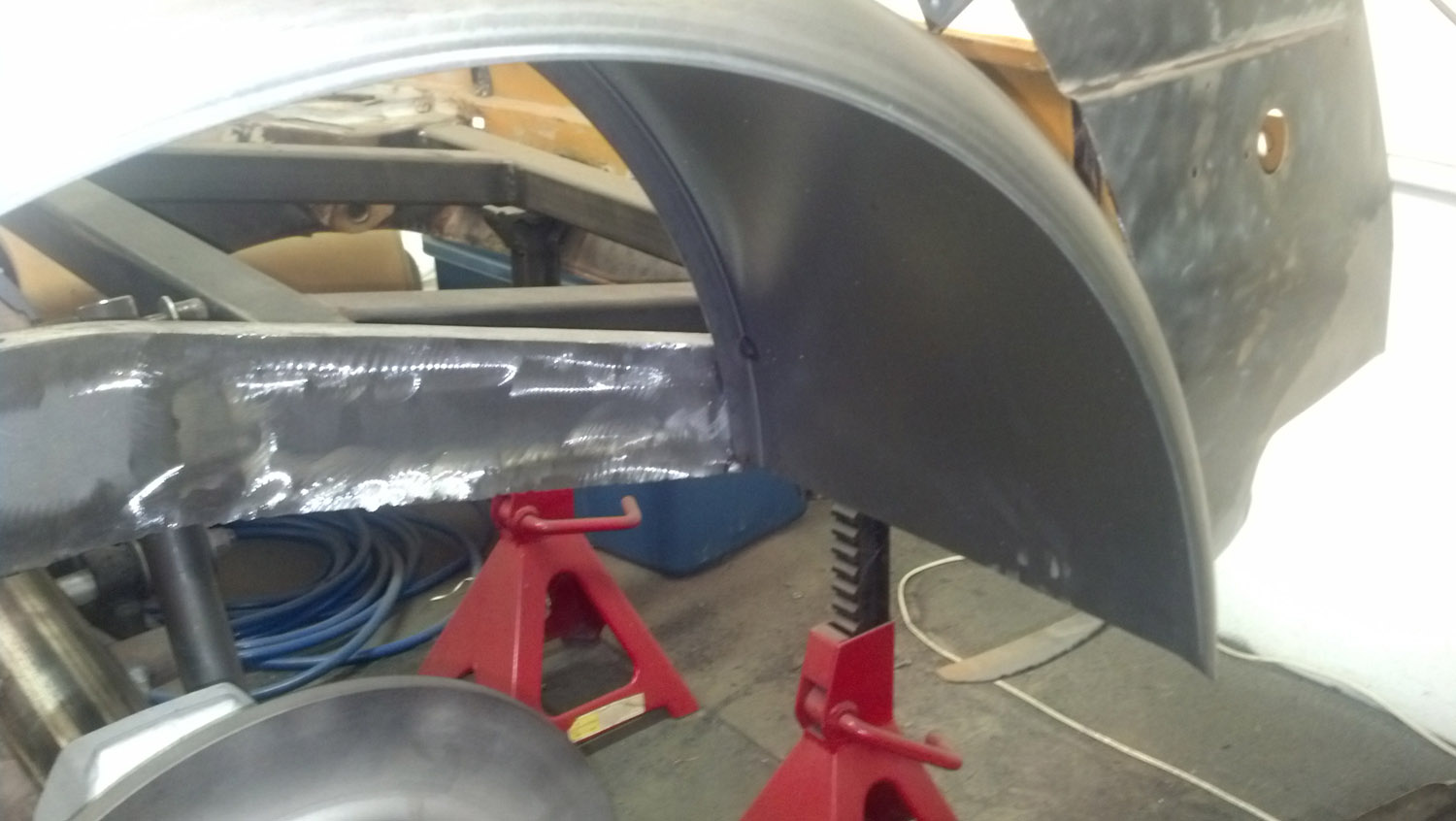

      More Updates

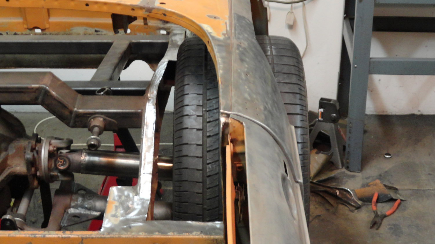

      Sorry I haven't updated this in a while. Life gets in the way sometimes.
      Here are a bunch of pictures of my header build and my rear wheel wells.
      You will notice I narrowed the rear frame rails then boxed them in again, I then fit in custom made 14 gauge trailer fenders to maintain the unibody structure and to keep the body super solid. I had already done a 1/4 plate on the inside of the frame rails to support the IRS crossmenber so there was no issues with anything moving or twisting when the old ones were cut out.
      There was a local company that custom makes any fenders to your dimensions so I used these fenders to keep the structure. Normal wheel tubs are 20 gauge where these are 14 super strong for me to use as a foundation for the rear fender flair design.
      The headers were mild steel 16 gauge 1 and 3/4 and were easy to build. I was not concerned with making them equal length since the car is already going to have stupid power to weight ratio. I'll keep posting pics as this moves along.
