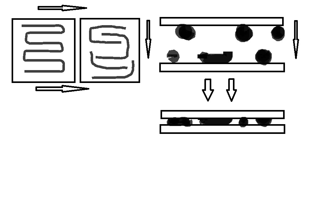

      One option: use rope in an "S" form on 2 sheets of fiberglass mat. Make the forms where when sandwiched together so the rope doesn't interfere. Then sandwich the 2 pieces together with some sort of adhesive.
      Something like these AWESOME MSPaint skillz
      Name:  fiberglass layers.jpg
