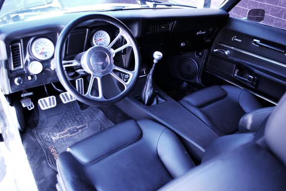

      Original interior, fairly nice so we'll be doing just a few minor upgrades here

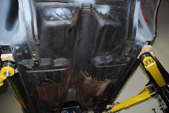

      While on the lift for suspension removal and minitub we had to do something about this ugliness too, WoW!

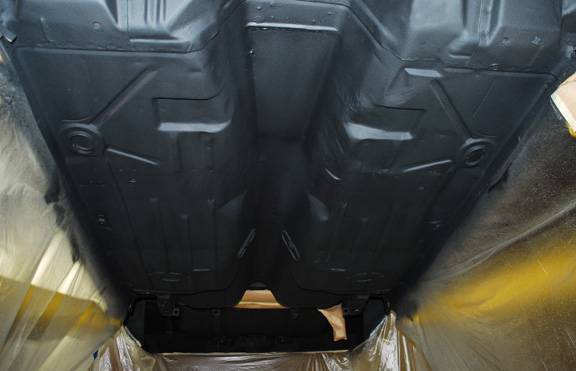

      After cleaning, stripping, a coat of epoxy primer and bed liner, it looks 100% better!

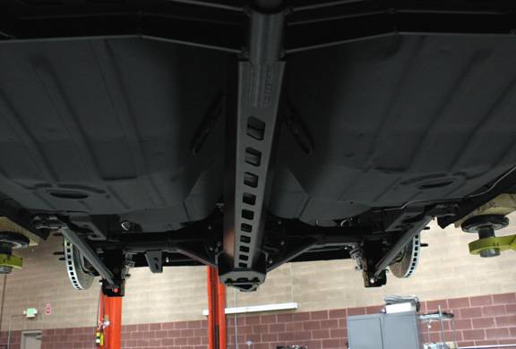

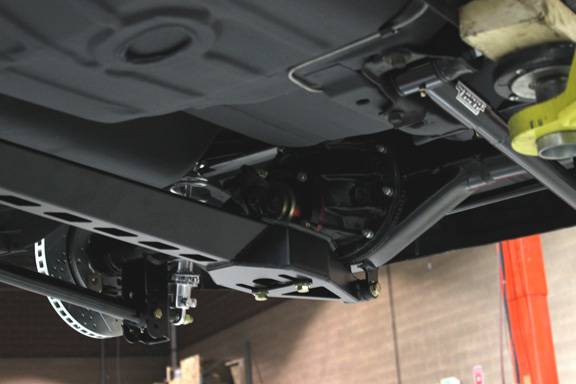

      Once the floor was ready we were able to get rolling on the rear suspension install

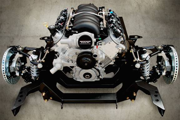

      Front suspension with LS3 and T56 mocked up in our sub frame. What a difference this will make over the way it was!

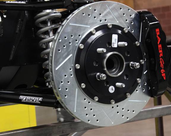

      Pretty cool when you can say your brakes are now the same size as the car's original wheels! lol!

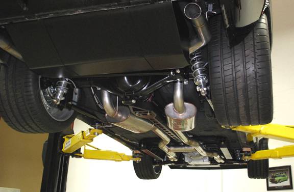

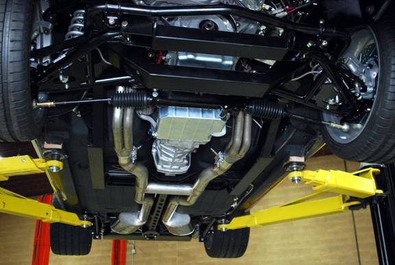

      Got the exhaust in the car. It's a 3" stainless custom build kit that we carry from Stainless Works. Looking good! Biggest thing we're waiting on now is our engine pulley kit which is on back order. By the time it gets here we should be have everything else all buttoned up and ready to roll!
      Notice how much ground clearance (compare to frame rails and trans) our custom designed headers have compared to most brands out there. A true pro-touring header for cars with a lowered stance.
