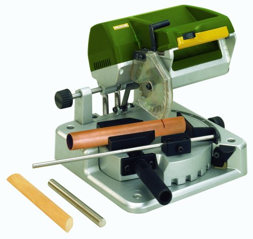

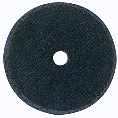

      Good afternoon gents.
      Going to make this a poll. Going to be flaring a few more stainless lines and would like to see what everyone prefers for cutting the tubing.
      OR

      Pipe cutter is what I always use

      But if you're bent on stainless steel (pun intended, lol), then cut it with a band saw or a hacksaw (none of the above) to avoid work hardening the end where you'll be flaring.

      I used a dremel cut off disk on a low speed to keep from work hardening stainless. No issues with leaks.

      Thanks for all of the responses. This isn't my first rodeo, but when I called Classic Tube to verify the stainless tubing I already had in my garage was annealed, the rep from Classic Tube went out of his way to tell me to use an abrasive cut off wheel instead of a tubing cutter. I have used both to varying degrees of success along with my Mastercool/Blue Point flaring tool to make double flares.
      This time around though, I am doing single flares for some AN fittings and will be using a Ridgid flaring tool. I thought it might fight me a bit more than using the hydraulic Mastercool and wanted to get everyones opinion.

      I tried it with cute off wheels and the leave it ragged, hacksaw same way.
      I deal is mini tubing cutter with NEW blade, make contact, turn once or twice to start the cut, then 1/4 to 1/2 turn tighter for every movement around tubing. Each batch cuts slightly different. Most steel or stainless should cut in 3 to 4 turns of tool at most.

      Tubing cutter is only correct way. In 30 + yrs never had a problem using one for Stainless, Aluminum, or Titanium. I have cut and repaired a lot of CRES and Titanium tubing on large commercial aircraft. With that out of the way and the ability to pull over it is probably not that big a deal to use a cutoff wheel. Also the lower pressures would mean you have more margins of strength.
