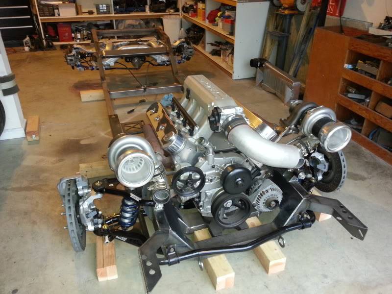

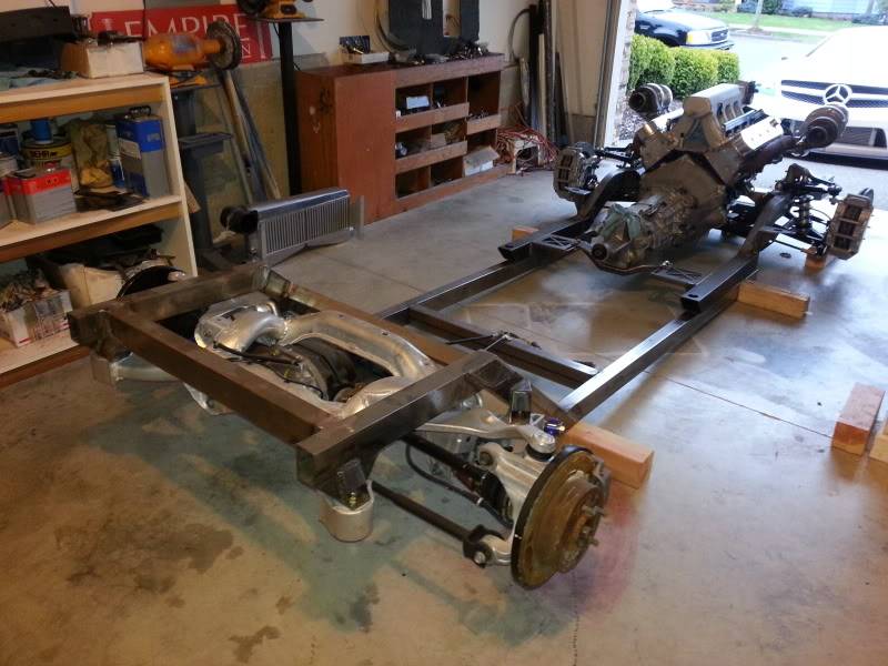

    13. #33
      beaverton oregon
      392
      pic of the speedtech. i am grafting it to a rear frame section i made to house the 350z irs. once i decided to do the rear frame and irs, i really had to get the speedtech front to get a good dimensional tube to graft to. but, the numbers did work out as mentioned in post above.

    20. #40
      Jul 2013
      St. George, UT
      1,144
      Quote Originally Posted by overZealous1 View Post
      Hey Scott, that's some cool stuff goin' on there!
