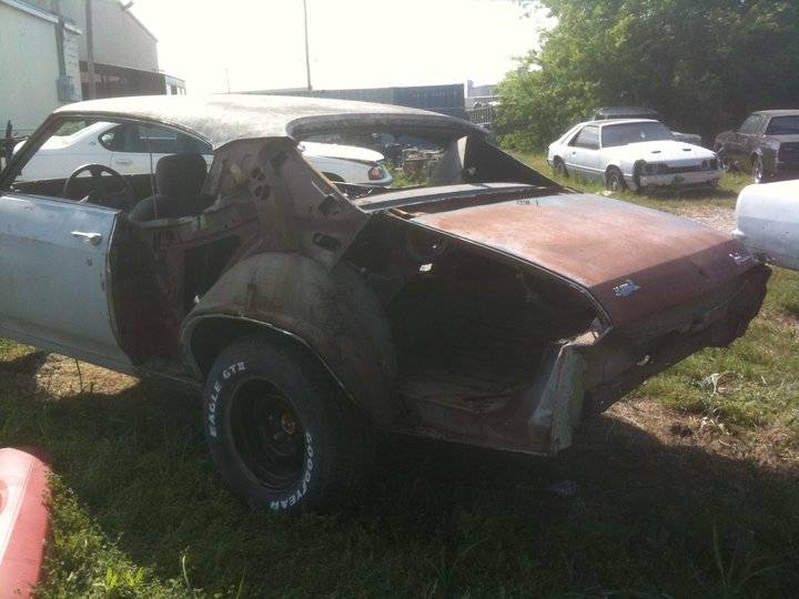

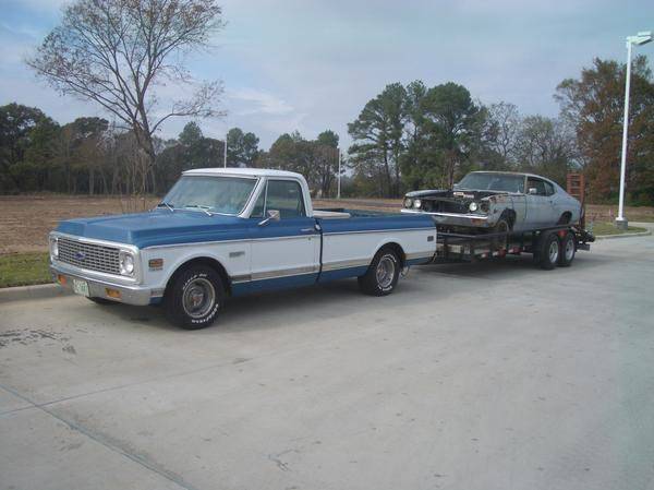

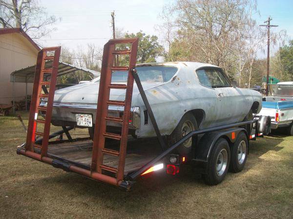

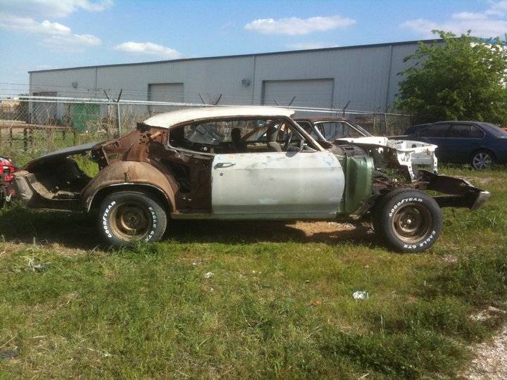

      I bought this car on eBay for $500 in November of 2007, I was 14 then. It was a rust bucket and was meant to be a "parts car." But, I saw the potential of what it could be! So, I snatched it and we drove 200 miles to pick it up!

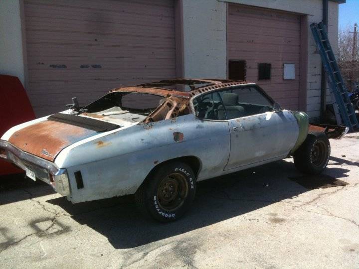

      We started on the bodywork and it needed A LOT of it!!!

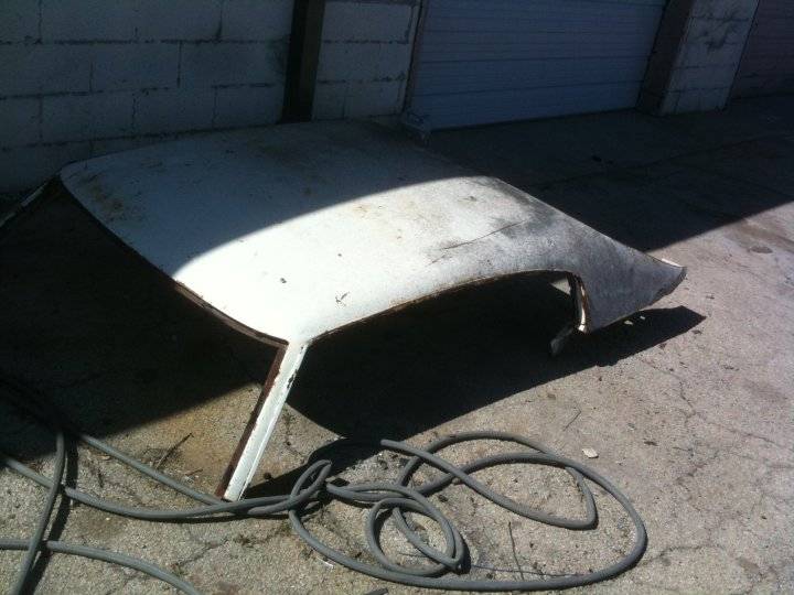

      This chevelle is a malibu that had a vinyl top! There was TONS of rust holes all around the roof! So, we cut the skin and bought a nice top off of a '71 chevelle for $100 (bought this before they started making the repro roofs)

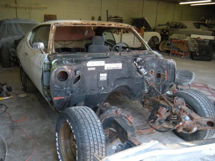

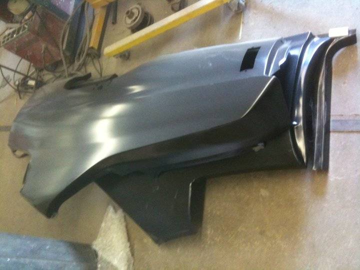

      We stripped the quarters and didn't like what we saw, so we went with the repro quarters.

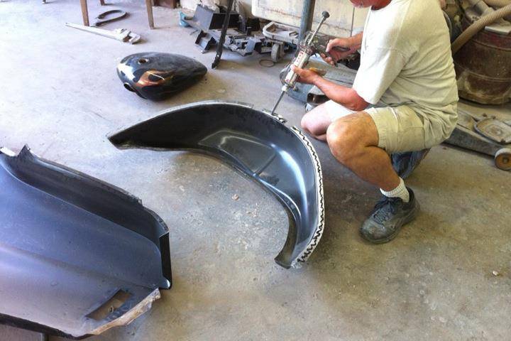

      After a lot of test fitting and getting the china quarters to fit correctly (kinda wish we just fixed the original quarters) we glued the inner fender wells and the quarters. The fenders were a mess, so I sold them for $400 and bought repros.
