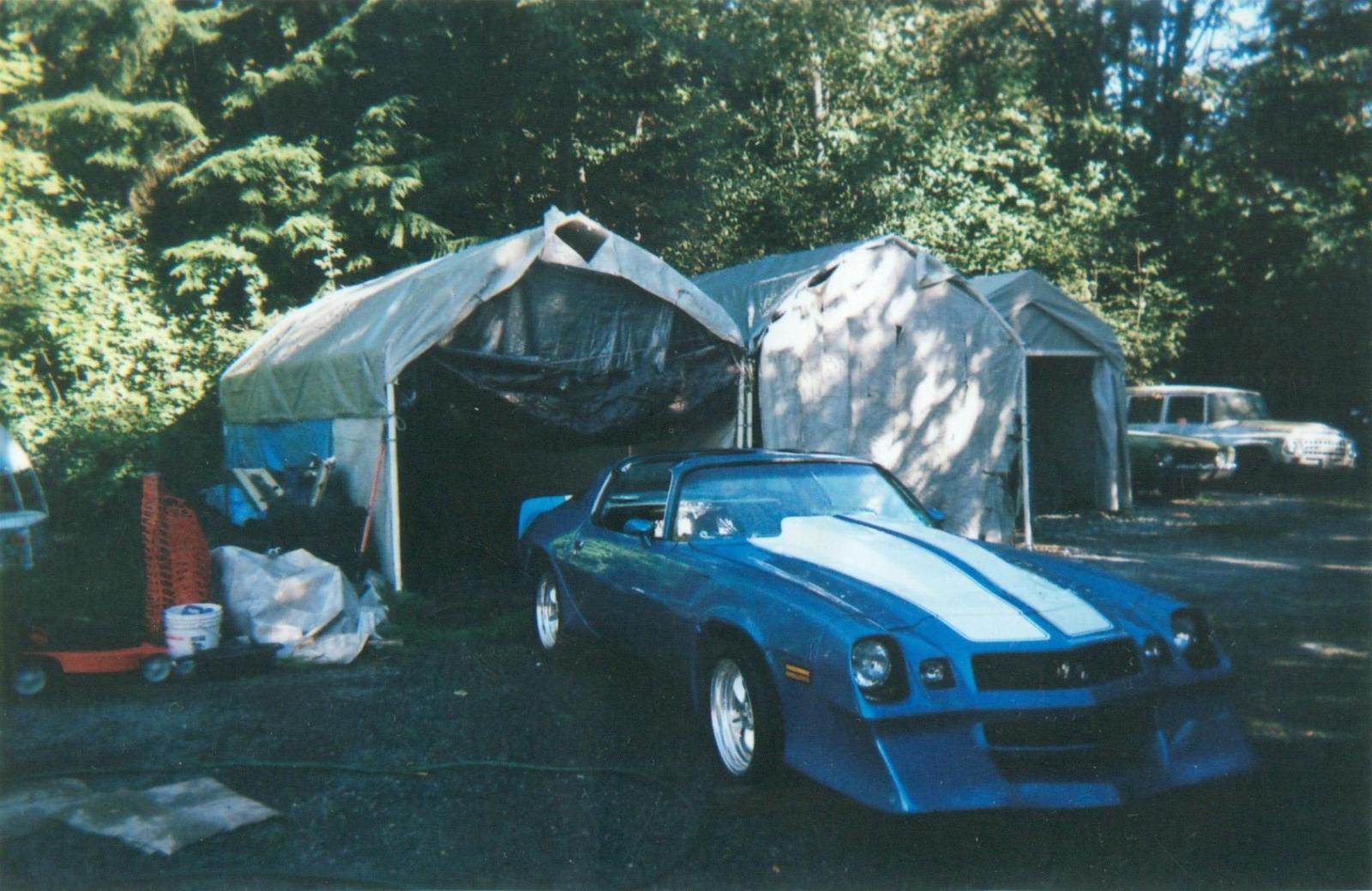

Size:  229.3 KBI would use a 8.5 Corporate ten bolt out 1973-9 Nova. They bolt right in. 8.5s are very strong ,and easier to find. I have one in my 1979 Z-28 RS Camaro Pro-touring car. It has a 364 Cubic inch 500 HP plus Supercharged Small Block Chevy .With a Super T-10 four speed.I upgraded mine with Moroso "Brute Strength' Center section, New Chevy 3:42 gears,and Moser 30 spline axles.And I never have had a problem.
