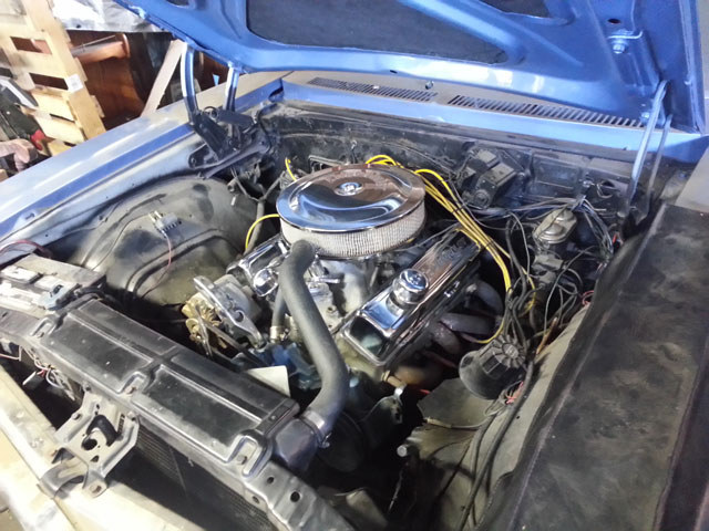

      Hello fellow pro-touring enthusiasts! I wanted to introduce myself since I just purchased my brothers 1970 Nova and want to start restoring/modifying into a Pro-Touring Nova. I've been a fan of Nova's since before I was able to drive. My first car was a '66 Nova which I regretfully sold before I moved to Southern California, but now I'm stoked to get going on this 3rd Gen. It's been sitting in my parents garage for close to 8 yrs. now and I just got it running last weekend.
      My list of future upgrades is a mile long, but for now I just want to get it street ready and safe to drive. Looking forward to picking your brains to help me bring this car back to life!
      Kevin
      Below are some progress pictures from the last month of work.

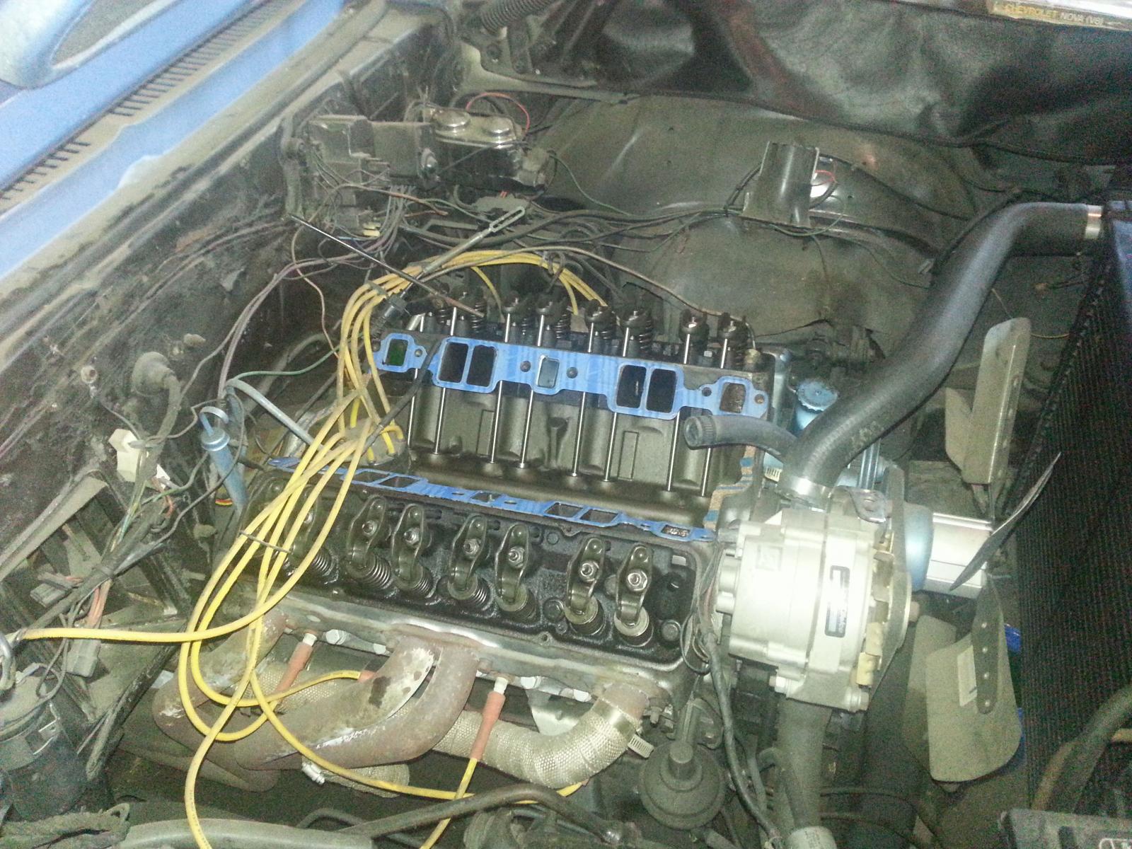

      Just when you think everything is all buttoned up and ready to go...
      I got the engine started and it was running a bit rough. You could definitely smell gas out of the exhaust so I knew that something wasn't firing right. I ran a compression test and all the cylinders seamed to be up to par. Checked the spark plugs and distributor, they were working fine. I bring it to an automotive shop around the corner to have them check it out and they say its a bad piston ring in the #8 cylinder and the #7 has a sticky valve. And after all the work I have put in to this project the last month I wanted to shoot myself for not pulling the heads and checking the cylinders. Now I have to pull the engine out and rebuild it or find a 383 stroker short block to replace the 350 I have. Pretty bummed since its almost a brand new engine but it has sat for 8 yrs without being started. Im wondering if its possible that there is gunk build up that can be worked out with some engine additives. Any advice would be appreciated.

      Just wanted to give an update from the progress over the weekend.
      I started out by running the engine and testing the temperature on the header tubes with the infrared thermometer. I was able to pinpoint the cylinders that were not firing which was cylinders 3,5 and 8 which were below 200 degrees. The rest of the cylinders were around 400 and above. I pulled the plugs that were in the engine from 8 yrs ago (should of done this when I first started) and notice they were pretty black, probably from old fuel. I swapped the plugs from the cylinders that weren't firing properly and presto... the engine ran like new.
      Since there was some build up on the plugs I figured I should run some additive through the engine to help break up whatever is remaining and change the remainder of the spark plugs. I added 4 ounces of MMO to the gas tank and the remainder of the quart in the oil. I didn't have time for a street test but I did run the engine for 10 minutes to let the MMO settle in. I still need to get the car registered which will be in the next week or two. Then I will be ready to tear up those new tires.
