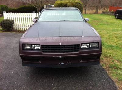

      I just picked up a new project. I need to dig into it ans start stripping it down to see how everything is, but overall it does not look like a bad starting point.
      Here are a few quick pics from when I picked it up.
      In the guys driveway.
