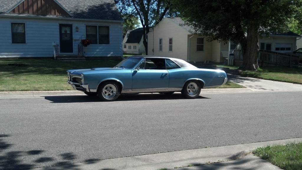

      Well before next spring im looking to update my wheels/tires to a 17 or 18" setup. This kind of stuff takes time and planning so i like to get my decisions down a long way in advance. There are a million wheels to choose from it seems and I certianly havent seen them all, so its nice to get others ideas and in the process, maybe I'll find something I hadn't come across before. I really like the vintage looking VWW V-40's with flat caps but im open to ideas. Maybe a black centered wheel like a C5 Coy would compliment the vinyl top? Im also on a reasonable budget so unfortunately forgelines and other very high end stuff are out of the question. So if this is your GTO, what wheels would you put on it?? 17's or 18's? Im in the process of getting parts for an SC&C stage 2 plus setup so the car will sit lower.
      Heres the car....
