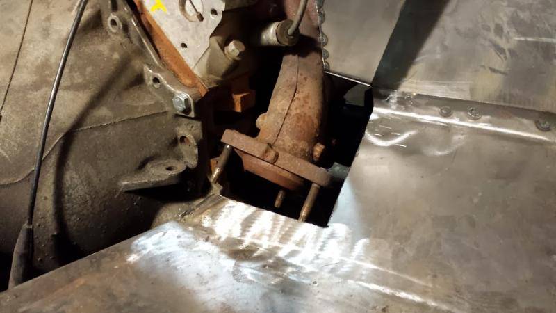

      Looks like I'm going to have to move the engine forward about two inches. The exhaust manifolds are too far in to the firewall / toe board area for my liking.
      Also, in this pic, the cab is still needs to come down about 4" on one side before it sits down on the body mounts and it's quite close to the MAP sensor. I'd like to retain the cowl vent, so moving things forward will help.
      2" will make all the difference.
      I'll probably be picking up Welder series mounts (LS200), but for now, I'll cobble something together to move the engine to check fit.
