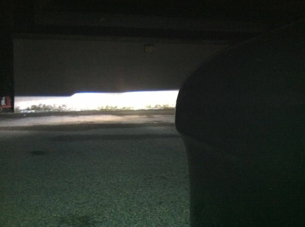

      HIDs are not supposed to be used in a standard halogen reflector housing. Yes, the light output is more but it is all scattered and you can bet I will be flashing my aircraft high beams at you because they are blinding for other drivers.
      Check these out... I just got a set in my other car and they are really impressive. This is the correct way to run HID's on older cars with the 7" round bulbs
