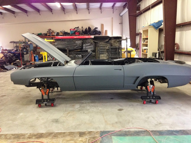

      Coupe of quick shots..
      Gotta love the kindigit setup.
      https://picasaweb.google.com/1140136...60346743190386

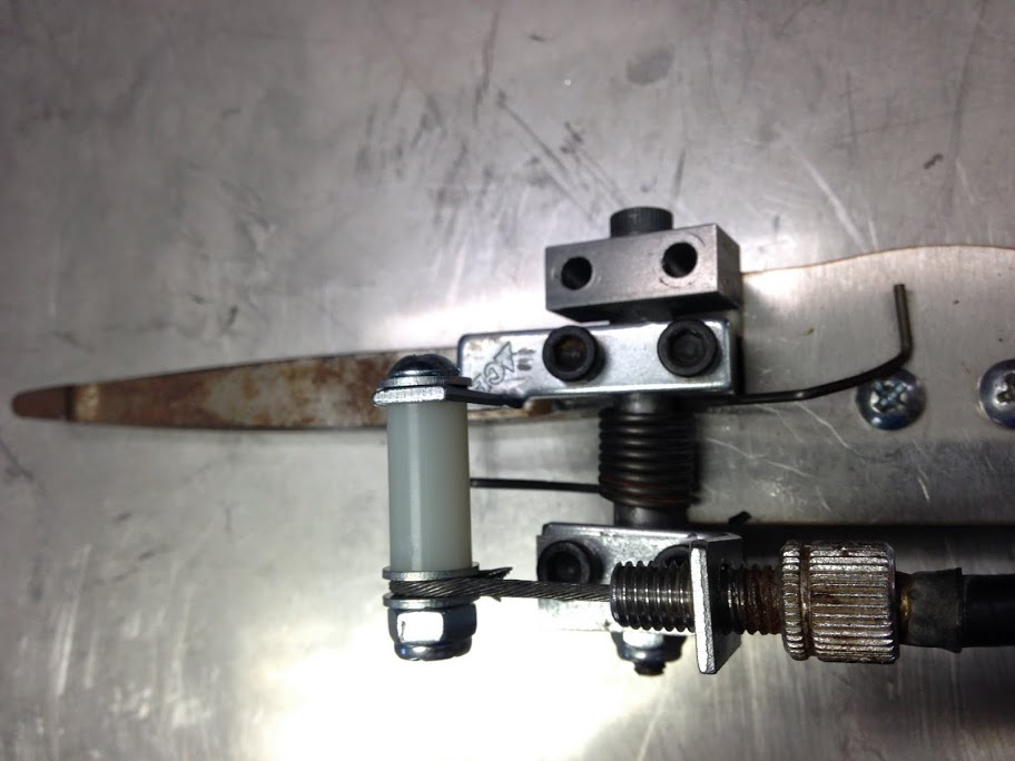

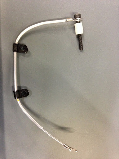

      Need some feedback on the door handle hookup to latch. I have looked high and low and can't seem to find any other examples of how people are hooking these things up! Maybe my searching skills just suck, I don't know. Anyway, I looked at few options including the Lokar universal cable/pulley setup and cam up with just using a simple cable/shielding setup. Stealing ideas from motorcycles now.. lol
      Anyway, any feedback or other suggestions would be welcome, just want to make sure I am not missing something simple.
      Here is what I did.. Old cable and adjuster just for mock up.
      Thoughts?

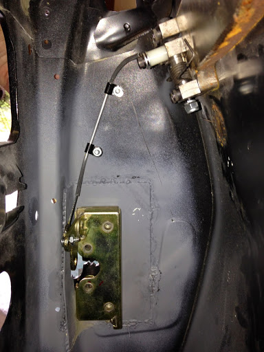

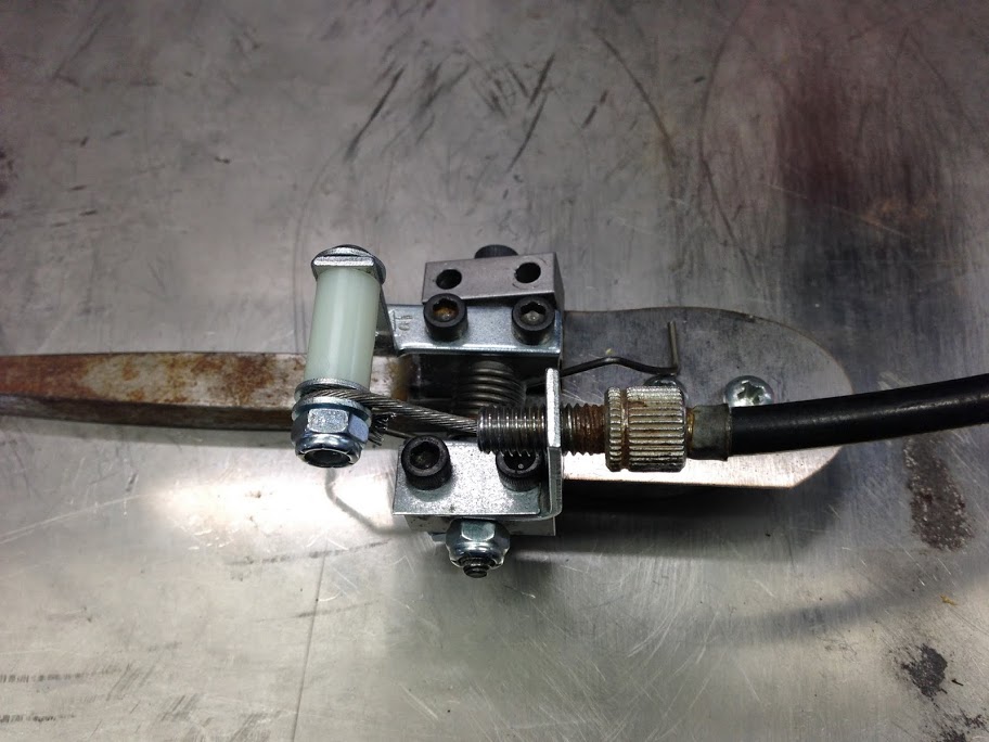

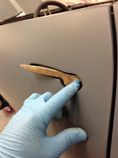

      As I mentioned, I had difficulty finding any info on hooking up the Kindigit handles so I thought I would post what I ended up doing just in case someone else needs an idea down the road.
      Kindig It Handle install.
      This is what I ended up doing. Very simple slip cable setup. Much better then my original approach.

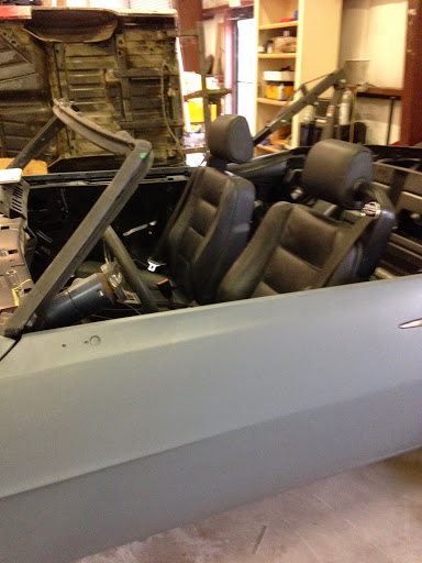

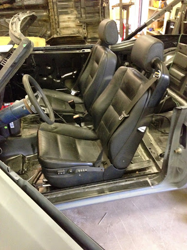

      Finished both doors and got the mounts fabbed up for the new seats. They fit very well, all motors are tested and working good.
