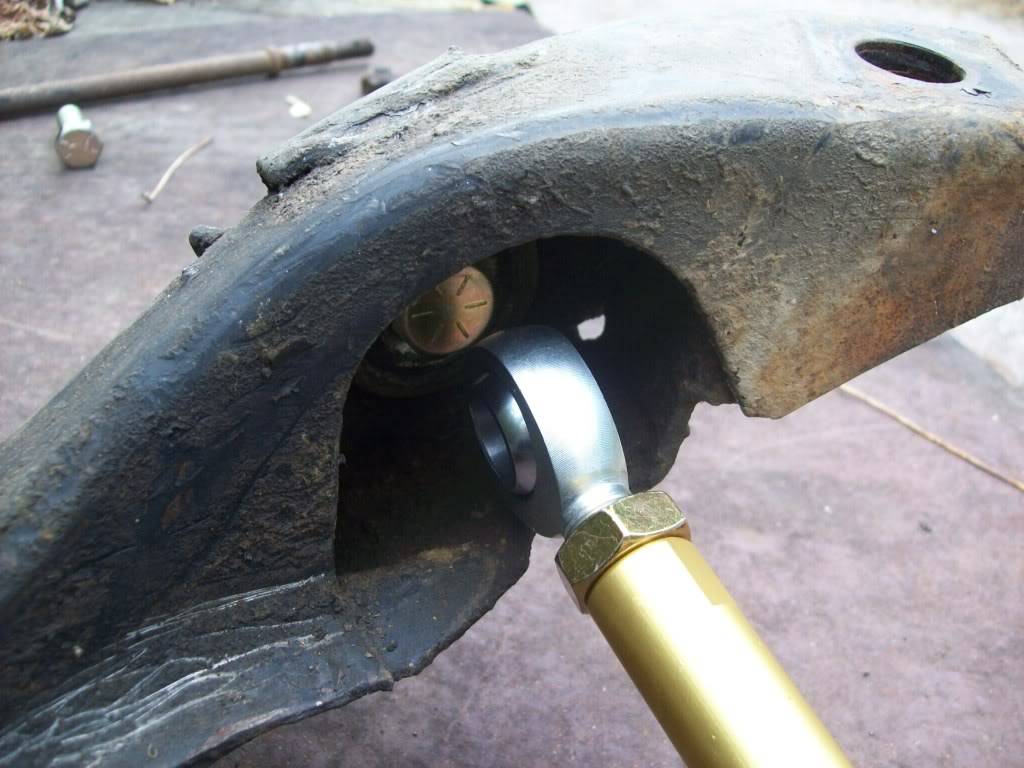

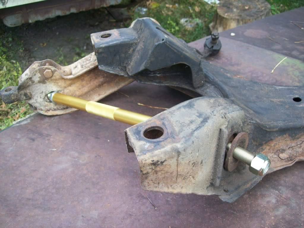

      Today I got what is pretty much the last remaining hardware for my front suspension. I now have to make a T-coupler and I will be ready to install my front suspension! Here are some pictures from my mock-up. Obviously the bolts would be a little tighter on the finished product.
      in this picture you can see where the T I am making will go.

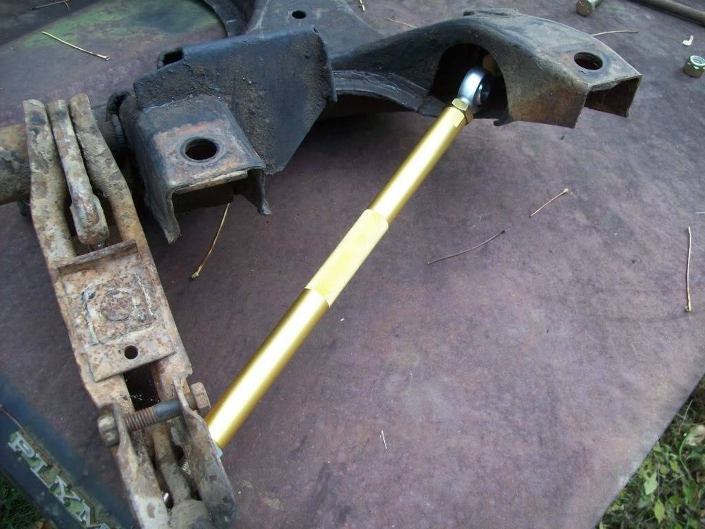

      More on the strut rods
      As I showed you before, I am making adjustable strut rods for my Duster.
      Here is one partially done (I ran out of time) with the bolt going through it so you can see how it will work.

      Why the fine threaded bolt? Or is that just a mock up?

      Nice build. I have a 70' Dart and I am in the same stage as your are. I made a set of strut rods similar to yours in the summer. Pics here:
      http://www.forabodiesonly.com/mopar/...=101622&page=2
      Word of advice, for the clevis that mounts the rodend to the k-member, save yourself the trouble and just order them from Hotchkis, they sell them for dirt cheap. Good call on using rodends on the lca side. The axis of the lca strut rod mount thru hole is not always coincident with the k-member side pivot, and it will bind if you only use rodend on one side (ie hotchkis). The stock one can get away with it only because they use a compliance bushing on the front. I can confirm this, since when i tested mine, the lca side rodend does in fact move slightly, especially near full compression.

      I went with the fine threaded bolt because it is the same thread as the rod-ends I am using. I I don't like mixing thread counts in sub-assemblies. As that is a recipe for disasters when changing stuff. I could have used either.

      As for the rod-ends on both sides, I hadn't planned to do that. But I noticed the misalignment issues you mentioned when I was doing the mock-up (See previous pictures). This is a fairly big concern for me because of how hard I will be pushing it and the lower spring rates I wanted to use. I am not sure what I am going to do about it yet. I might have to flip my current design and do something different on the k-frame end. I have some poly bushings that I got in a kit that I could use to give me a bit of room for error. But I would rather not have to use them. I think I will be switching to rod-ends on both ends as in the drawing above. But I may have to get a new rod as this one may be to long. I'll be sure to post more when I figure it out.
