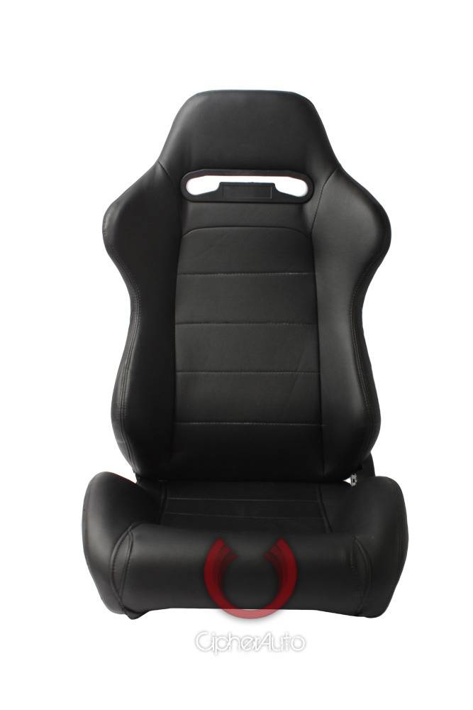

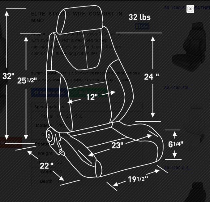

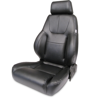

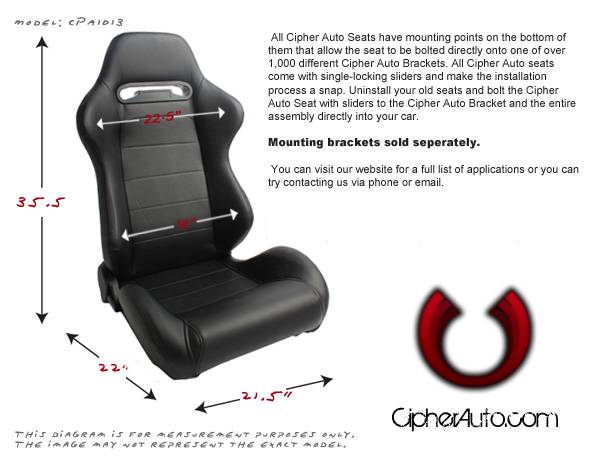

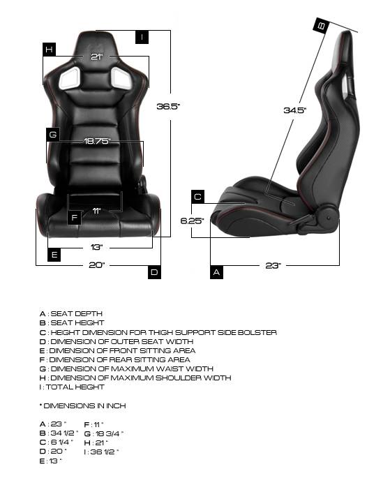

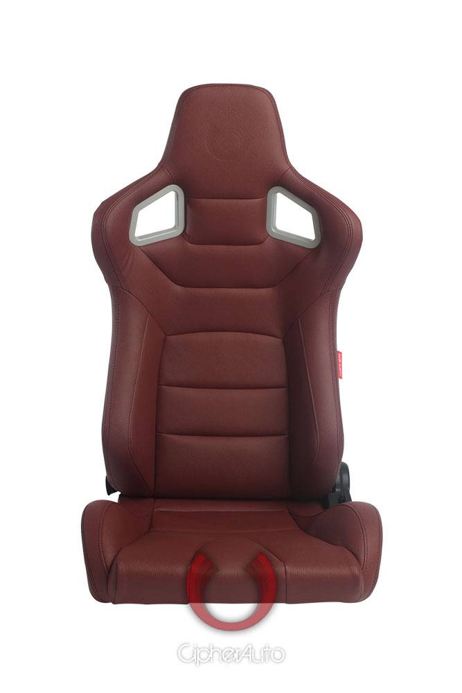

      One of these are possibly going into go in my 72' Pontiac Lemans... Any experience with any of these seats? Comfort? Quality? Fit? I'm 6'6", medium framed, 240ish lbs.
      I also have considered other Procar Sportsman seats but wasn't too sure about fit and what not but if anyone has experience with them or any other brand (on the cheaper sides please) I'd like to get info on it.

      The Cipher seats are not designed for a big or even mid size person. I had a set like the top picture and had to replace them because they were just too narrow on the hips for comfort. Not to mention they are a cheaply made seat. If you want a pair I will sell you the ones I have for cheap just to get them out of my shed but I doubt they will be a good fit for you.

      I have the procar seats and I really like them. I am 5'9 180 broad shoulders and they fit me great

      I have the Cipher 1013 like you show above in my car. I'm 6'1 ~250 lbs and the seat is just about too small. It pinches in on my legs, but is not unbearable. They sit too high as well as my head hits the side with a helmet on. They are cheaply made. I had two welds break while I was autocrossing! Not a good feeling! If I had to do it again I would keep my stock passenger seat and spend the money on the Corbeau A4 Wide.
