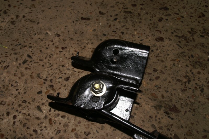

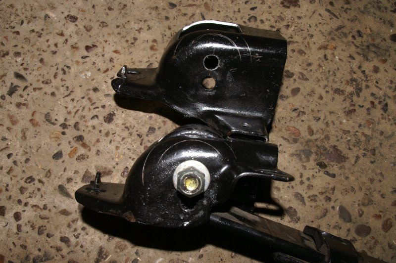

      I began the Herb Adams mod this morning on my car.
      After some measurements, I drilled the holes 3/4" higher (19mm) and cut the leaf spring brackets.
      Finally, the cut is much smaller then all the other I could see. Maybe because I use Hotchkiss springs...
      Is this OK you think, or should I increase the clearance between the spring eye and the bracket? There is approx 2mm for the moment.
      The spring is alos not as high as I thought, I will maybe not need to cut so much on the floor.

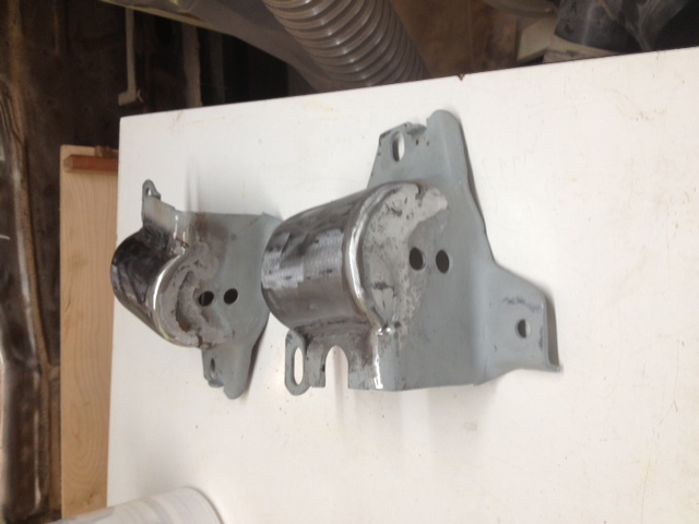

      got mine done
      Name:  spring perch.JPG
      Here is my finished perches, a little paint, minor floor board mods.

      I like what you did there
