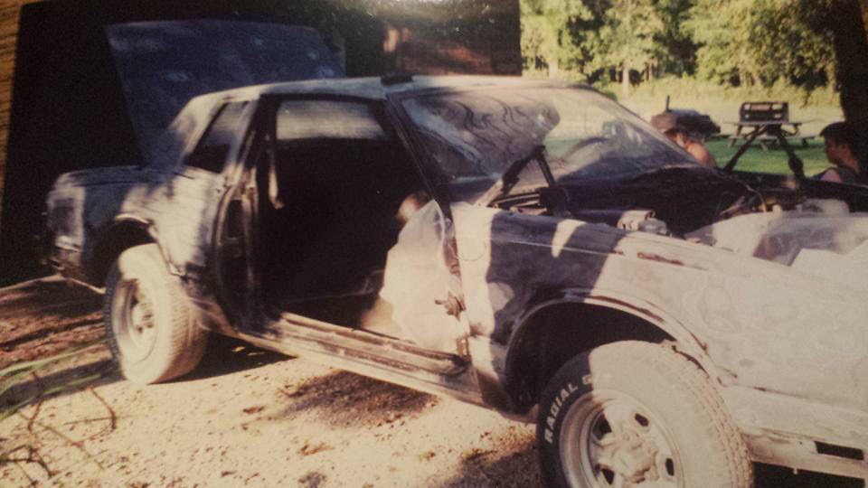

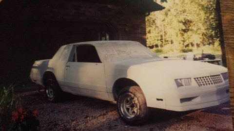

      Here it is with the 305 removed.
      We did paint and body work

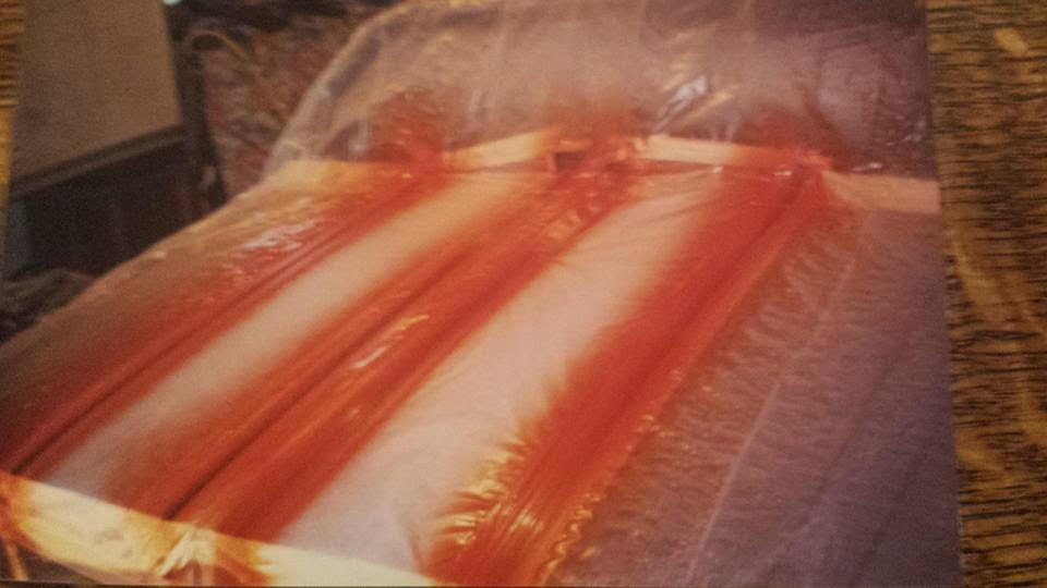

      And took the factory 3 color perimeter stripes and turned them into '70 Camaro Z/28 style stripes

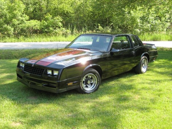

      The car was like this for the first day of school my senior year, Which was pretty awesome.
      The car was my daily driver in high school when the weather was good.

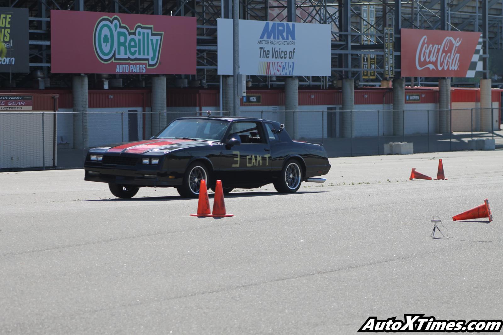

      Then after college and having a decent job I tried Autocross one day.
      Even though battle ships have less roll in a squall, I was in love with racing.

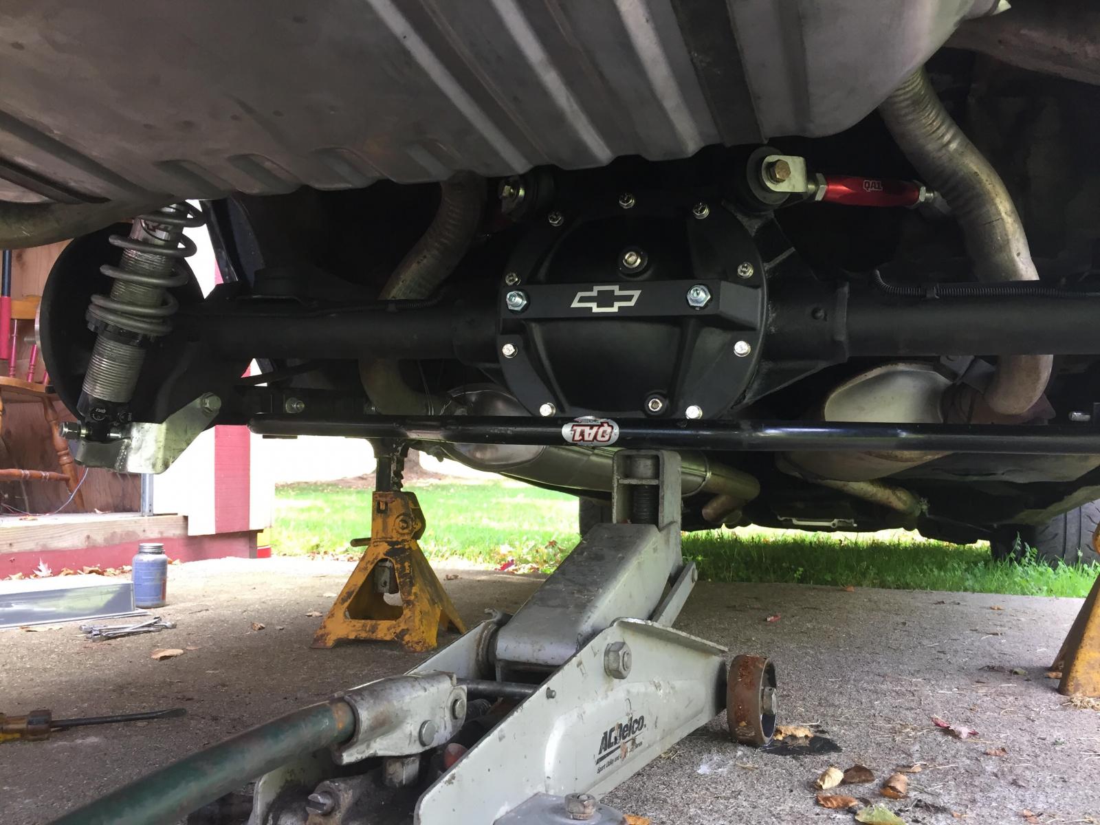

      So I bought a QA1 Level 3 handling kit with double adjustable coilovers.

      Loaded it up in the trunk of my car and drove back to my Dad's place where we had built the car 10 years prior.
      The goal being to arrive on thursday, and install everything by Sunday to go to an Saginaw Valley Region Autocross about 45 mins away from my folks house.

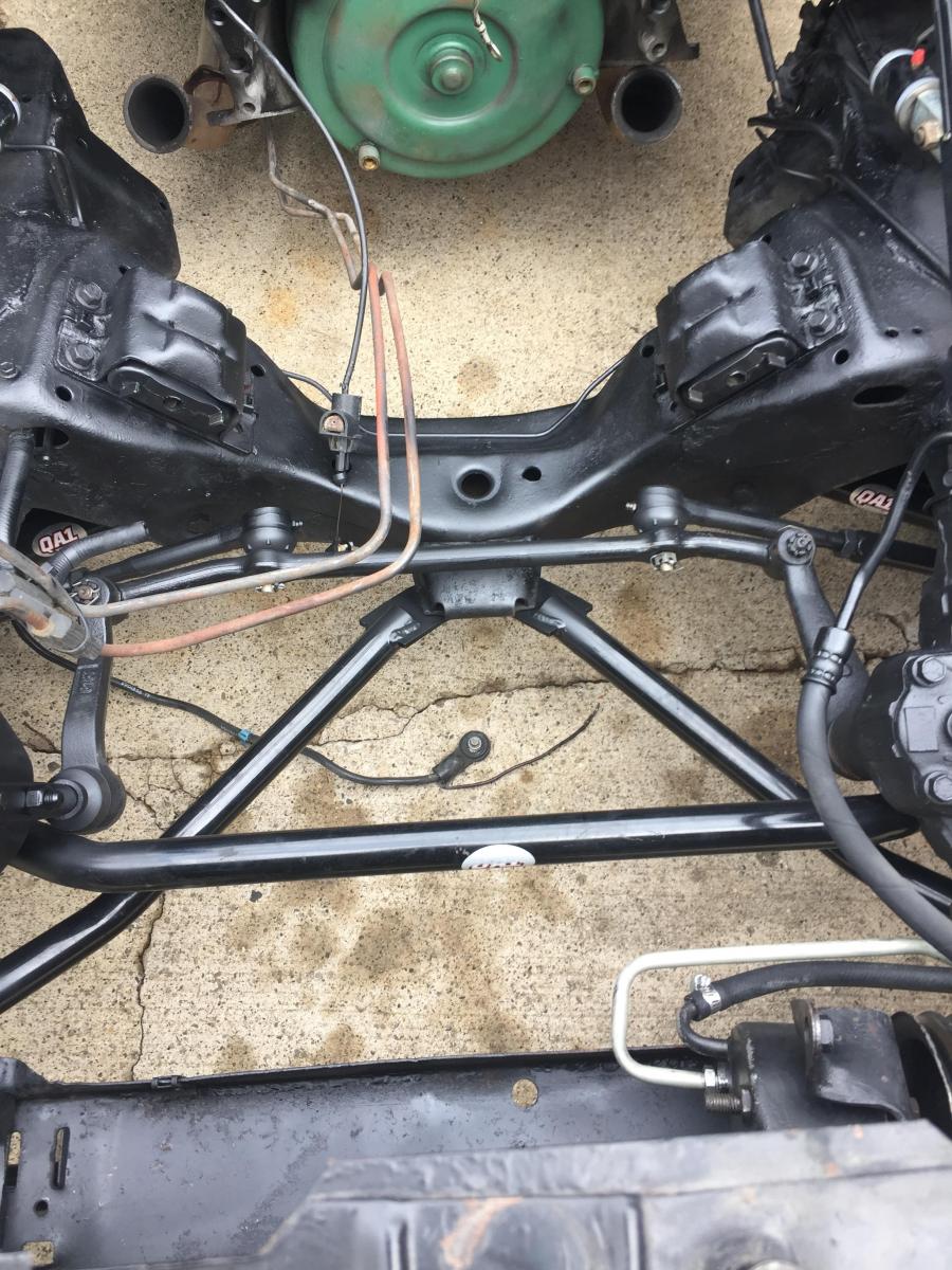

      Started at the front of the car where we tore out the old parts.

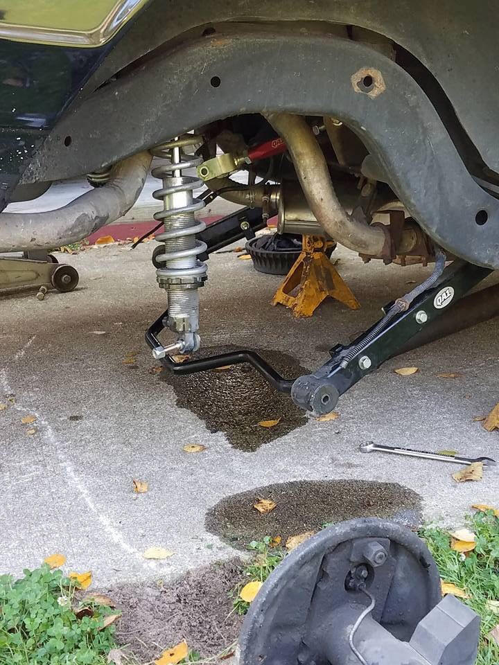

      A comparison of the QA1 tubular arms vs the stock stamped arms.

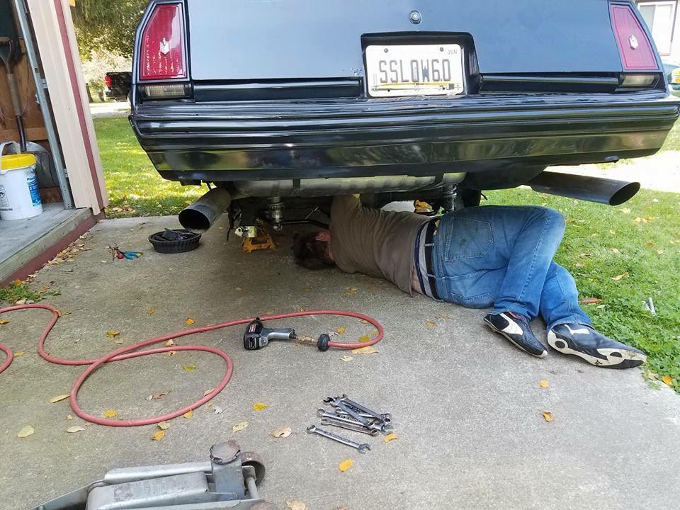

      Got the front back together (note sway bar is assembled upside down in the is pic)

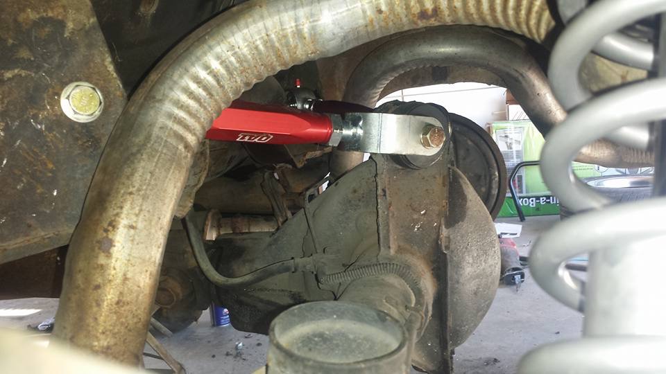

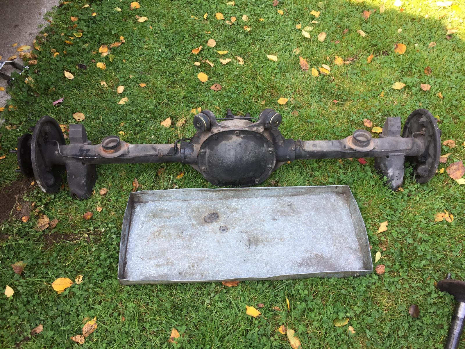

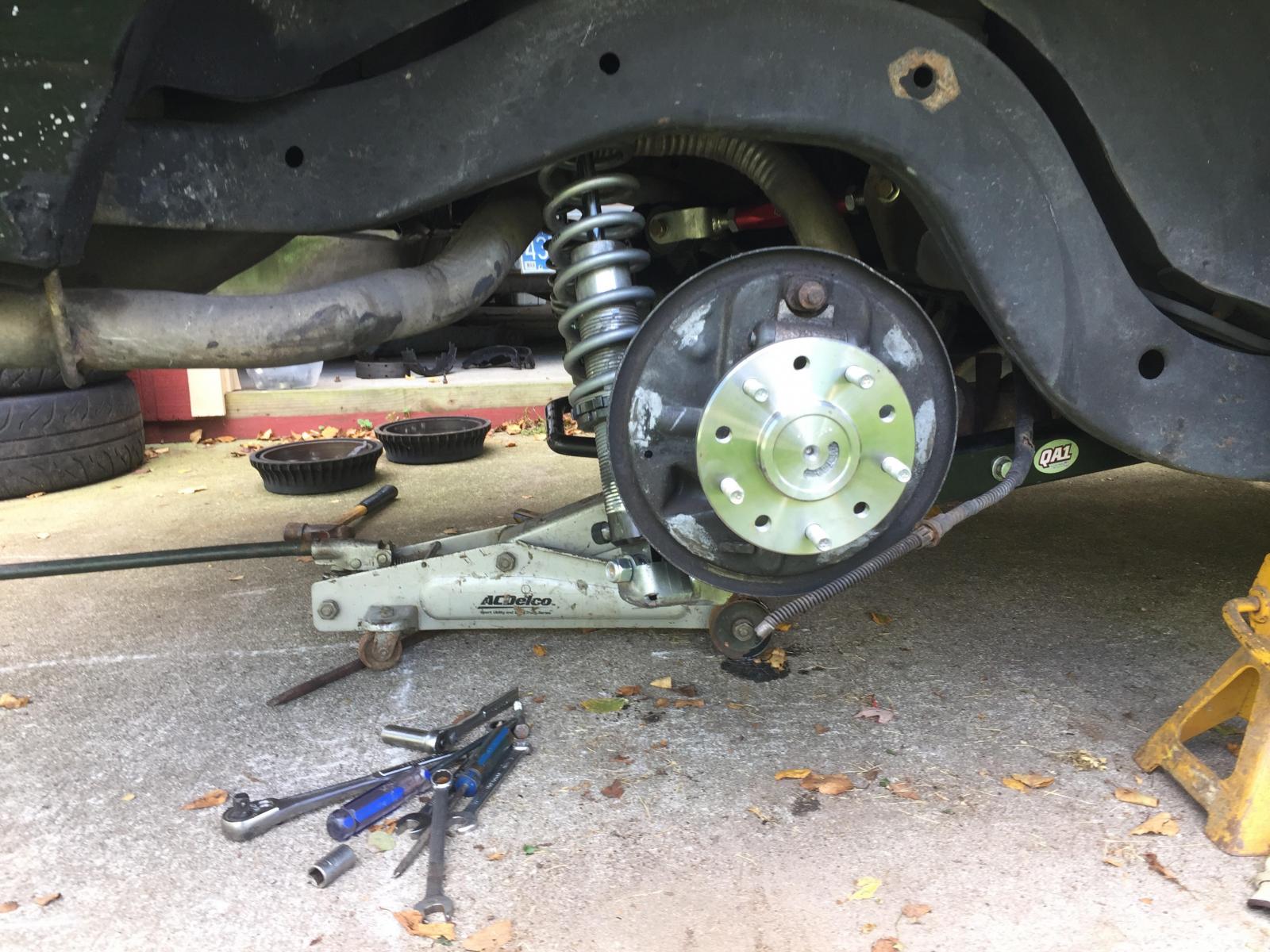

      And went to the rear. By comparison the front was a piece of cake compared to the rear.
      Due to the location of my exhaust and the 30 years of grime and rust that developed on the upper control arm nuts and bolts, it was an absolute pain to get them out.
      But we finally managed to and got the rear suspension components installed.

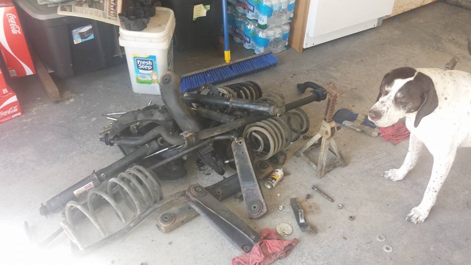

      This is all of the old parts

      I also added in a UMI front triangulation brace which did wonders for the steering feel and overall stiffness of the front suspension.

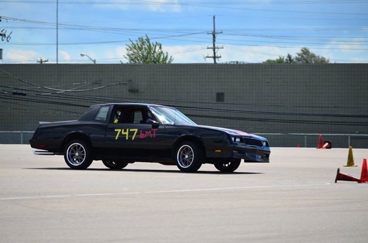

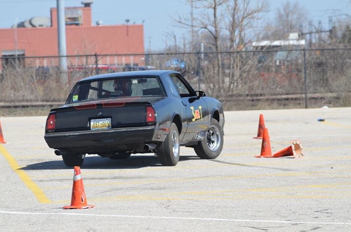

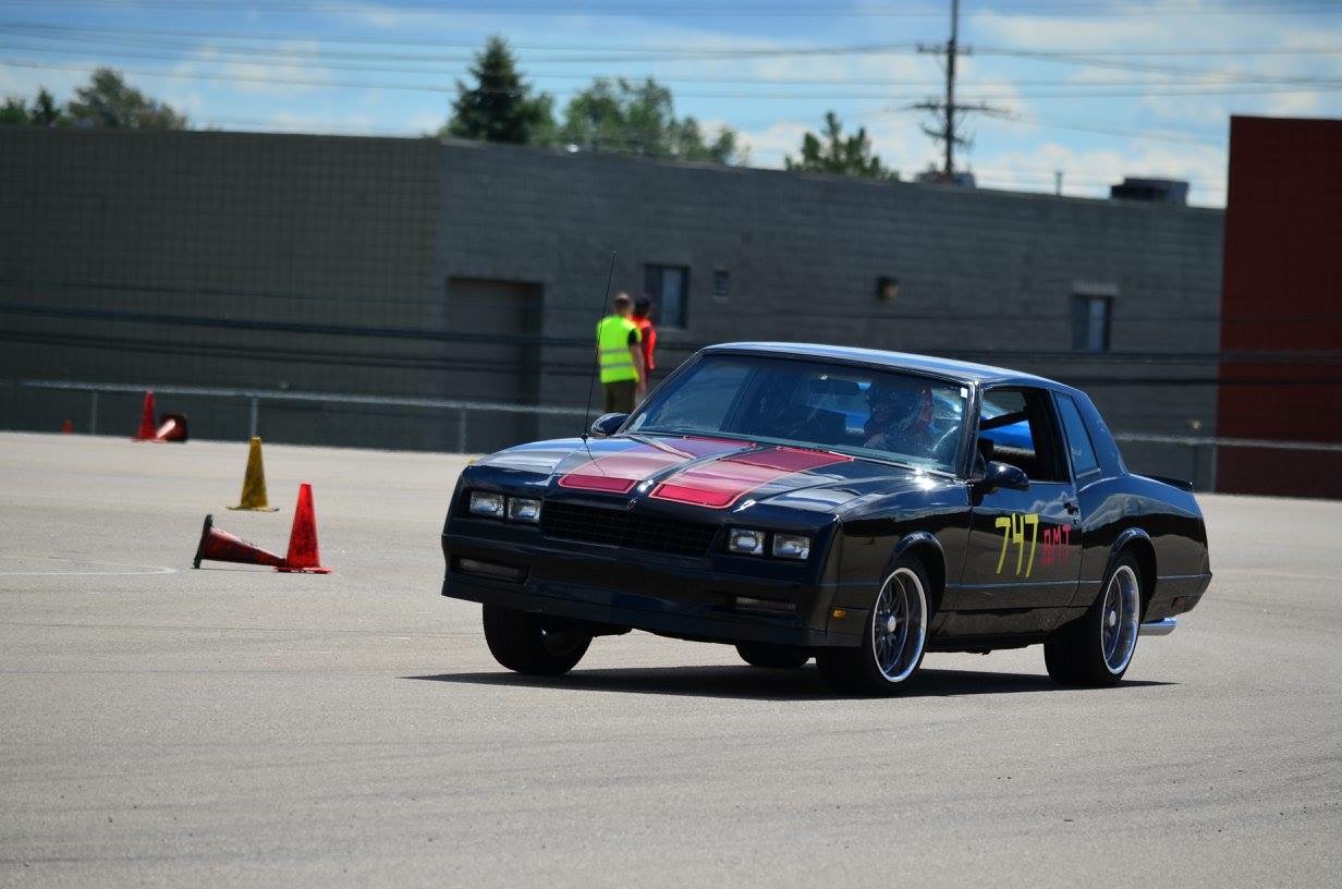

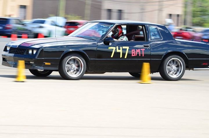

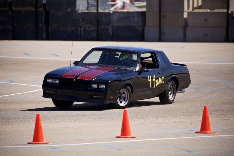

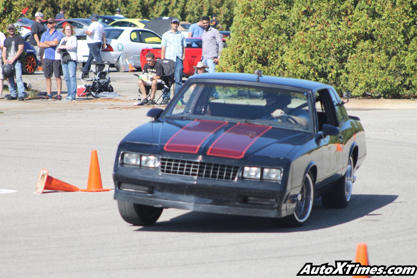

      Autocross Video

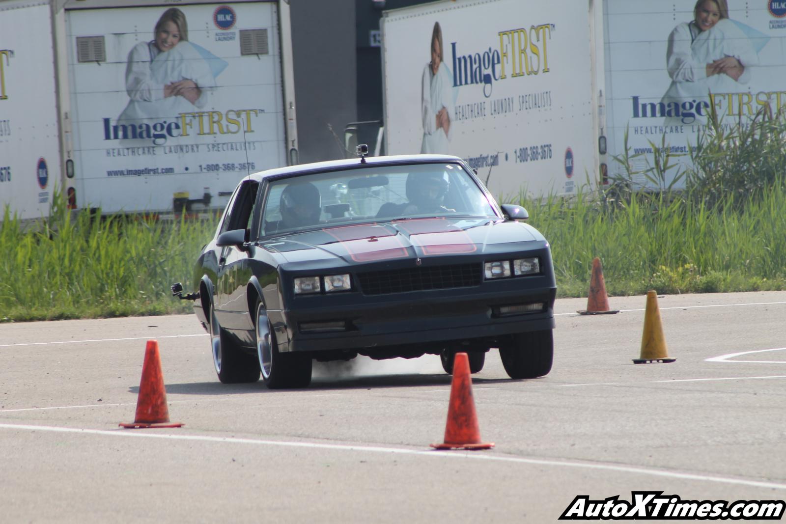

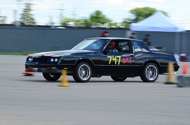

      Ran this past weekend with my local Autocross group.
      Managed 2nd in my class.

      That looks like a fun course! What region and where was that put on?
      Congrats on the successful swap, now we need to work on getting you a much larger front sway bar!!

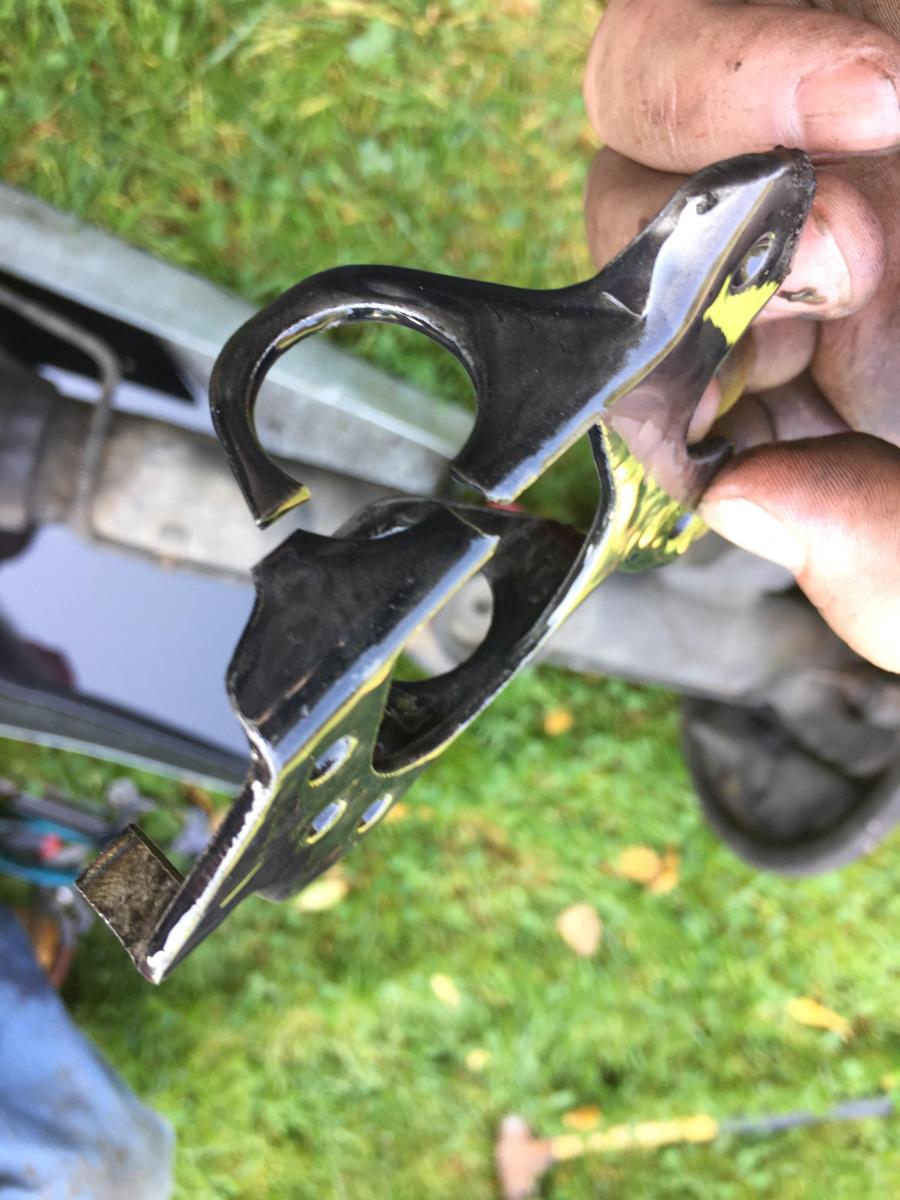

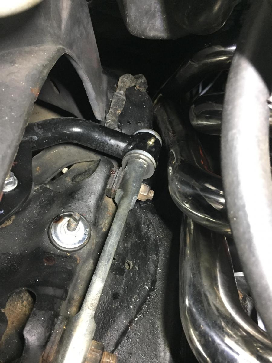

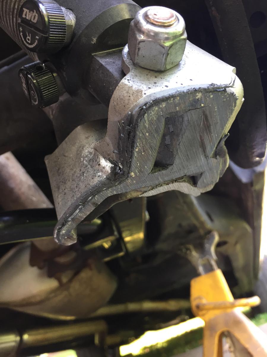

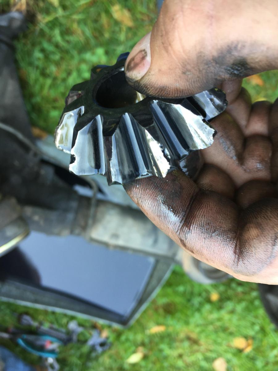

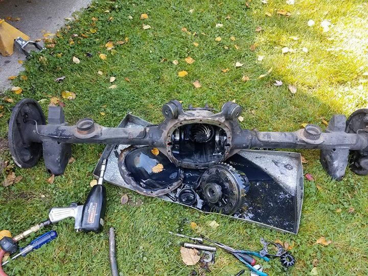

      As far as the bigger bar goes... the QA1 is a hollow core 3/16" wall x 1 3/8" (35mm) diameter, only bigger one I can find is the ridetech Muscle Bar (37mm), and it seems like all that one does is break Posi-links.

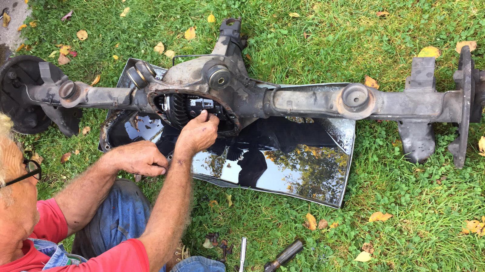

      I think in need a decent diff and more spring rate in the rear along with a little more aggressive alignment. 12x2.5 coilover Springs are cheap enough where I don't mind buying a couple of sets to see if 350/450/550/650 # springs are the answer and i have a torsen t-2 diff to install, just need to buy new 28 spline axles. My rear bar only goes between the two lower control arms, but was also in it's least aggressive position. Oh and it obviously needs more tire, but custom Forgelines are not in the budget right now, and certainly not before I get a manual and a 9 inch in there...

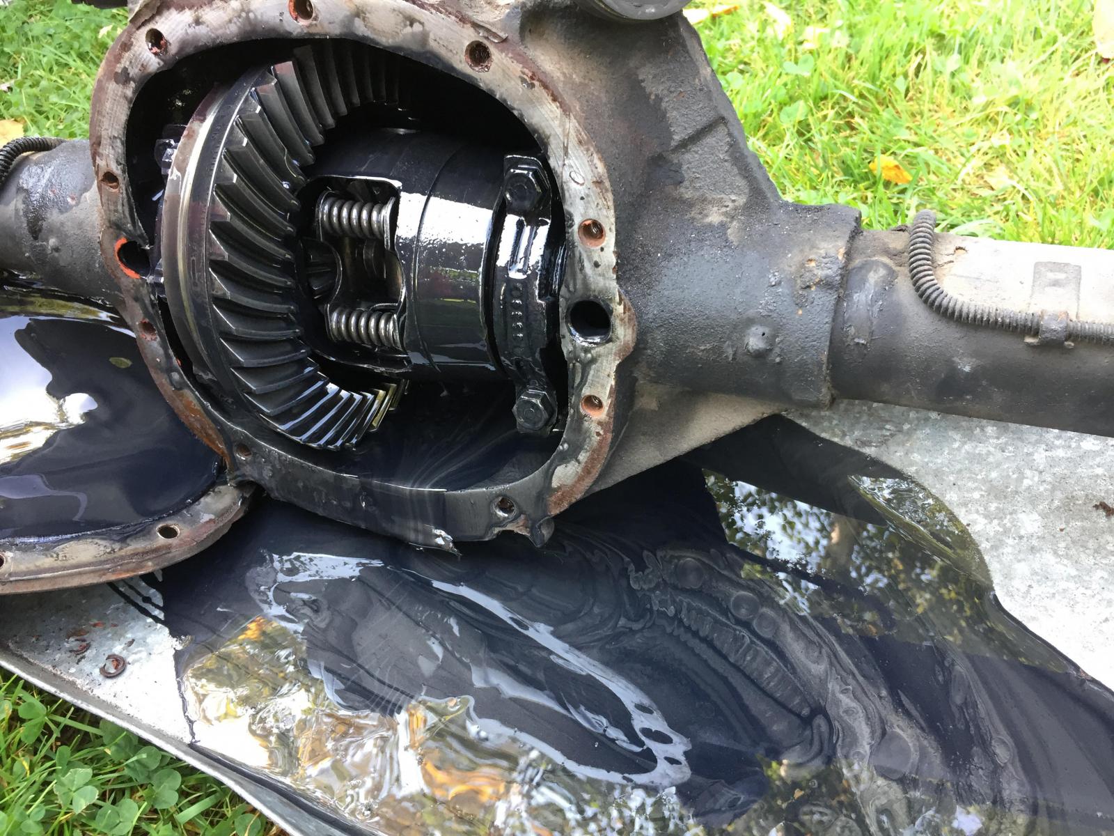

      In the pics you can see how it was smoking from the trans vent and also how it needs a little more negative camber. I'm only running 1.5 degrees currently, I'll get it realigned when I put my taller lower ball joints on.

      I have run 3 different MuscleBars over the past 4 years and have only broken one posi link...and that was only because the bar bushing bracket came loose from the frame first and put it in a bind. My current version is a 1.5" OD 0.375" wall tube bar on the front and I want more!!
      A LOT more bar on the front and 600# springs on the rear with no rear sway bar would make miles of difference on your setup...throw in some more caster and you'd be surprised how much better it turns...even with 245s...

      Wow, that's a lot of body roll! Looks like fun though. I can't wait to do another autocross with my new TrackAddict app and RaceRender with my GoPros. haha

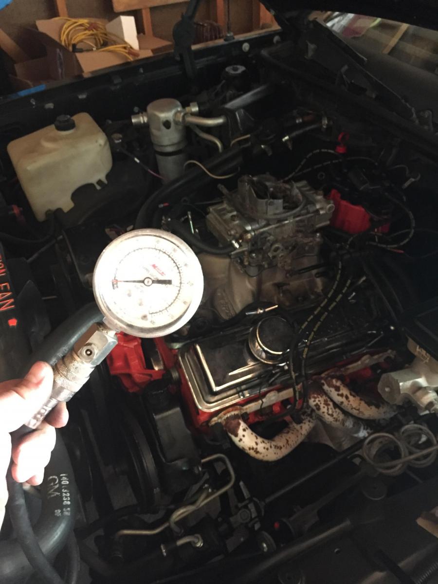

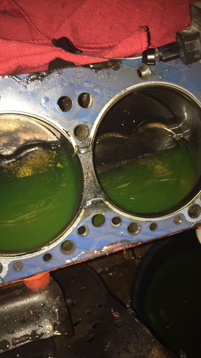

      The LS swap happened in a haphazard way. I had been wanting to swap an LS motor into my car for some time, but the 355 that we had build and installed 12 years ago was rock solid reliable, if a bit quirky. One day after a spirited blast down the highway, the car was sputtering and hardly running.
      I ran a compression test, and this was the result.
      0 PSI on both 3 and 5.
      Popped the head and found this:

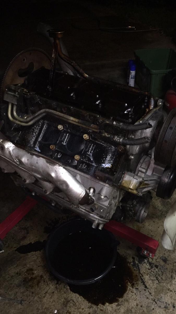

      Knowing that if i slapped it back together, the next engine failure would be catastrophic, and potentially dangerous, I shelved the project for a while. My wonderful Fiancee and myself are saving for both a house and a wedding and I felt guilty about even spending the money to do the head gaskets. I cleaned up the shop and I loaded parts into the trunk of the car and had an awful feeling. That "this is how project cars sit for 30 years feeling" My Fiancee asked me what was wrong and why I was so downtrodden, I explained and she offered up a solution - I could take the money to cover the purchase of an LS motor from the wedding fund. (seriously the coolest Bride to be ever.)

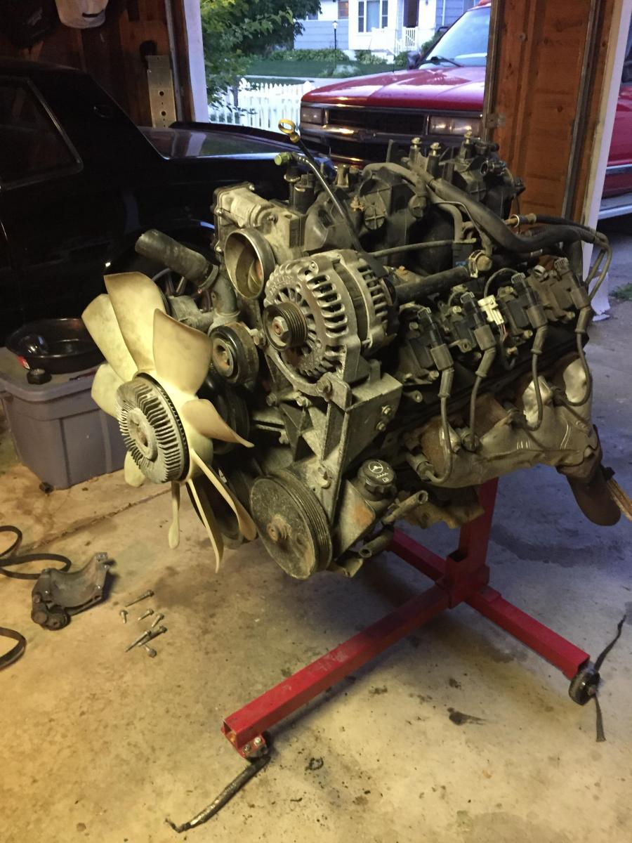

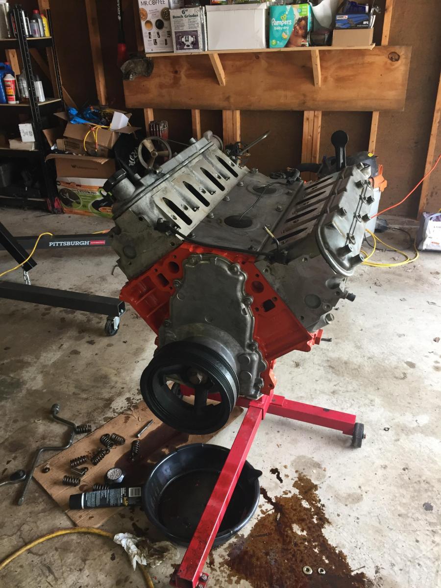

      So I went and found a 6.0L LQ4 from a 2004 Yukon Denali. It was mostly complete, but the harness was cut. Not a big deal because I was planning on doing a Microsquirt harness ( a friend had given me it a while back to maybe do TPI on my small block)

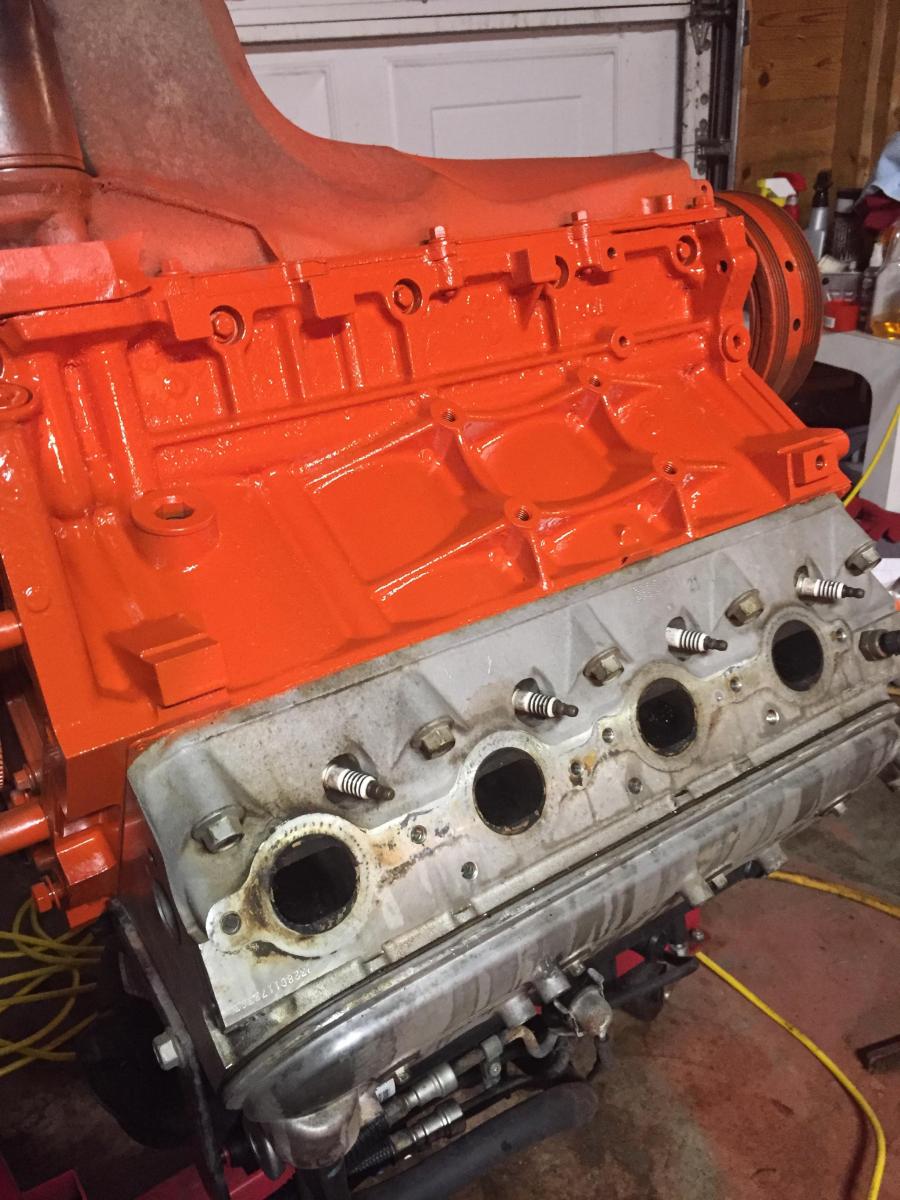

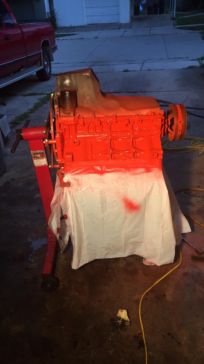

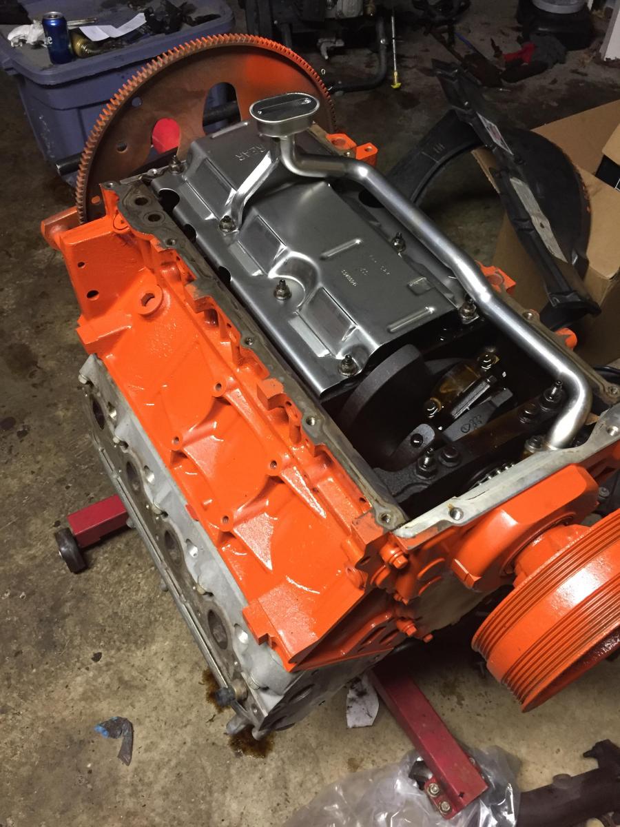

      From there it was De-grease, prep and paint
      I had bought a holley 302-2 oil pan which required me to install and clearance an F-body oil windage tray

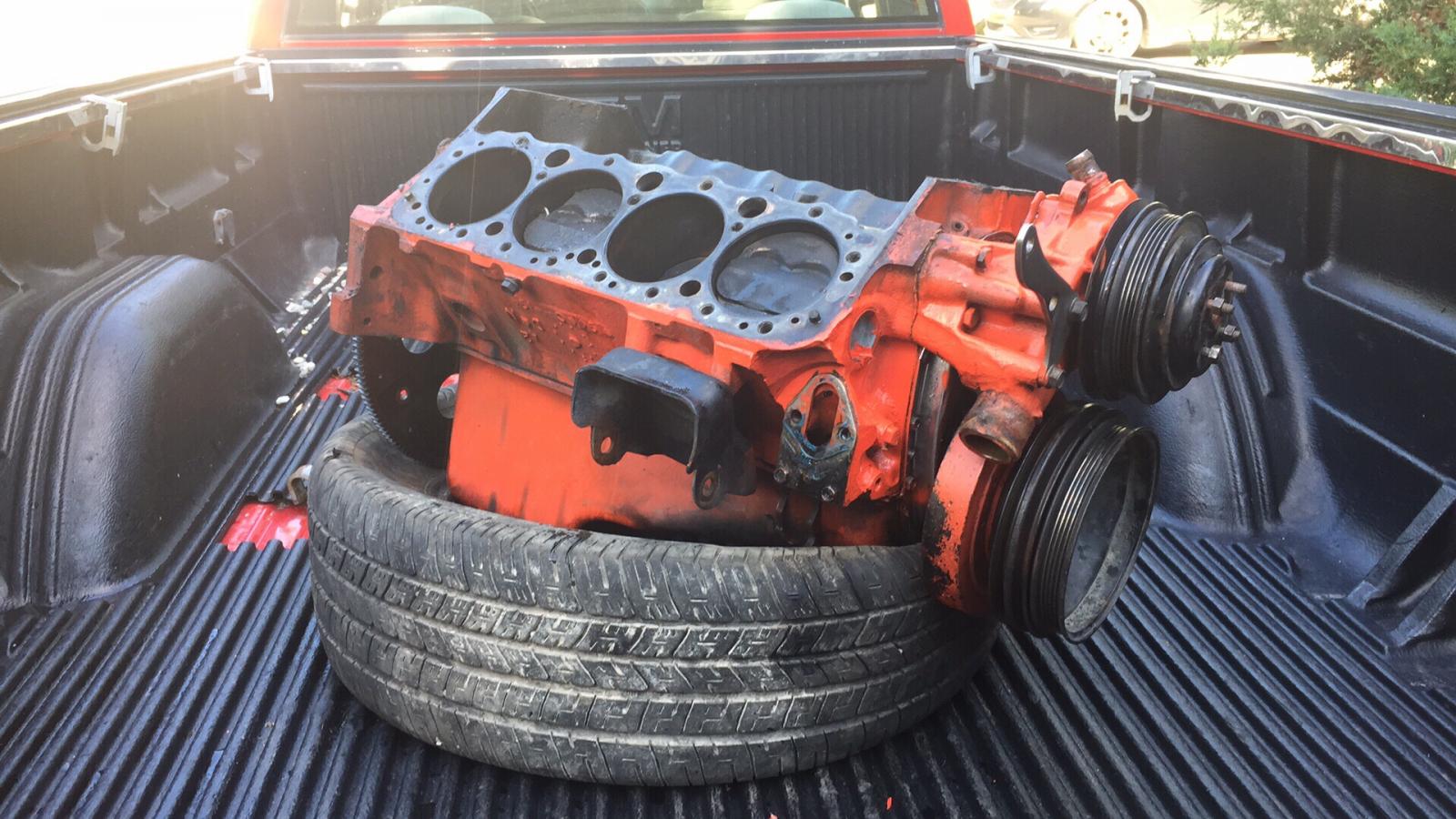

      Pulled the old engine and waived bye-bye to it's broken pistons:

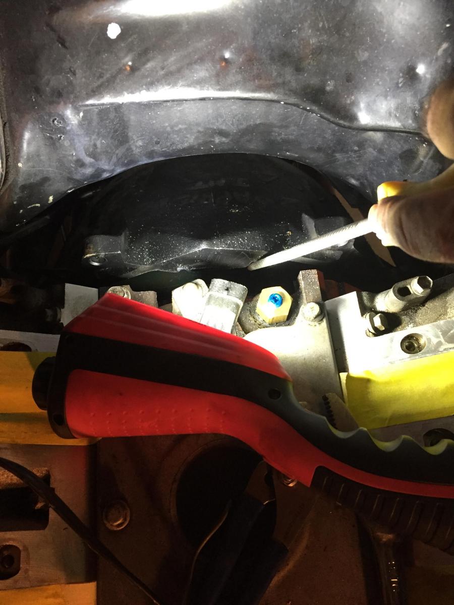

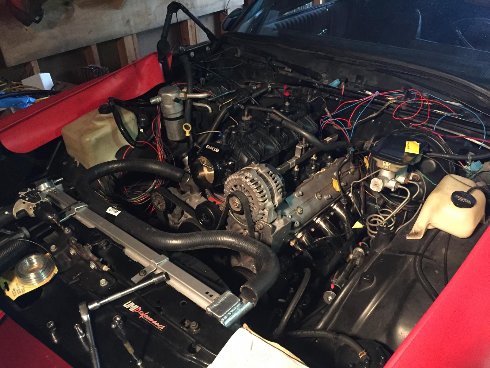

      After getting the motor in, ran into an issue where the rear cover bolts were contacting the flange on the dual pattern of the 200-4r. So i grabbed a file and got to clearancing.

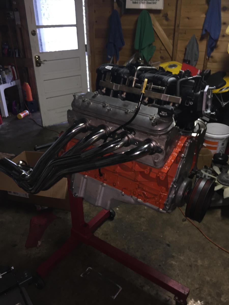

      Once that was done, I got the headers in

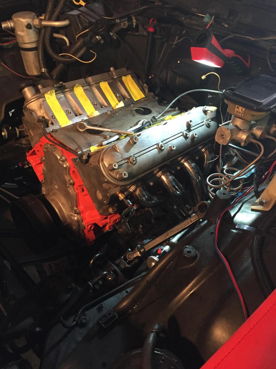

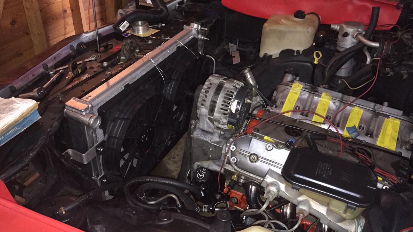

      My dad stopped by and helped me get the fuel system and cooling system set up.

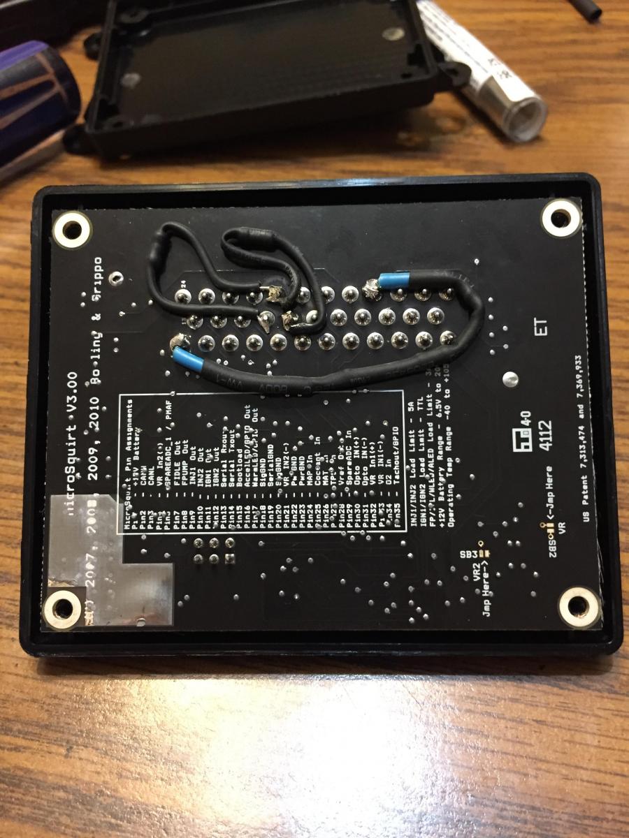

      Then I made the necessary modifications to the Microsquirt Controller to allow it to run an LS motor.

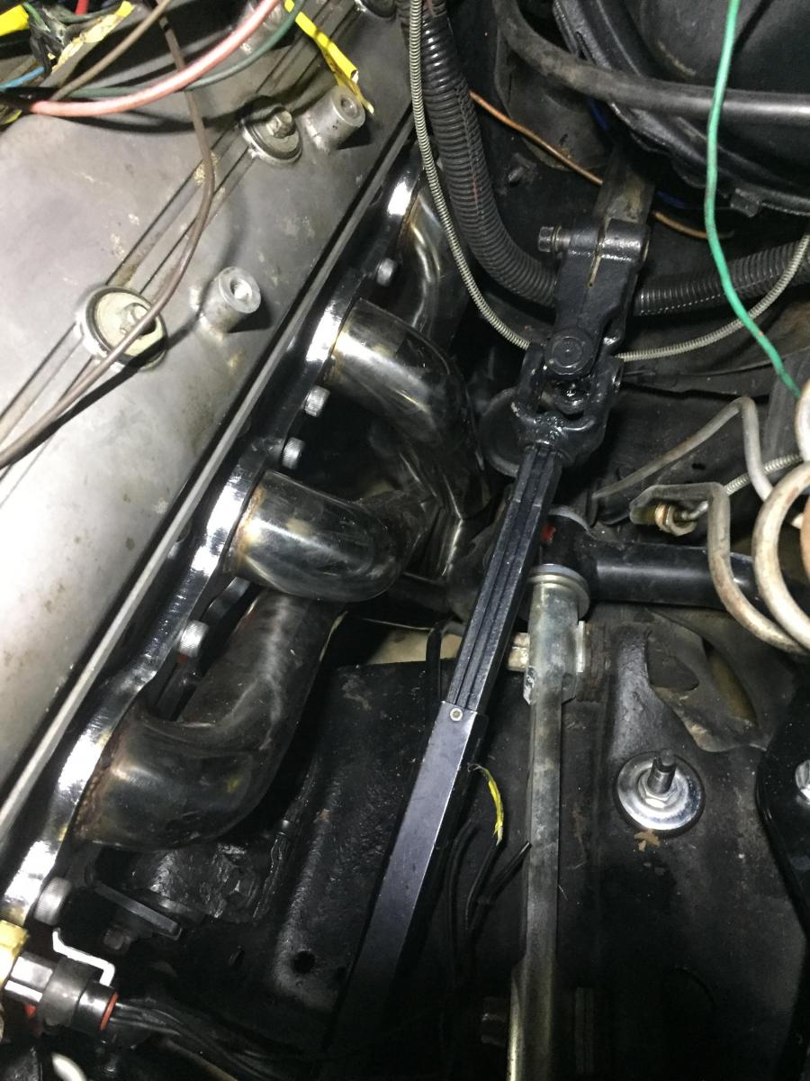

      The headers are a tight, but manageable fit. I'm usually all about buying top quality US made parts, but seeing as I was just sure i was going to have beat on and reshape the headers, I defered to best headers Guangzhou has to offer.

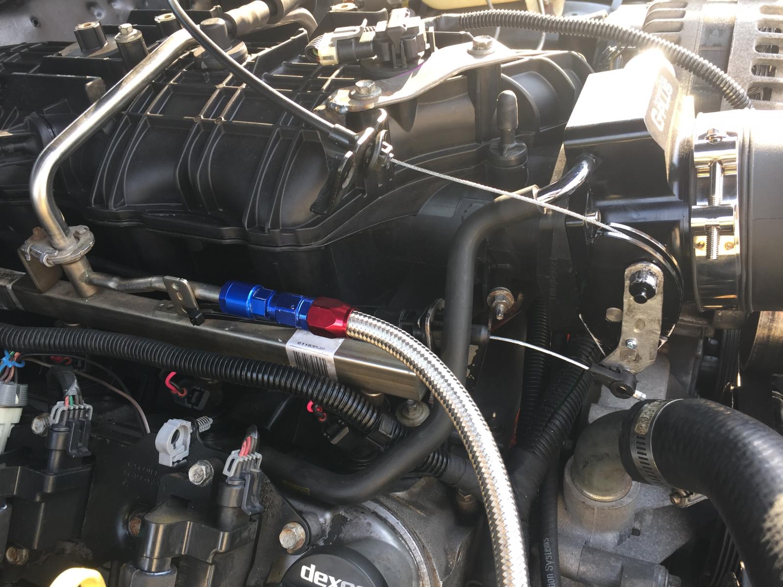

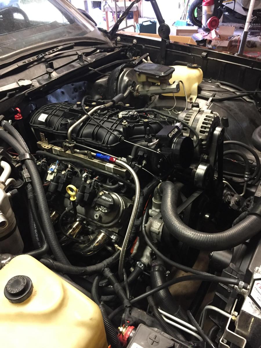

      After the headers were installed I hooked up my mechanical oil pressure gauge, sending unit and installed the intake

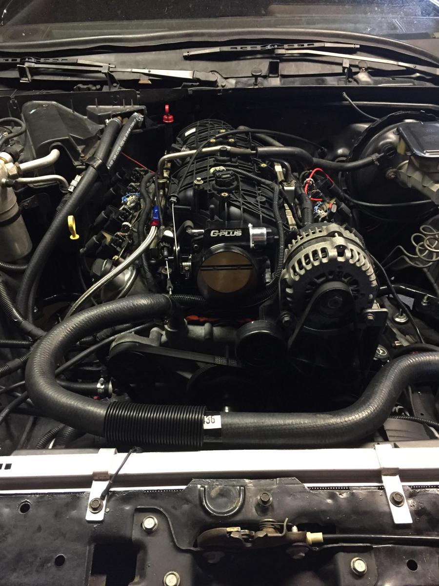

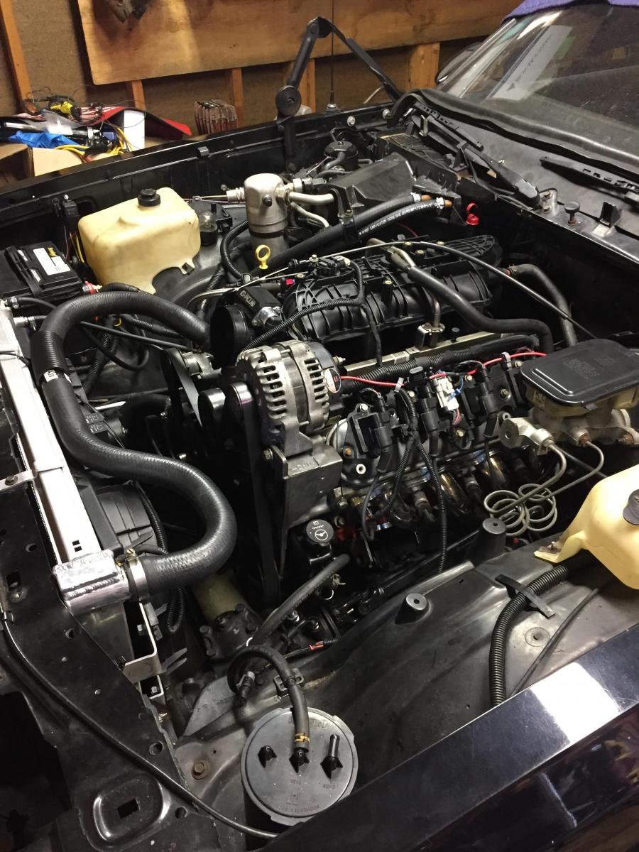

      From here it was just wiring
      I had some friends come over to be extra hands to get everything laid out well
      Here's the finished product with the wiring

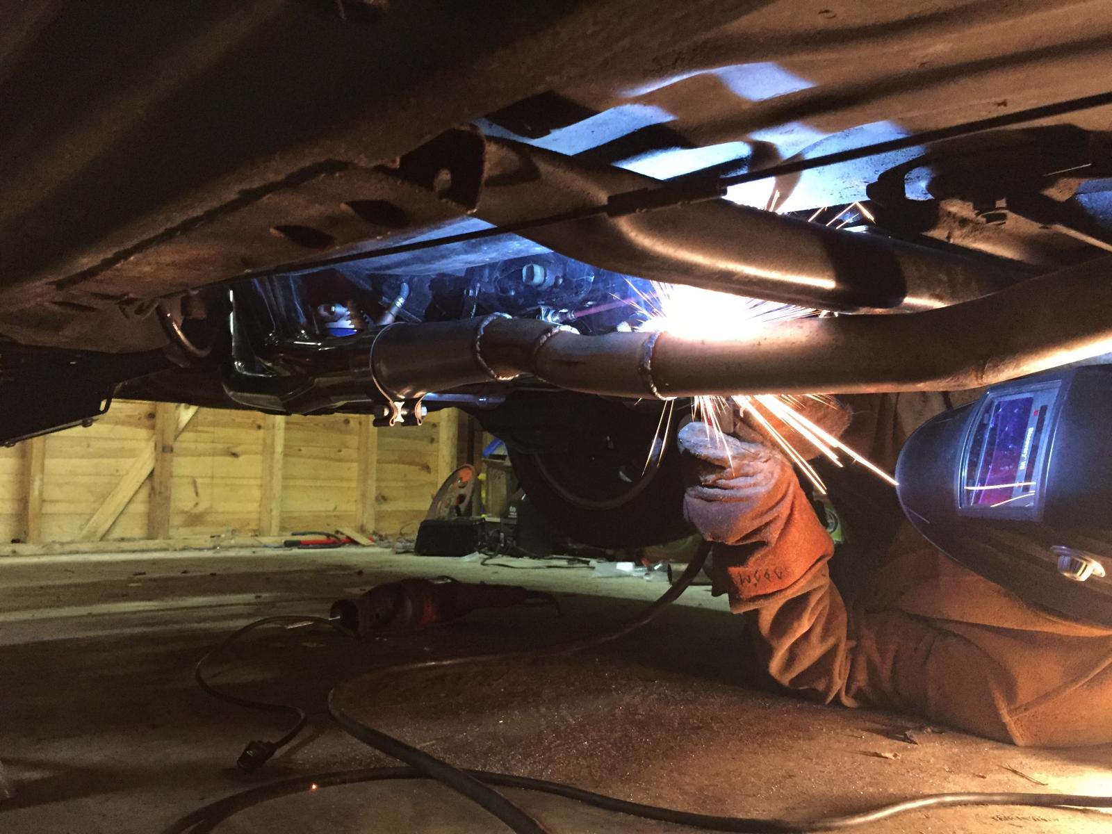

      Then it was time to weld up the janky, entirely too small exhaust previously on the car to my new headers with some slip fit reducers because I ran out of money. I'll bet there's 20 hp hiding in this exhaust.

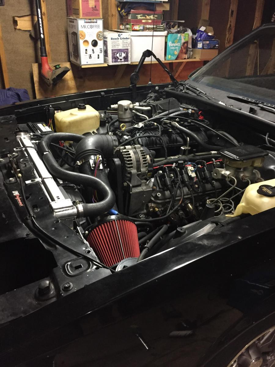

      Then the only thing left was to install the intake tube and MAF (not currently using MAF with Microsquirt, but may down the road)

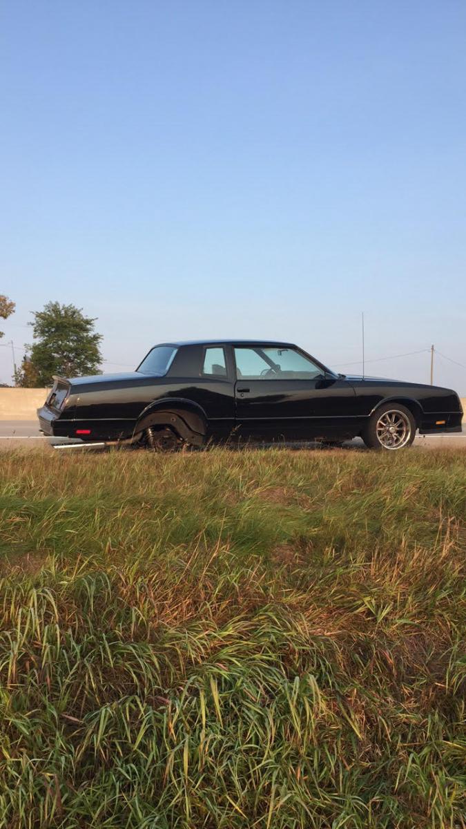

      That didn't go as planned.
      A few Sundays ago I got up early to go an Autocross about 1.5 hours from my house. I loaded up the Monte and got on the road. About an hour in of mostly just cruising up the highway, no screwing around I felt a shimmy in the rear of the car, my tach and speedometer started to climb at the same time. I looked behind me expecting to see a trail of transmission fluid... Instead I saw sparks, and my passenger rear wheel and axle slowly passing me. I pulled off the road to safety. Thankfully traffic was very light and the runaway wheel and axle didn’t contact any other cars. A bad situation went as good as it could have.
      After a call to AAA, they had a flat bed on its way. I was able to run down the Axle and wheel, so that we could push it back into the housing, and get it on the flatbed. I had the car towed to my folks house because it was closer and they have a bit more room to work on it.
      Got the car up in the air and worked on dropping the rear axle.
      Now it was time to crack into the diff and find out why my car turned into a goddamned tripod while doing 70 mph.
      So much metal in the oil. It looked like liquid anti-seize.
      The ring and Pinion were surprisingly intact, but the spider gears were incredibly chowdered.
      The spring plate for the clutch was also broken
      There's the C-clip that let go.
      The car sat like this while I waited on my rear end to be rebuilt with some better parts: a Torsen diff, 28 spline Moser Axles, a Proform Rear Diff Cover Girdle and a new 3.73 ring and pinion gear.
      In doing some research, an Auburn Posi unit, if the unit wears to an extreme extent, the wear of the clutches allows the side gears to move, and lets the c-clip escape. So, if any of you are running around with 30-40 year old auburn Posi units, you may want to pop the cover and take a look at your posi unit.
      I’m just lucky that A: I wasn’t hurt, B: No one else got hurt, C: Short of this poor shock mount which was forced to be a skid plate and the axle failing, there is not any damage to the car.
      Got the Diff back and installed
      Anyone else hate putting on drum brakes? I have a set of F-body discs, but just need to get the car back together.
      Too bad my Moser axles didnt come with the Moser stickers...
      Anyways, the car is back together now, the 7.5in ten bolt is about as strong as I can make and I have a torsen diff in there now. I have an autox this weekend, I'll get some video and some updates.

      Did a little racing
Size:  179.5 KBName:  IMG_0474-1.jpg
Size:  198.3 KBName:  IMG_0475-1.jpg
Size:  151.8 KBName:  IMG_0479-1.jpg
Size:  198.8 KBName:  IMG_0566-1.jpg
Size:  116.5 KBName:  IMG_0567-1.jpg
Size:  120.1 KBName:  IMG_0687-1.jpg
Size:  286.1 KBName:  IMG_0688-1.jpg
Size:  258.3 KBName:  IMG_0689-1.jpg
      Sep 2017
      Detroit, MI
      101
      Just an update from late last year. Forgot to post, but I took the car to the local dragstrip and ran 13.27 @ 107 mph. This was before the diff-splosion. So I'm looking to see what the torsen diff will do off the line in the spring.
