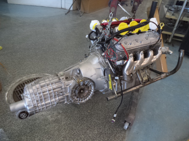

      Flanagan IL.
      303
      Stacked Polish work all done and installed. with the Holley EFI system. its NOT a Jenvey system its a system we are working on trying to make a Package system for an LS setup
      using the Holley EFI. if this works out we will have natural and Polished system avail. still in the works.
      this LS3 with Cam swap and ported heads dynoed 534 hp and 543 tq. Not to shabby...

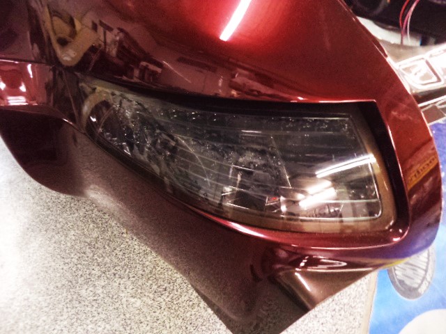

      Tail lights all installed also...

      Quote Originally Posted by customshop View Post
