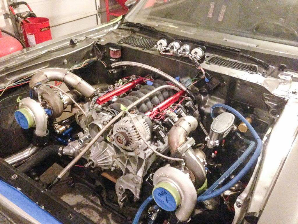

      The original build thread can be found at http://www.nastyz28.com/forum/showthread.php?t=243415 . A few months ago I took out the big block and begin putting together a Twin Turbo LQ4.
      Engine: 01' LQ4 block 4.030, Compstar crank, I - beam rods, wiseco -20cc pistons, ported 317 heads with ss valves and PRC .650 springs, LS6 intake, cam is 232/238 .612/.615 116+2, arp fasteners on everything, and some other fun go-fast stuff.
      Turbos: Twin 67mm Precision 6776 ball bearing, .81 ar.
      Fuel: a1000 pump, aeromotive pump controller, -10 feed, -8 return, a1000 bypass regulator.
      Boost control: E-boost 2 with dial solenoids, Precision 46mm gates, Dual tial BOV's.
      Electronic controls: Lingenfelter 2-step and line lock wired to momentary switch on shifter. 0411 pcm. ZR1 3 bar map. Speed density tune.

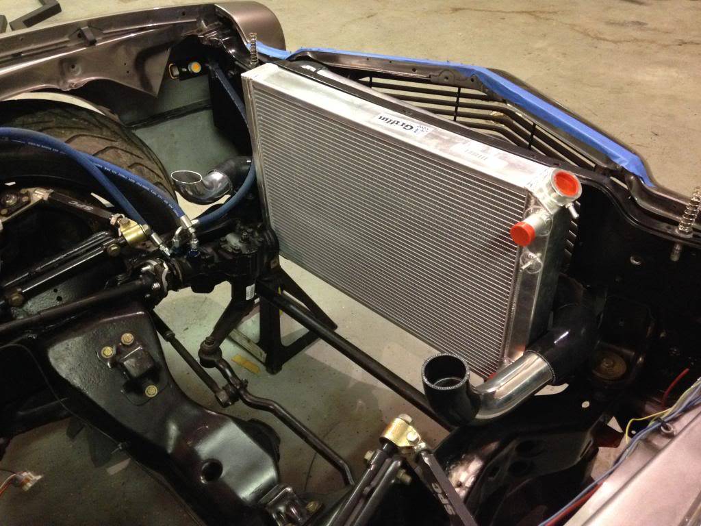

      What radiator are you running? Great looking car!
      Stephen
      Jun 2010
      60
      Quote Originally Posted by srh3trinity View Post
      Griffin "direct fit" 29.5" x 18"ish x 3"
