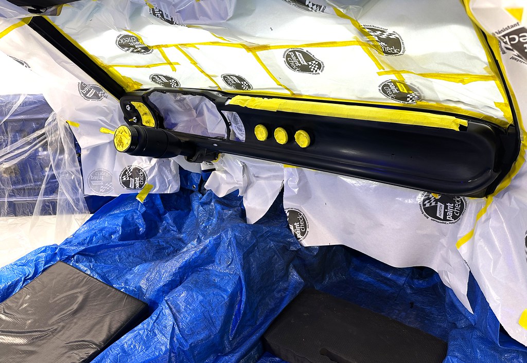

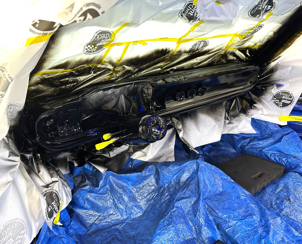

      Winter '26 projects are primarily on the inside of the Maverick. Correcting things that have bugged me since day 1 with this car. Mismatched colors and finishes make me insane. First up is to go from the gloss black on the dash to satin black. Absolutely no fun painting a dash in the car but it is the lesser of the evils considering how the dash comes out.
      Once again with the interior out of this car.
      Came out pretty wll considering it's just satin Trim Black ultra spray bomb.

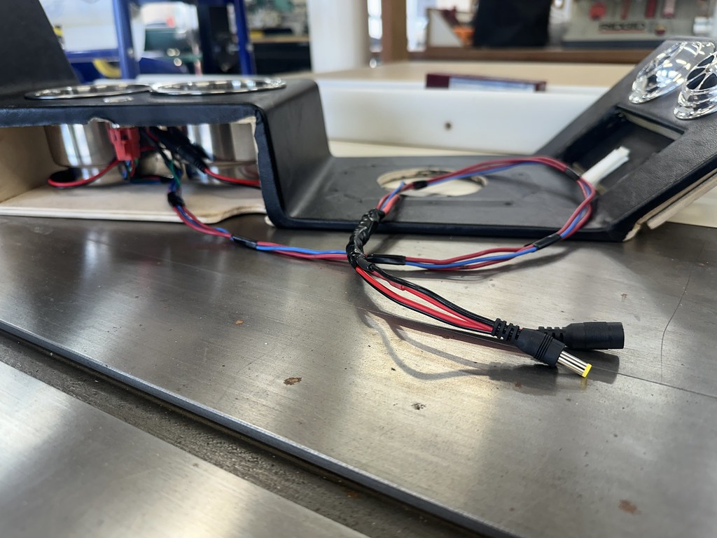

      Bunch of other fixes while I'm this far starting with the wiring under the dash. Really nice that the car had a Kwik Wire 14 spot ATO fuse box and complete new harness but the install that was done previous to me getting the car is sloppy. Spent hours up side down under the dash trying to make sense of it and I have the zip tie tails to prove it. lol...
      I also remade the harness in the console to simplify getting it in and out of the car. That's on me from last year's winter projects. Lesson learned.

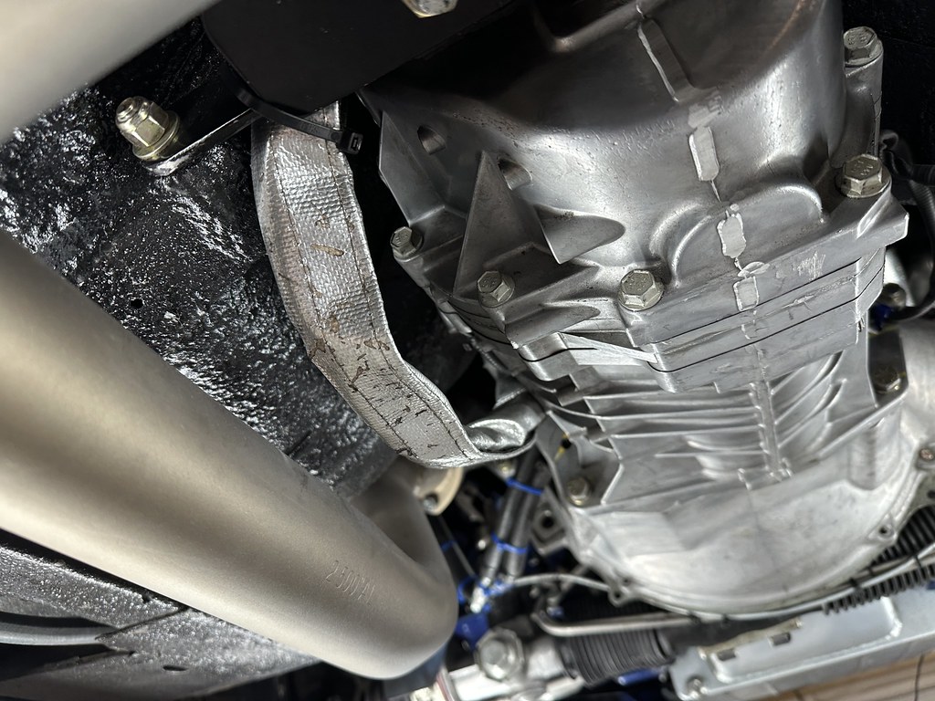

      New speedo cable ran up and out the top of the tunnel to get it inside the car to get away from the header that melted previous cables. Even when the cable was heat wrapped. Wrapped the new one just in case but hopefully this solves the issue.

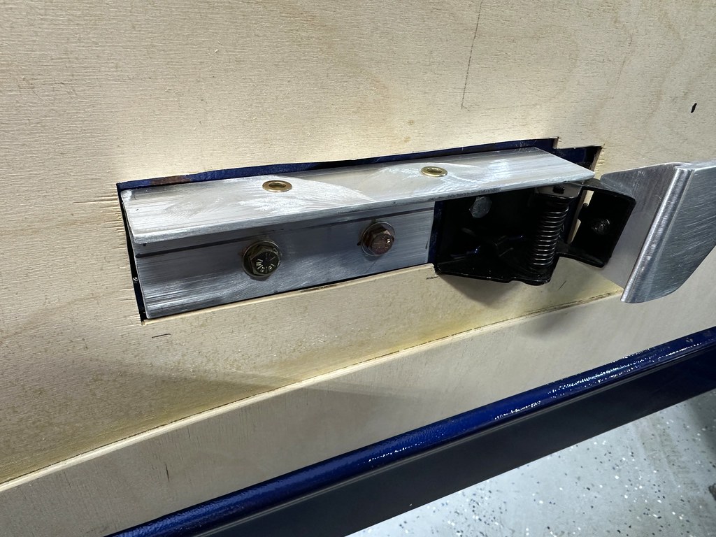

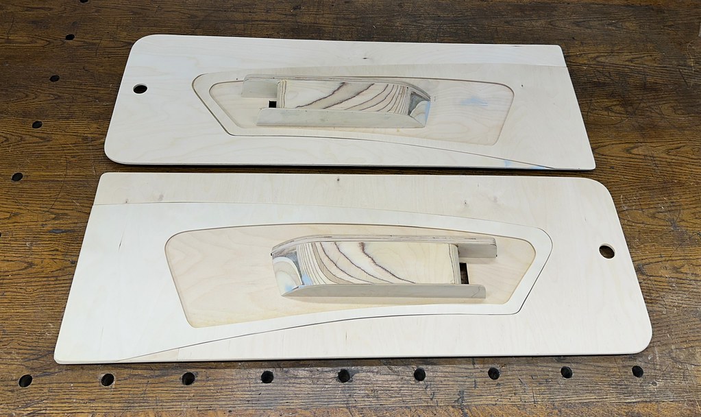

      Moving on to making the custom door panels before I paint the inside of the doors satin black to match the dash. I found a pic that I liked for inspiration so on to cutting th 1/8" Baltic Birch plywood layers. Sort of like making your own jig saw puzzle pieces. Lots of band sawing, jig sawing and sanding. So far I'm liking it.
      The inspiration. We'll have a much simplier arm rest but you get the idea.

      I'm sure at some point in the future I'll look back and say that I enjoyed building these door panels but for now I'm just happy that my part is finally done.
