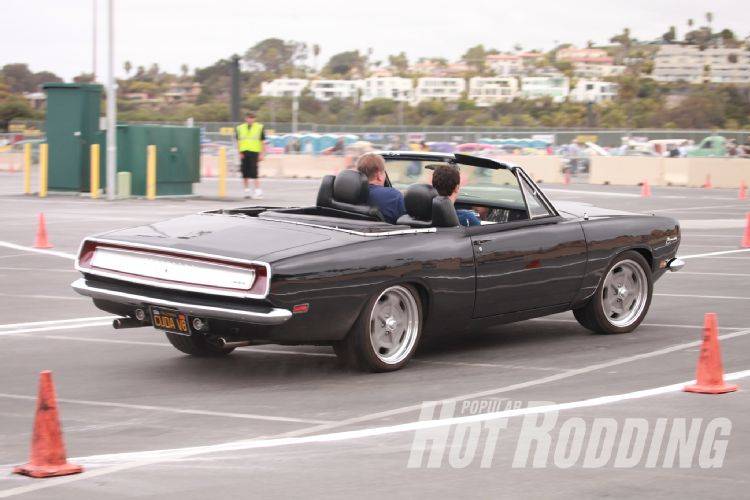

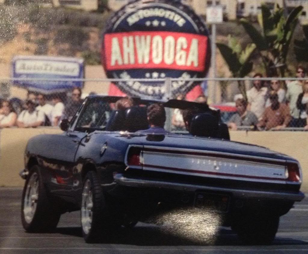

      Matt, your suspension sounds like its working to eliminate too much roll, which is backwards. You want to ENCOURAGE roll, I included pics to show how it SHOULD look:
      See how the front wheels appear to be pointed AWAY from the Apex, thats a great sign things are going well.
      In this one we see the benefits of a 230(+) pound "driver"... Im getting the most grip possible from the outside edge of the left side tires.

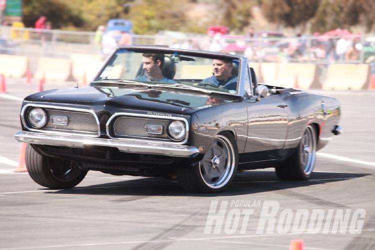

      No comment needed, however, note the front left wheel / rear bumper angle. Almost perfect!
