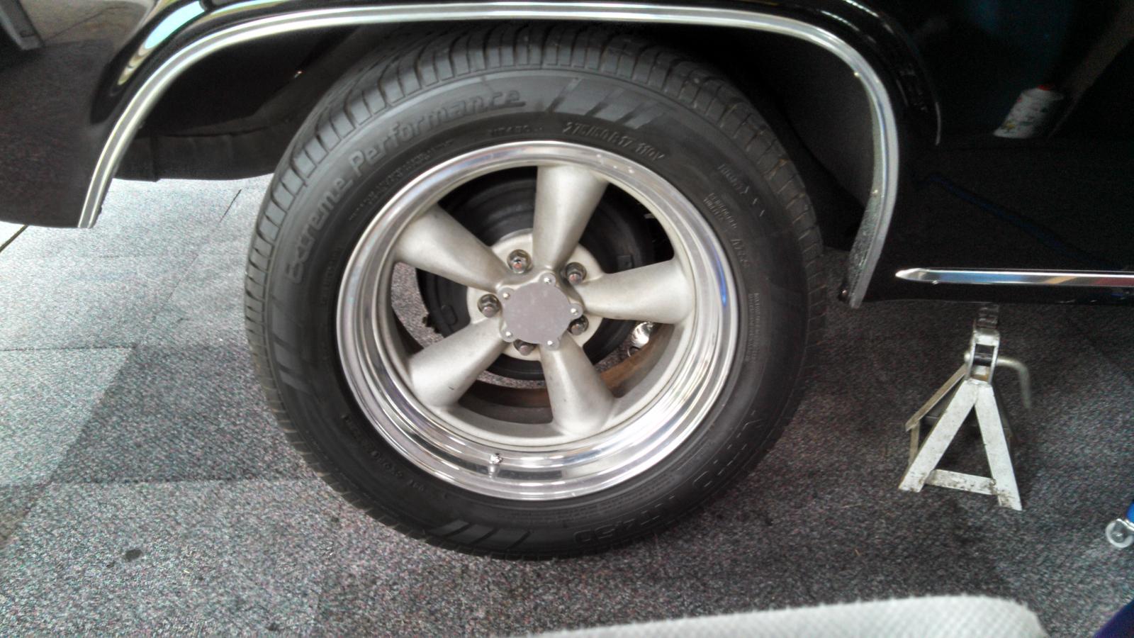

      Looking closer at things this morning, I see that my passenger side wheel is pushed forward and not centered any more. With no broken parts, I'm not sure what to do for the temp fix, NOR the permanent fix.

      I may have just figured this out for both instances of when this issue has happened.
      I think the axle tube is rotating as compared to the differential. That makes sense, right? I mean, it's a stock 10-bolt, people usually weld the tubes to the diff., it happened both times after clutch-popping little burnouts. 275 series tires, 4100lb, 46 yr old car with a 383 crate motor and Muncie.
      The Drivers side LCA bracket is angled 15 degrees to the front of the car,.....the Passenger side bracket is angled 9 degrees in the opposite direction!!! (to the rear) Pretty sweet, right?
      I think I just found the next Weakest Link. I think this also means there's no easy fix this time to get me on the road again. :(
      Sound plausible? Could I leverage this back in place and then weld the tubes? That sounds tricky, not sure how I'd move the axle tube.
