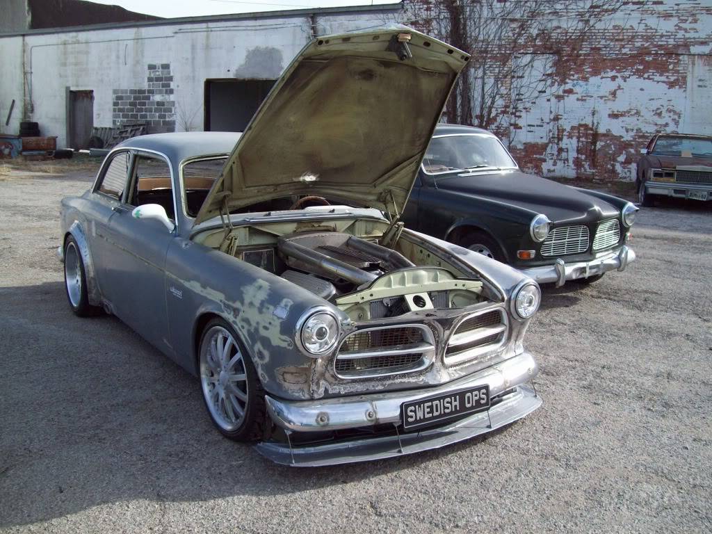

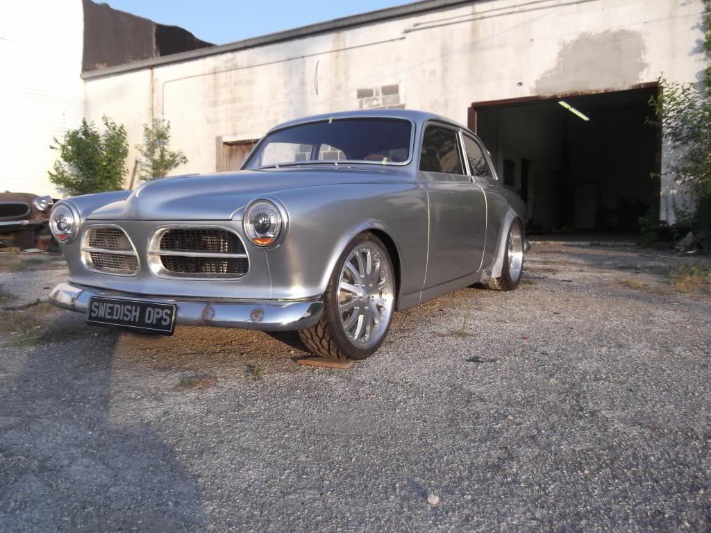

      I had these HID Projectors made, and there are company's out there that will hand build them to your spec, so I added the Turn Signal/Park light at the bottom, along with the LED Halo around the outer perimeter.. I had two versions made, one with the park/turn lamp, and LED Halo around the outer perimeter. And without the turn/park lamp, and with the LED Halo around the HID Projector shroud. A quality hand build light, with all the ballast and wiring, will run 800-1000 dollars..
