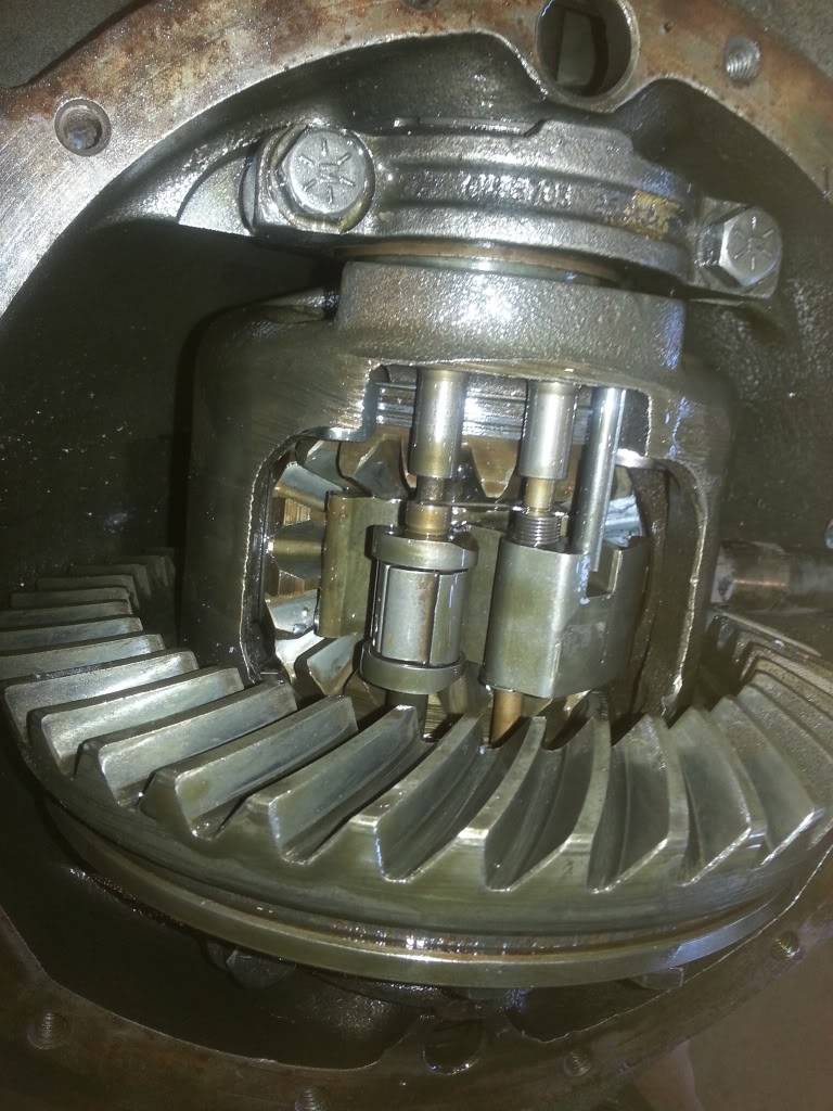

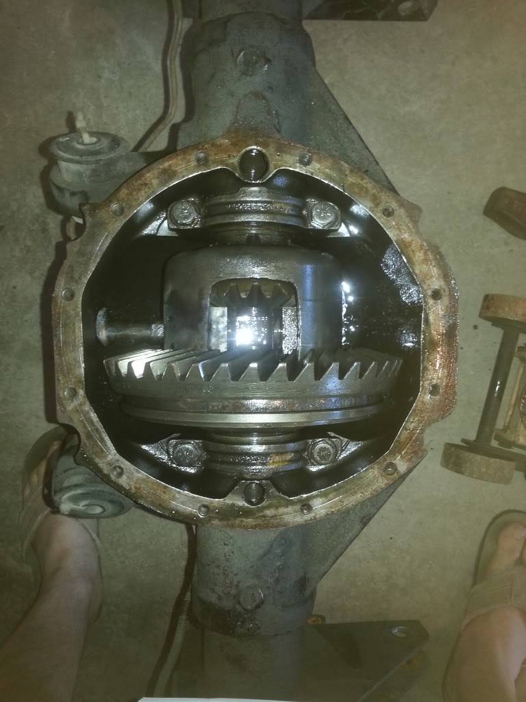

      About a month ago, while cruising in my 67 Camaro my rear end started to make a growling noise, once I got home I Jacked up the rear and noticed there was a dent in the diff cover as if something tried to get out. Not Good, Upon taking the cover off I noticed a bolt in the bottom of the rear end, then another, then another until I pulled ten bolts out of the bottom of the rear end.
      At this point I realized I dont really know anything about rear ends, so for a solid week I read and watched everything I could get my hands on. Once i was a little more confident I began dis-assembly of the rear end. Wasn't and easy task, the small bolt that holds the Pin in sheared and It was a matter of beating and cutting the pin til i could get it out. Only then I realized that the rear end was equipped with C-Clip Eliminators, so the pin removal did nothing for me.
      Heres a pic of the Old Carrier
      Once i removed the axles I was able remove the caps and pull out the carrier, turns out its a 12 bolt car gov-lock carrier. upon research there also called time bombs lol. lucky for me i had a chevelle rear end laying around and pulled the Eaton style posi out of it, bought some 3.55 gears to replace the 4.11's . and this begins this build. starting with an empty rear end and some parts laying around everywhere.
