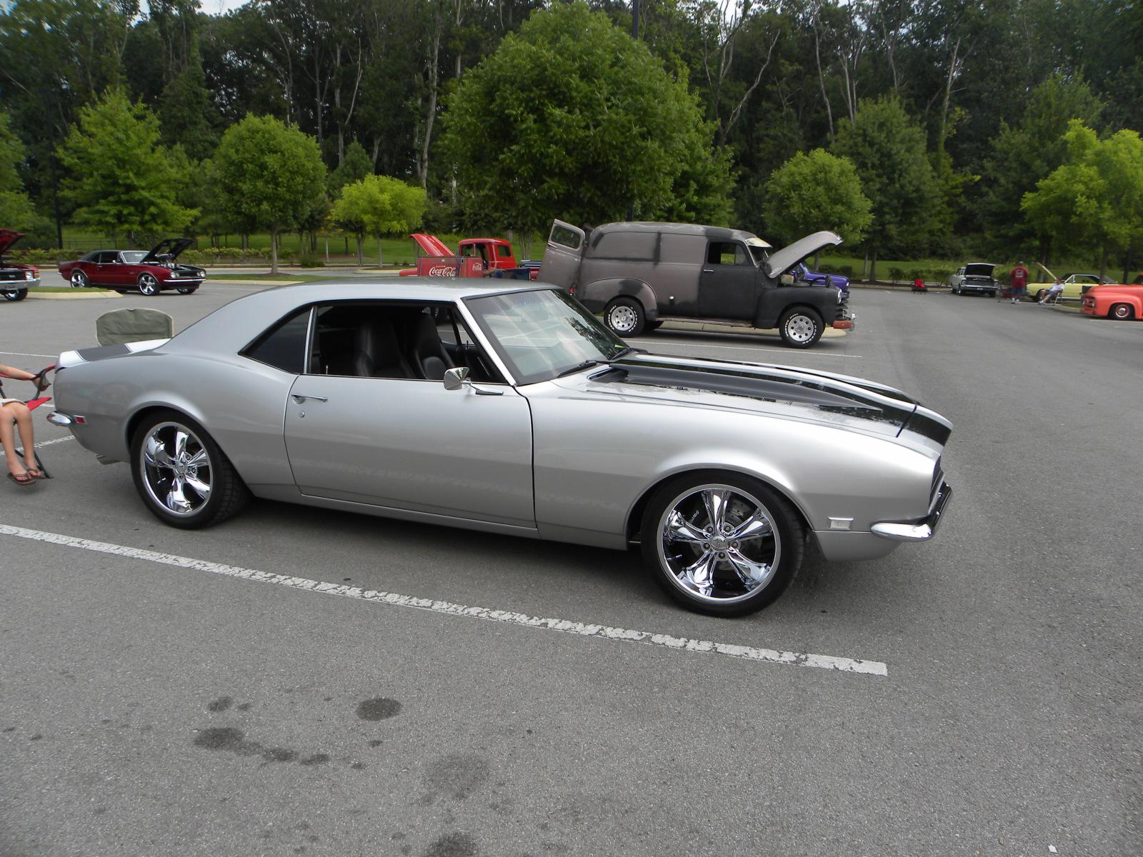

      See if these pics come through....

      Finished pic looks great! Any more photos? Also on an unrelated note, do you have a source for the AC outlets that you used in the middle? Thanks, Scott
