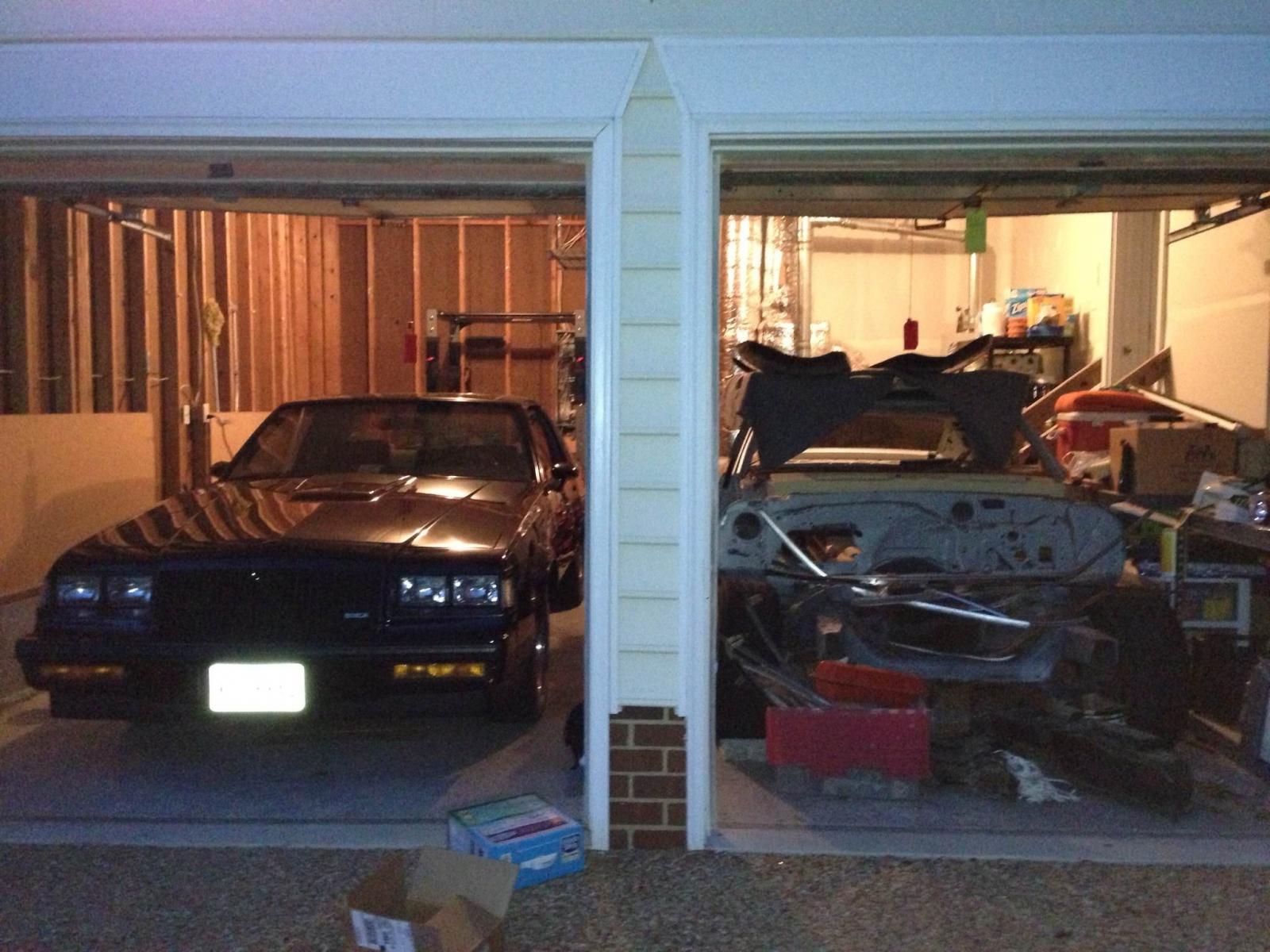

      Hey, guys! Well, I've been looking for the right first gen for years now. I lucked upon one in Craigslist a few years ago and finally pulled the trigger on it. It is a completely bare roller. The guy I bought it from bought it when it was running and driving then stripped it down in anticipation of restoring it. So, it is bare; the chassis was sandblasted and primed.
      It came with a 350 from 1967, a Muncie 4 speed, and a 12 bolt rear. I'm selling the motor, trans and rear. Why? I'm going with a Speedtech front subframe and a Speedtech torque arm rear setup with a shortened complete 9 inch rear. Also, I plan to swap in a LSx motor with a t-56.
      Only pictures I have right now are from the trip to pick it up. I'll snap some better ones tomorrow when I'm pulling the rear.

      The Grand National isn't mine. I'm storing it for a friend. It is for sale, however. Only 54,000 original miles!

      By storing the Grand National do you mean "Occasionally blaze the tires to make sure it still runs?"
      thats all the payment for storage I would need.

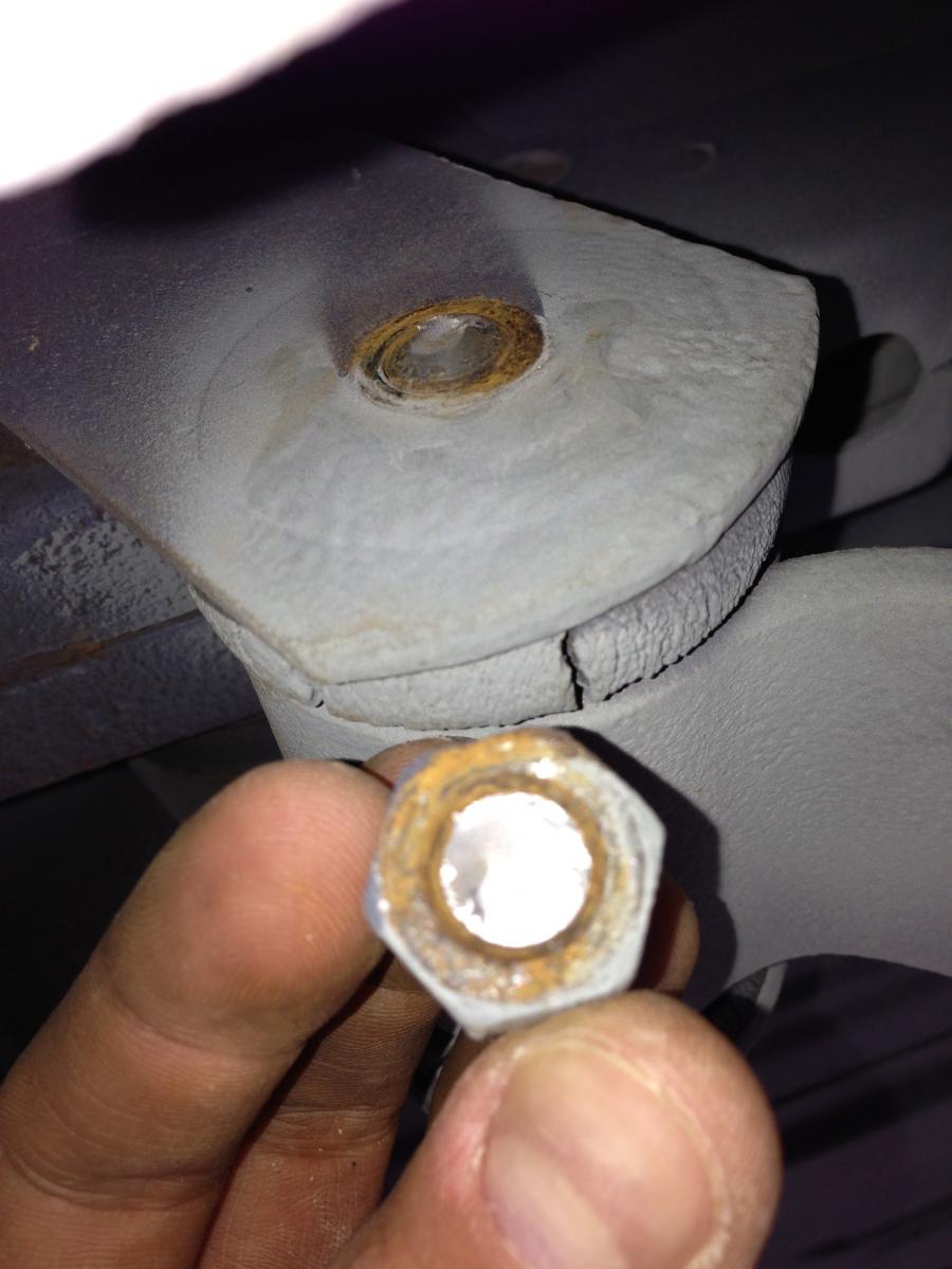

      Removed the 12 bolt.
      Tackled removing the 12 bolt today. It rained off and on today and I have the other car in the garage so it was a bit of a maneuvering fiasco. Had to get some help from my brother and a friend to turn it around and get it back in the garage.
      Had a bolt break off that held up the leaf spring on the passenger side.
      So, got to buy another tool - a sawzall! Finally, everything is unbolted and ready to sell! SpeedTech Performance setup with Currie 9" housing, here I come!

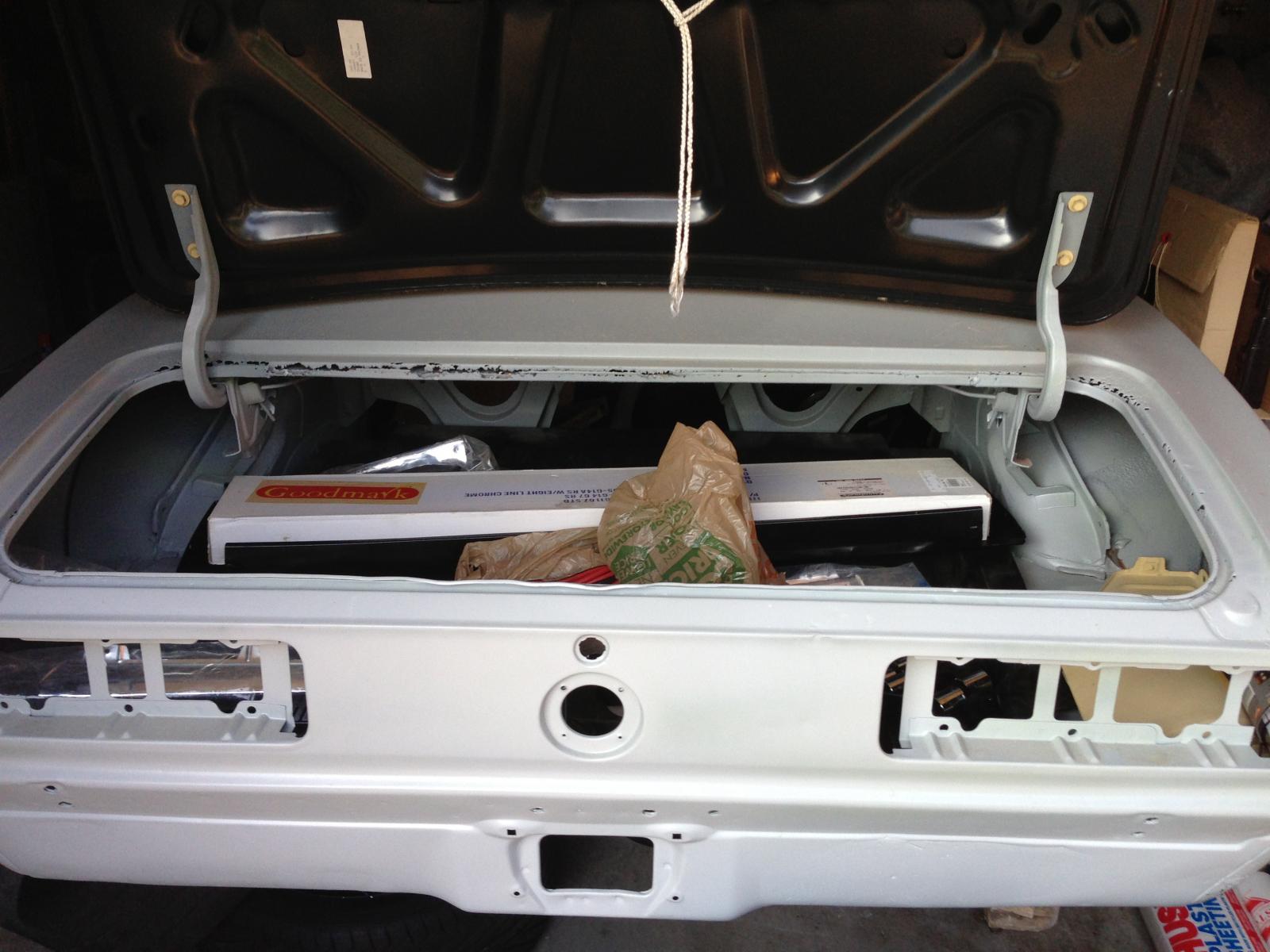

      Anyone know how to replace/fix the rust around the rear windshield opening and the area where the seal for the trunk is?Name:  IMG_2103.jpg

      Looks like you have a fairly clean shell there. As for repairing the rust around the trunk gutter, you can get new replacement channel from jegs or other sources . It sounds complicated but easy to do. On the back window, depending how bad the rust is, you can make patch panels and weld it in. I made a couple of patch panels on my firebird, and for smaller rust holes I just welded them shut.

      Looks like I found the part at Year One. https://www.yearone.com/Product/1967-81-camaro/rw49 Should do the trick!

      Thanks on the congratulatory remarks and on the info about the rust repair! I found the replacement trunk channel from a couple different places and also found a kit that replaces the rusted spots around the window too. So, looks like I'm good to go. Just took a bit of searching around to find.

      When you fix the rust around the rear window make sure to have the trim handy. Before welding anything in place, line the trim up and make sure it still fits correctly. Some of the window channel up in the top corners had a horrible fit from the factory. Mine were way off, but I had a vinyl top on my car. Then to top it off I did some welding myself and did not think to check it out with the trim before welding it up solid.
      May 2013
      23
      Thanks for the tip! I'm not sure if I will be doing the bodywork or my friend (who actually does this for a living). I'd love to but honestly I'm terrified. Haha. I want to use the flush glass without the trim. Would that change the approach?

      It would make it easier.
