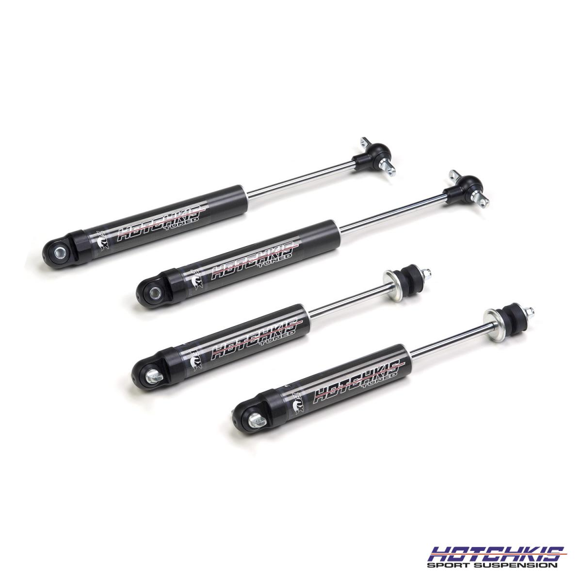

      Have you had the opportunity to check out our new aluminum monotoube shocks? We have worked very closely with Fox Racing Shocks to develop and tune a damping solution that is tuned for the unique needs of classic muscle cars and is matched perfectly to our suspension systems. Since you are talking about eventually building your suspension system into a TVS kit, these really would be the perfect fit for you. But even though they are designed to complement an upgraded suspension, they still work great with your factory components and will provide a firm but comfortable ride. Check out more info here: http://www.hotchkis.net/19701981-cam...ck-4-pack.html. At the Goodguys Autocross in Del Mar last month we actually had one of our H-Team members running 2 seconds quicker on Saturday then he did Friday after we installed a set of these shocks on Friday night.

      The shock length will only change if you lower or raise the ride height of the car. If you're just changing the wheels, you won't see a whole lot of difference in the ride height, so you don't have to worry about back-tracking if you buy new shocks now.

      You can run any new, quality shock with either 15" or 17" wheels - might need some slight adjustment (if they are adjustable). Go for something adjustable - like Koni Yellows, Bilstein, QA1, or even the Hotchkis ones shown above. I have Bilsteins on my Camaro and Koni Yellows on my GTa and love both...
